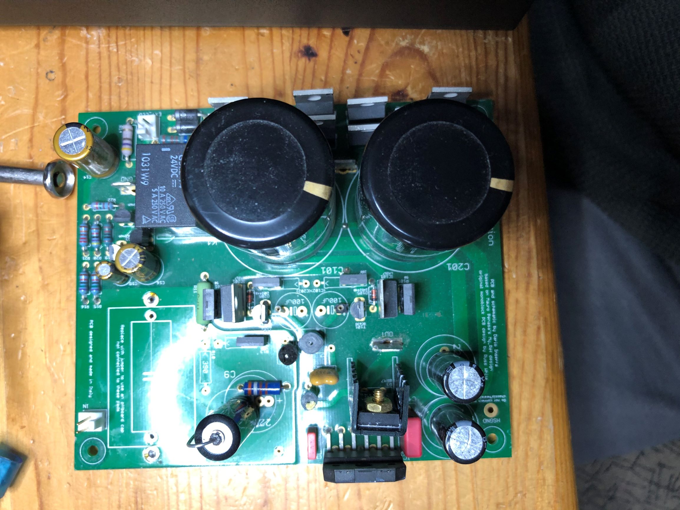

Jac, but in this case the feedback net terminated directly to ground, not to the 1 Ohm resistor (R 11). By this way the input net and the feedback net won't see the same potential. Is that correct? In all the Dario schematics the feedback net terminates on R 11, not directly to ground (I admit, I'm a little bit confused about it).
Probably I'll go populating the C9 indicated place, it's quite a pity, the unmarked place should have been perfect to try some bypass small capacitor in parallel with the big electrolytic one...
Massimo,
You got me curious, so I pulled out my old v1.0 boards. The picture shows my board built in the "resistor first" and using older BOM components. Sorry for the poor lighting.
A bit of explanation on grounds. Audio ground is the ground plane on the top of the pcb. This is the ground that C9 connects directly to in the "resistor first" configuration. The Audio ground is still isolated from the Power ground by R11, 1 Ohm. Power ground is the ground plane on the bottom of the pcb. So, "resistor first" and "capacitor first" are the same, both isolated by R11.
As for bypass caps, there was a later version that had a place for bypass caps, but at this early date, Blackgate caps were easily available and don't really need a bypass cap. If you want to try a small bypass cap, you might be able to solder it to the C9 terminals on the bottom of the board.

googling because 100uF c102 and c202 wasn't in the BOM (and I didn't purchase them... :-() I've found another thread of a audio friend (Rom vise) who used a board exact like mine one, he mounted the RC net exactly as you indicated, Jac, now the confusion is total... wich kind of solution I have to apply? He leaved unpopulated c102 and c202, is it correct?
Let's start with C102 and C202. Leave them unpopulated. The positions were added to allow for extra stability of the regulated power supply (LM318), but we have never needed them.
It is completely OK to continue on the "capacitor first" solution. If I remember correctly, all of Mauro's boards and Dario's 1st prototype and Release Candidate boards were all "capacitor first". The amp will work correctly and sound just fine.
You have both options on the v1.0 board because "resistor first" was being experimented with and no one choice had been made. The consensus, after experimenting, was that the "resistor first" sounds a bit better. If you removed R10 and changed to "resistor first", you would be the same as later builds, but it is not necessary. Later versions only have the "resistor first" on the pcb.
For an idea of the difference between the two, please read posts 1362 -1366, page 137 of the My_Ref Fremen Edition - Beta Build/Fine Tuning thread. Of course, the BOM has changed quite a bit, so the difference may not be the same for your build.

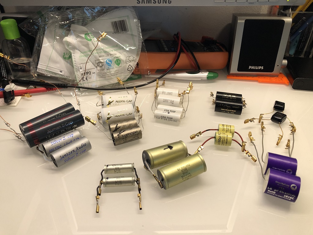

I'm re-evaluating input caps including some new additions:
001-7022 - 1uF 100Vdc Jantzen Alumen Z-Cap | Hifi Collective
AMCG-060 - 1uF 250Vdc Amtrans AMCG capacitor | Hifi Collective
AXO-030: 1uF 200V Auricap XO Capacitors | Hifi Collective
CSA6-070: 1uF 630Vdc Claritycap CSA Range Polypropylene* | Hifi Collective
1501180: 1uF 160Vdc Audyn Cap KP SN Capacitor | Hifi Collective
For sure http://www.humblehomemadehifi.com/Cap.html is not a reliable source for information for coupling caps (and BTW is not supposed to be...).
Apart last two, all the other caps have been a disappointment, Audyn KP-Sn and Caritycap CSA seems both promising but I'm still evaluating.
So far the only certainty is that the Mundorf Supreme will no longer be one of the suggested caps.
