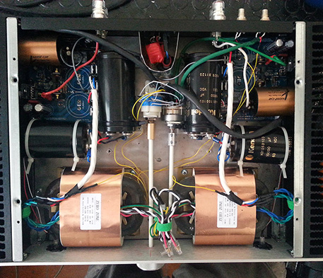

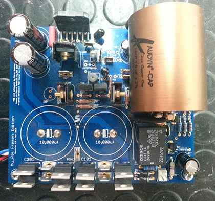

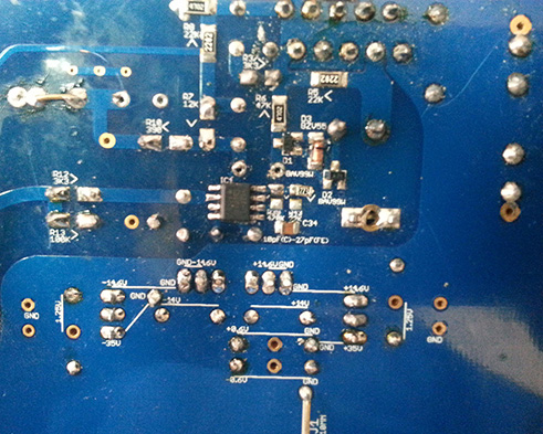

Here some pics of my build, i hope they can help!
attachment.php
attachment.php
attachment.php
At present i have no cap below 100pF, so a while will be needed before i can try the suggested 3,3pF cap mod...

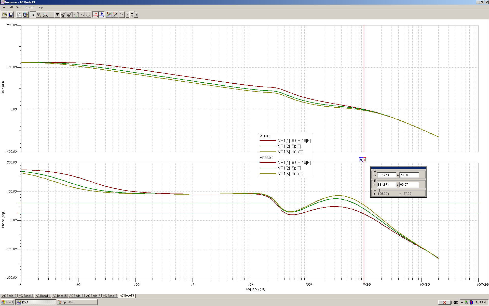

Jac, it's not the closed loop gain at wich we have to look at the GBW..
The opamp is seeing the comp cap applied to it's open-loop gain, inside the composite loop.
For illustrating the effect of this compensation cap, I have done a scan of the loop gain changing as this compensation cap is changed. What is shifting more importantly is the phase margin of the composit loop.
The scan had been done as illustration, with the OPA627 in the loop, +the LM3886 current pump. The load is 8ohm+4nF.
The 627 is similar in many ways to the 4627; the effect, the direction of change is the same in all cases.
Watch the phase margin values in a, b points, the Y value is the phase margin at 0dB loop gain cross level.
Ciao, George

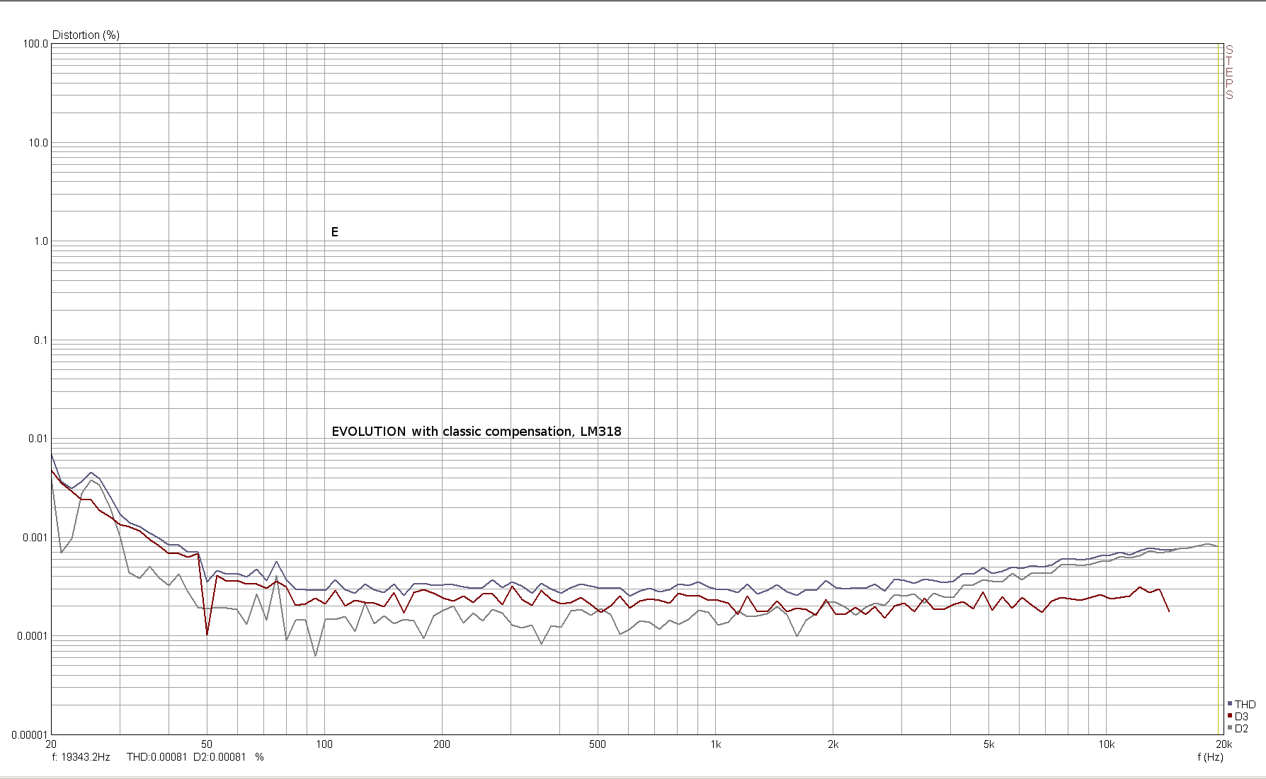

Here it is the classic EVO (~ with standard FE compensation)
Note the distortion floor; it's higher level reflects the lower loop gain as a result of this compensation (470k on LM318)
THe low frequency rise is the consequence of the DC-servo loop entering into action; (principally it's valid only for the EVO amp)
The relatively flat, only slowly rising thd with rising frequency is the nice result of the rev-C like compensation scheme.

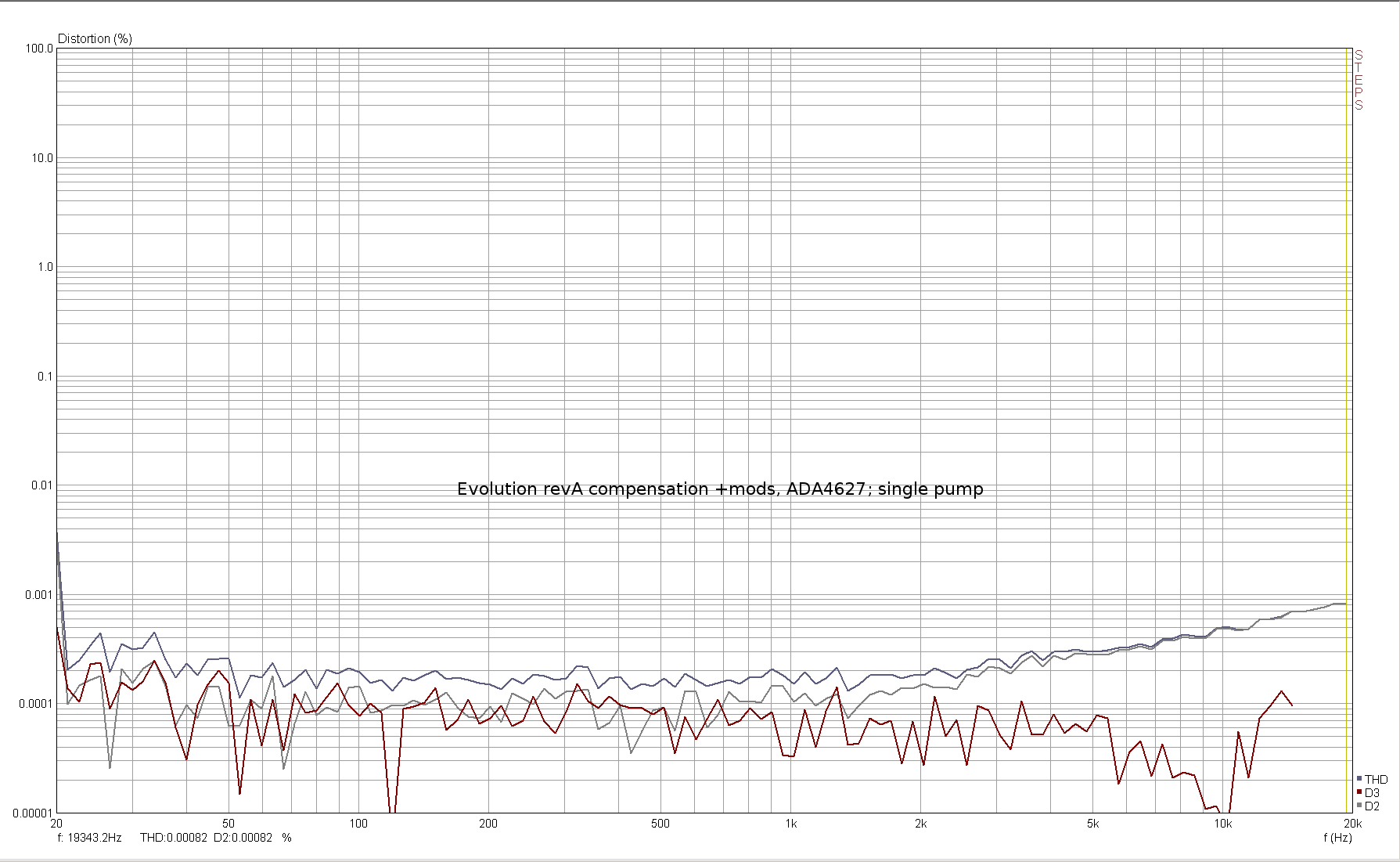

This next graph shows a single current pump, "rev-A modified" Evolution amplifier with the ADA4627 in it;
Note the general distortion level decrease; it's not principally due to the opamp change, it's mainly due to the compensation scheme (in case of LM318, the missing 470k had raised the loop gain in the circuit, for the low frequencies)
This amp is already without dc-servo -- the beneficial effect is clear;
Though here I'm cheating, the full story is that already the changes applied to the servo in the rev-A modification had resulted in a nice quality jump; It had been still rising towards low frequencies but much less and much smoother;

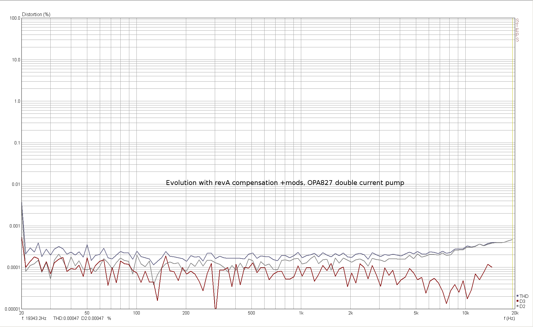

and finally the Evolution amp with double current pump and OPA827:
The contribution of the double current pump is visible in the high frequency region: the higher gm due the double pumps in the output stage is converted in higher loop gain at higher frequencies, and as a consequence better distortion suppression.

Could be low level oscillation - the fix is a small circa 3.3pf cap between pins 2 and 6 of the ADA4627.
I made some test on my ADA4627 My_ref boards.
A 4,7pF cap across pins 2 and 6 lowered the offset a bit (to around 130 mV peak), but didn't solve the problem. Nor did removing C13.
Anyway, offset slowly rises from switch on, reaches a peak level, then slowly goes down. When i say slowly, i mean it takes nearly 10 min to reach the peak, then more than an hour to go down to low levels (about 20 mV).
The only test that managed to bring offset to zero was bypassing R13, but i guess that can't be done if i want the amp to play good... :scratch2:
Dear Luca,
You just got mail with my analysis..🙂
I would repeat here in short, because it might be interesting:
The scope shots provided by Luca did not show oscillations with a level equivalent to the observed offset; instead from the trace one can read a DC offset level equal to the meter-readout of Luca -- ~40mV this time.
This offset disappear when R13 is shorted. This shows that it only develops on the high input resistance (100kohm) of R13.
For me it's pointing towards a DC leakage current present.
This all concludes to two possible variants:
--An ESD discharge damaged the chip that it developed this faulty input current;
But both chips contemporary?!
--During the procedure of placement & soldering the chip some flux residual had been left back, which developes a leakage to the neighburing +Ve supply. This current developes an mV level offset voltage which than gets amplified on the output.
So my suggestion is: a thorough wash procedure for the board.
Looking forward!
Ciao, George
Would like to add: I have corrected, the leakage is towards the +Ve pin, that is from pin 2 to Pin 7, which is just the opposit side.
This points to a leakage path that is right below the chip: The wash procedure should reach there, like forcing with air pressure?
Ciao, George
