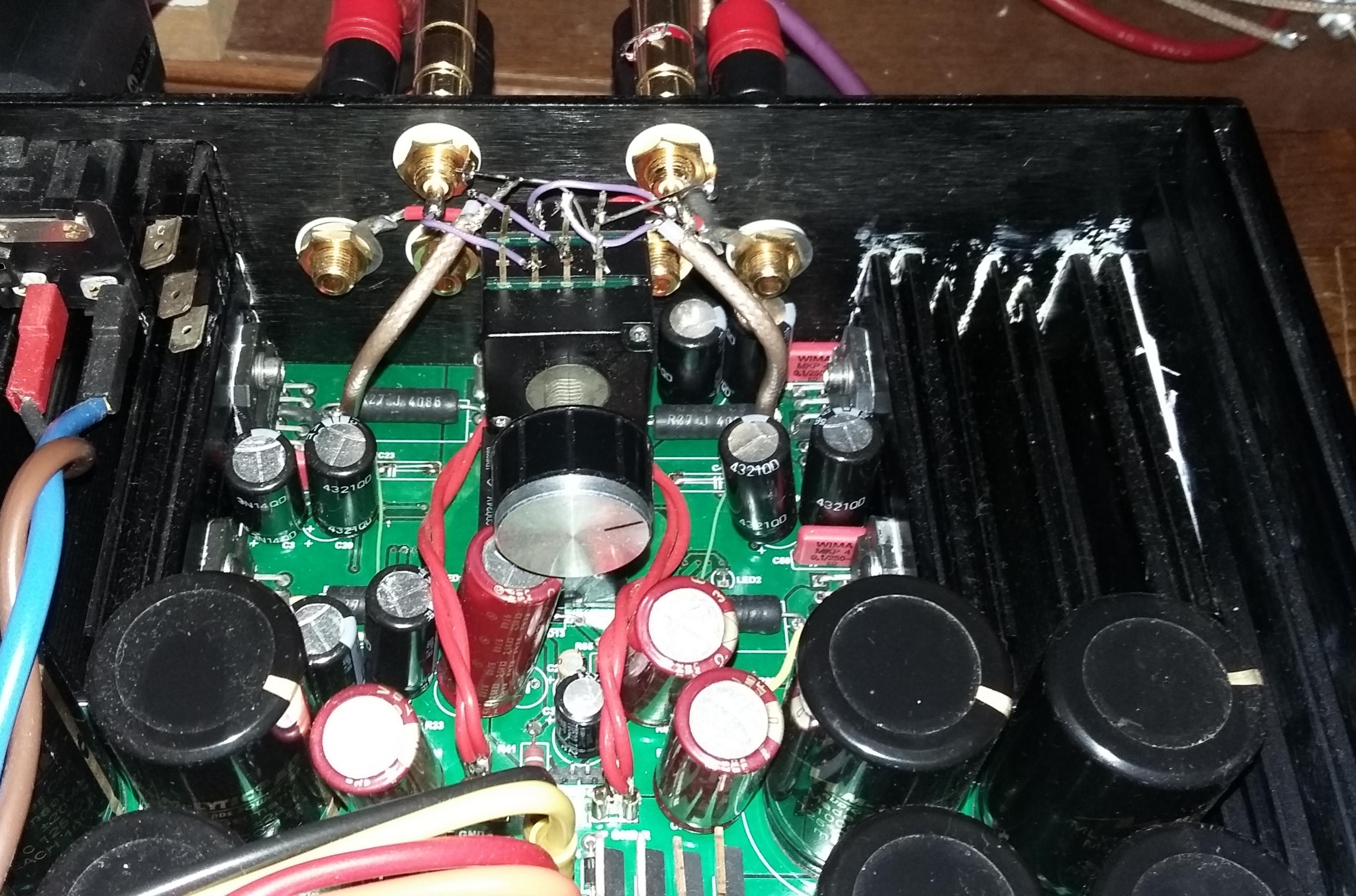

Dan, my pleasure. 🙂
Here it is my temporary (read:ready for the eternity..) application of a pot, right on the input connectors, realized with short leads, small extra capacitive load between amplifier input and pot wiper.
This way I have my complete integrated amp, waiting for the direct connection of a source, like a Dac.
Although because of the relatively high value of potentiometer impedance (47kohm) I can connect peacefully also my tube-buffered PCM63 dac..
But, I would like to underline: personally I feel happy with this solution, for now. But I'm very far from saying this a generally recommendable solution. In fact, trying in different setups, we have heard some very fine sounding preamp, too, like the Conrad Johnson of our great Audiodan..

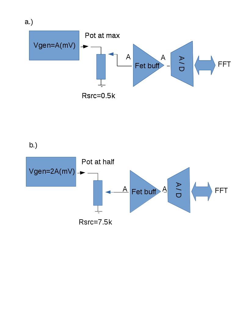

But how good it is, in reality?
So I decided to make a little quick try:
I had prepared two configurations, to be tested in sequence.
See test setup attached.
In case a.) the buffer input -output level is A magnitude, with a low source impedance, because the potentiometer is set to full max extreme. The only impedance present is that of the generator (soundcard)
In case b.) the generator outputs twice the level, 2A. The pot is set to half course, (max output impedance, in our case 7.5kohm for a 30kohm pot)
As visible, the buffer sees the same input level for both cases; but it is presented with a low source impedance (~500ohm) in the case a.)
While the same signal again, but with a moderately high source impedance in case b.) (.5k + 7.5kohm=8kohm)

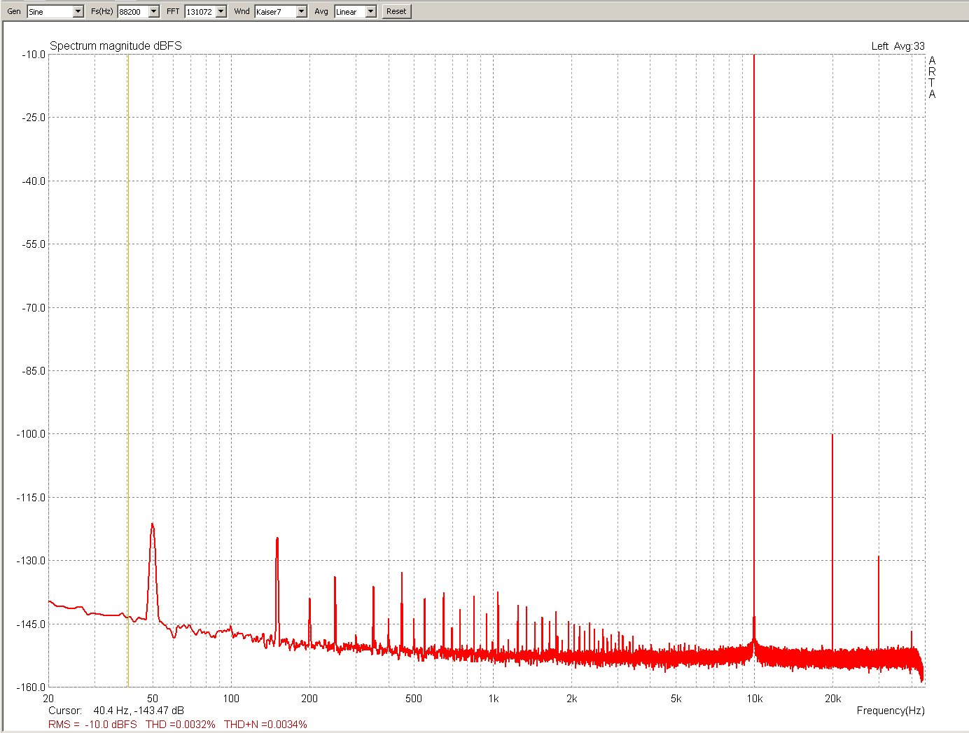

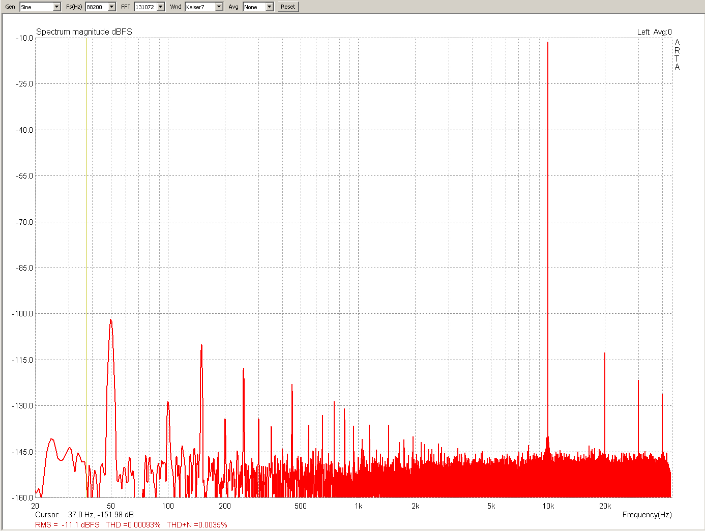

And here there are the observed distortion levels produced by the setup in both cases: (at a ~450mV rms level at 10kHz, for both cases)
First a.) then b.)
One can observe a distortion rise of ~6times, in case of the higher input impedance in front of the DCB1.

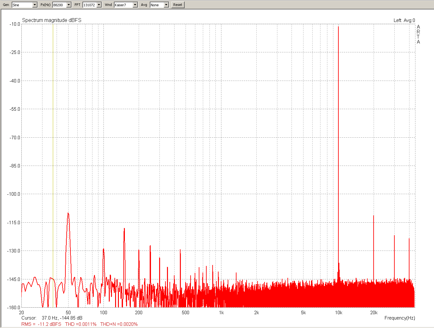

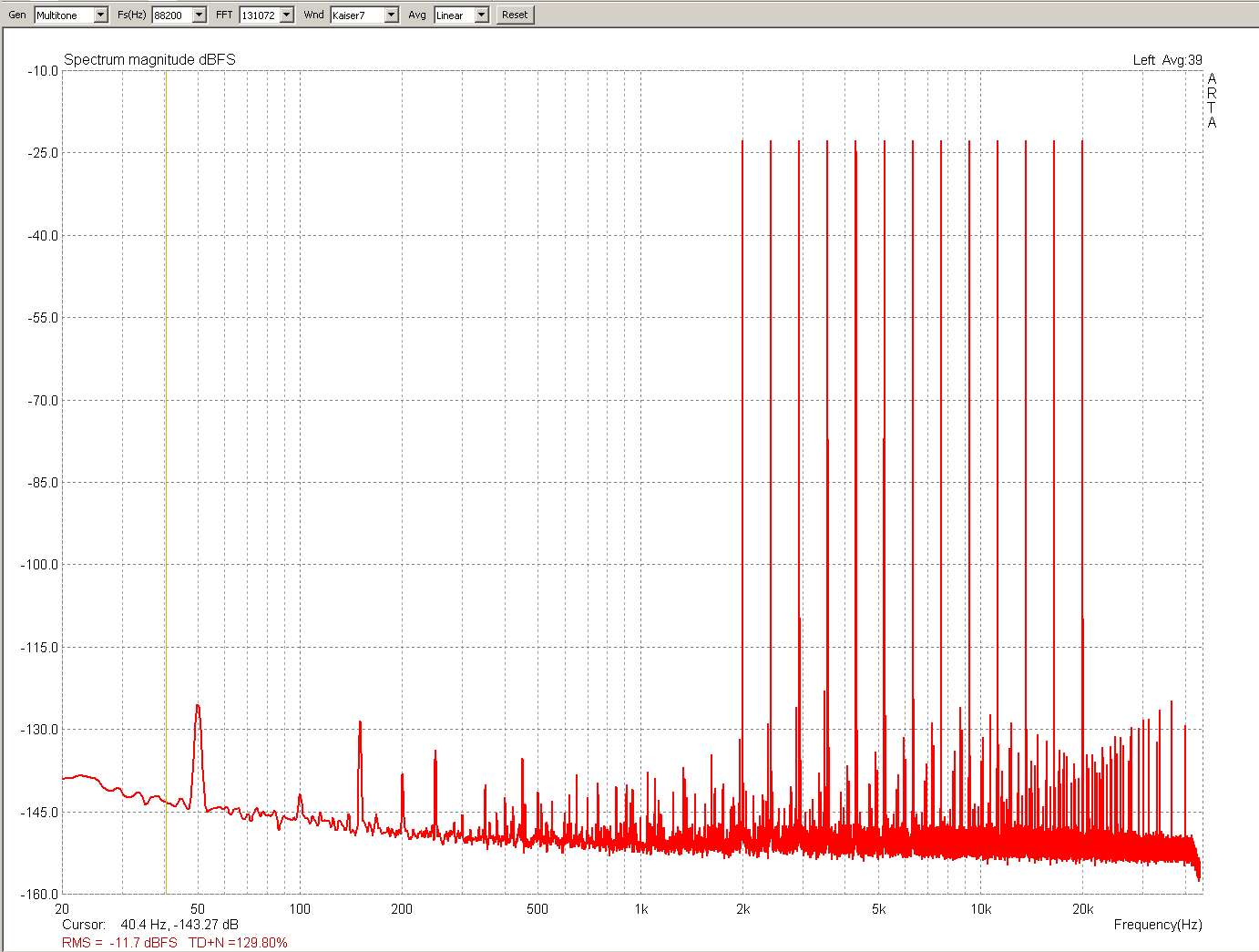

Ok, one could say: the levels are nice and low anyway, why should we care at all?
I can not respond to this question. But would like to show from a different point of view:

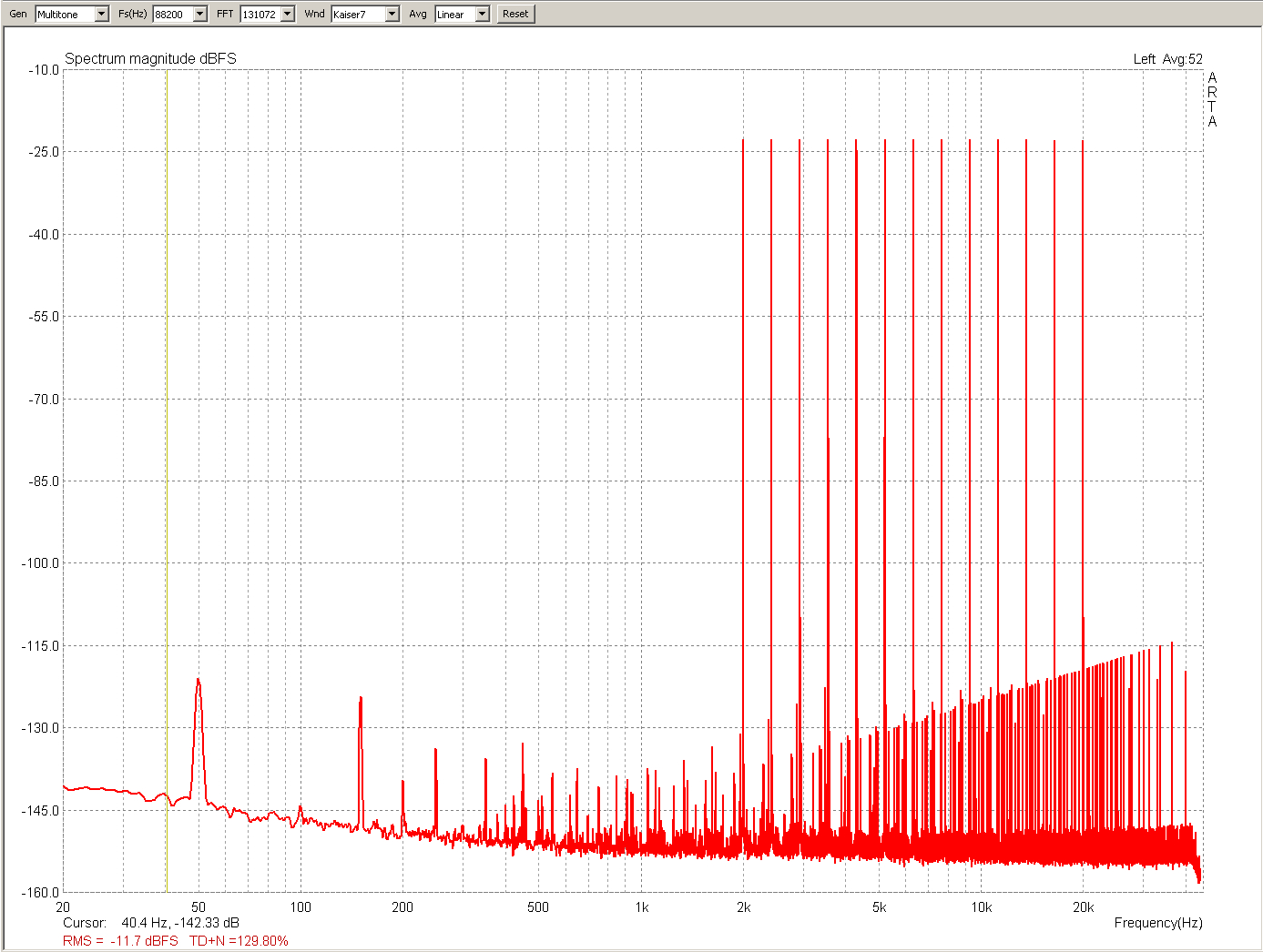

How does this same test look like with a multitone signal?
Again, case a.) first, then b.)

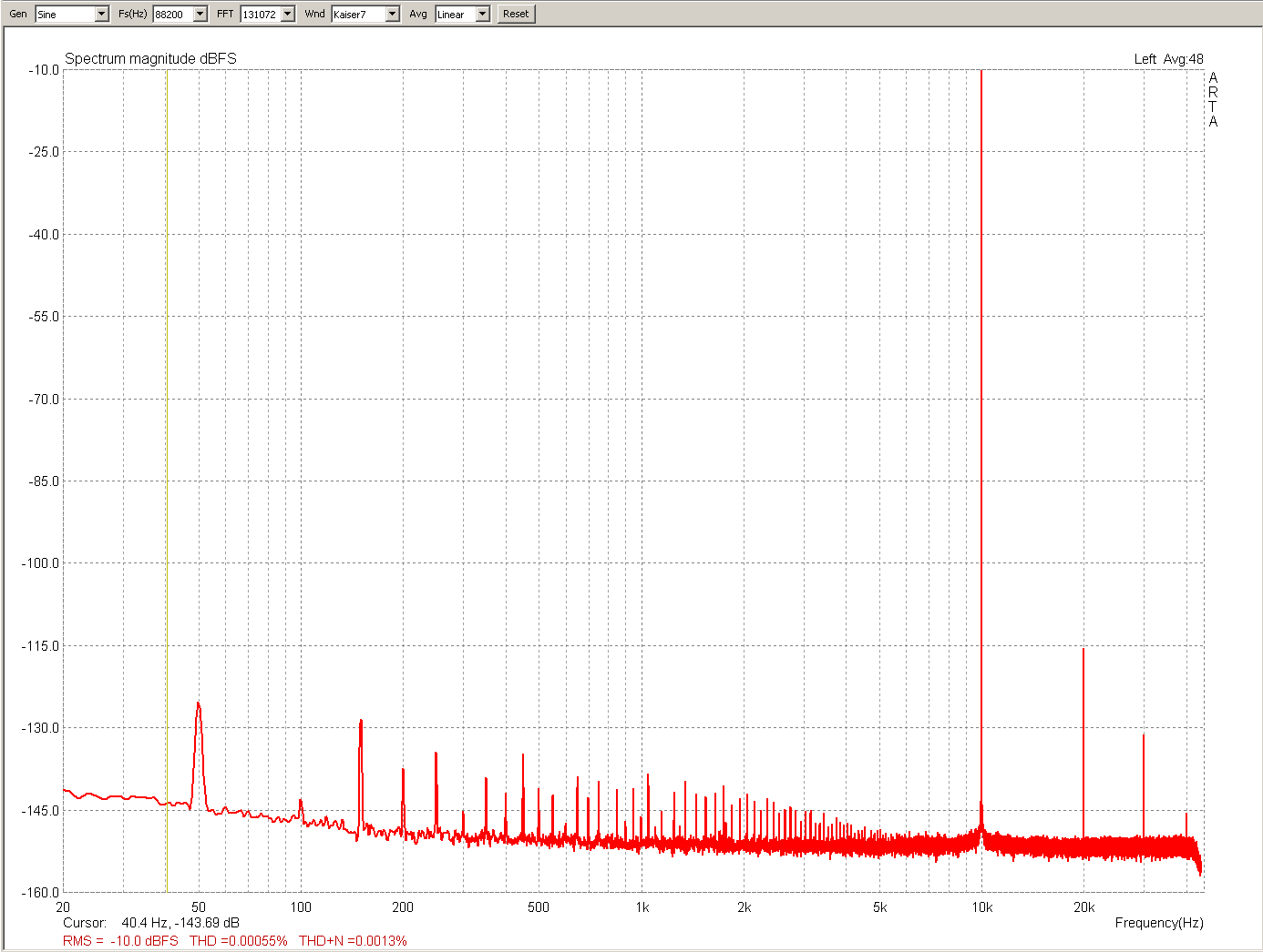

Finally, here it is the same test, but in place of the DCB1, the Evolution amp with OPA827 in input is used. Obviously with it's ~30dB gain, so the output level is high.
Case a.) here is the same, gen level is A, source impedance is ~500ohm.
Case b.) here it is with a 47kohm pot at middle position, gen at 2A level, source impedance is .5kohm+~12kohm=12.5kohm (so it is worse, higher than with the DCB1)
First is case a.) then case b.), 12.5kohm source imp.
The distortion at 10kHz is just the same; the lower hum components instead are slightly higher with the higher input impedance.
