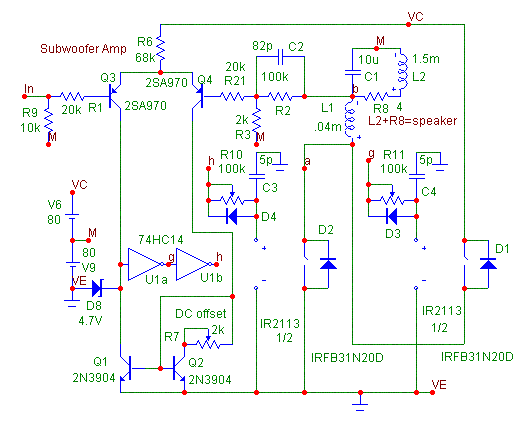

Hello all,
I have completed the basic design for a sub amp. I have simplified the current source for the differential input pair down to a resistor from the previous posted diagram since the current mirror helps to maintain the bias point for minimal DC offset at the speaker.
The amp self oscillates at 100khz with no input signal and decreases to about 25khz at full output at 90% of the power supply rails. It is good not to let a self oscillating amp clip at the rails, but that disadvantage does not come close to negating the advantges of self-oscillation.
C3 and C4 are internal to the input gate of the IR2113 and are included only for simulation. Decreasing the values R1 and R21 will let the amp oscillate at a higher frequency. I really want to use 2SA1123 transistors for the input pair, but I do not have the spice model for them and don't really know how they will affect the circuit operation, except I would expect the oscillation frequency to increase.
The node point "M" will be circuit ground since the digital part of the simulation of the 74C14 requires that its negative lead be at ground. That problem is due to my lack of talent at computer programming to change the spice files.
Increasing the output inductor, L1, also lowers the oscillation frequency. For now, I chose a low value because the air core inductor calculator program produced an inductor with nice physical size for that value.
I was thinking that it probably would be good if Q1 and Q2 of the current mirror were smaller and faster. But those worked well in the simulation.
Hello all,
Seems quite simple (what's very good).
Then the amplifier is to operate with symmetric suppy rails or only a positive voltage?
Let us know how it goes, ok?
Best regards
Best regards
Sorry! I dind't look at the voltage sources. It is now clear that the amplifier works with symmetric +/-80V rails. Good!
Sergio

Some comments on your circuit, subwo1:
You seem to have used the same dead-time control that I did. However, I found by experimentation that that dead-time was not enough and had to add a 33pF capacitor in parallel with the input capacitance of the IR2113 (in my case I put a XOR gate before to make the signal square, altough I guess it is not necessary). I found the minimum dead-time to be about 120ns in order to minimize dissipation in the mosfets (that's for mine, perhaps that time is different for yours).
Another thing: Taking the pwm signal from one inverter and the inverted version from the output of other inverter cascaded with the first has a disadvantage: the second inverter introduces a delay. That causes more distortion. Perhaps with proper feedback and for subwoofer use that's not important, but at least have it mind.
Did you have in mind the voltage ratings of the input transistors? It is only a question, I have not checked it, only that we are talking about 160V supplies.
I am specially interested on the results obtained with a hand made inductor. Tell us how it goes with your prototype!
Best regards
Best regards
Or maybe use a cascode !
If this straigtforward and intelligent amp performs well, then there is nothing left to do than to congratulate !! 😎
I did some simulations on self oscillating PWM amps but I always had performance worse than using non-selfoscillating topologies. But I have to admit that 1.) simulations are simulations and 2.) I didn't study the subject with much depth.
The best ones among these were always the ones using hysteresis like yours. While the ones using phase-shift for oscillation should have some theoretical advantages, I never got them right.
Regards
Charles
The hysteresis to what Charles refers to is due to the schmidt-trigger inverter, 74C14, am I right?
By the way, subwo1, how are you going to implement the supply for the IR2113 (I wouldn't use less than 12V) and the 74C14?
I used a resistor in series with the input of a regulator in order to get 15V referenced to the negative rail from it without the need to use another power supply. However, with 80V you will need to use a BIG resistor.
What about a separate transformer, rectifying it and connecting the (-) of the bridge to the negative 80V rail as Crest LT does?
Another option is using a switching step-down regulator.

Hello subwo,
this DT adjusting is dangerous in real life (IMHO), however D3,D4 have capacitance about 5pf too.
this DC adjusting have not good temperature stability. (you need twin BJT`s).
IR2184 best choice for sub application, i agree too!
