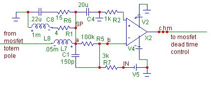

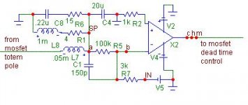

total feedback
Well, yesterday I quickly tried to take the feedback signal from the very output. The results were these:
The gain was the expected, about 30 V/V (with a 33K and 1K feedback and input resistors).
However, I noticed that, at medium frequencies, the output was very distorted with a sine wave input.
Besides, at low frequency, there were high frequency oscillations superimposed to the signal.
What I think is this: perhaps the gain margin is very small. What if I put a capacitor in parallel with the feedback resistor so 1/2piRC gives my desired cutoff frequency, say, 30 KHz?
Any more suggestions?

Sergio,
Ahh, phase compensation? That is probably a good thing to try. The amp is losing control of the output is the way I would put it. Sometimes I just explain things funny since I just operate on an intuitive level. I never was any good with formulas and math.
It is the PHASE-marging actually that gets too low.
One possible solution would be the use of a double feedback loop as CREST does.
Another one would be the use of a controller topology called PID.
You can also make mixed feedback, i.e. feedback from before and after the output filter.
Taking feedback from the output filter would be much easier for a 2nd order LPF than a 4th order one.
In any case you have to add some circuitry to the LPF to make it stable for a broad range of load conditions.

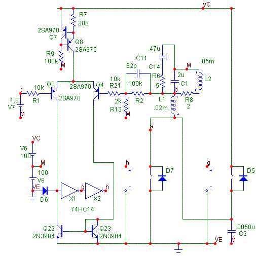

Simulated Alternative Method
OK, I have the diagram now. But, I would like to try using the 74C14 instead of the 5v 74HC14. Also, I would like to use 2SA1123 transistors for the differential input pair and current source instead of 2SA970 ones. I have experimented with this general method in actual circuits in the past, but not in a self-oscillating approach, and not with fast transistors. I had tried it with slow MPSA92 transistors in actual circuits with a 100khz oscillator, but the distortion was poor.

Simulators, Discrete Comparators, and Figure C
Hi IVX,
I like MicroCap because it is very fast to use. The schematics have a crisp, clean appearance. It does not require any programming skill.
I would think that an advantage of that circuit over other comparators, including the 393 is that it does not require much power supply consideration, and it draws very little power, like the LM393. Unlike the LM393, it operates off the main power supply rails. But I did not know about the existence of the LM393 though. I think one reason why this general approach did not work well for me in the past is that I was applying separate triangle waves to the input pins of the IR2113 and using both transistors in the differential pair to adjust the separate timing ramps on the IR2113 input pins. With this new circuit, the IR2113 is sure to get only opposite phased signals. Note: D6 should connect to the positive of the lower supply rail, not the negative.
Concerning figure C, I thought noise immunity in the level shifting was due to the high output impedance of the collector of the transistor. What advantage does the zener diode offer over capacitor coupling? Could the difference be the DC response of figure C? Is there any reason why the lower diode is not a simple switching diode? Best regards.
