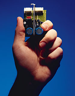

IVX,
thanks for the offer but I am currently building digital class D amplifier based on TAS5015 modulator. If I can synchronise TAS5015 it will be 3 phase phase shifted stereo design, othervise it will be a nice 5.1 surround amp.
I am curious if attached picture is a UCD amplifier? It is from Bruno Putzeys article in IEEE Spectrum.
Best regards, Jaka Racman
According to http://www.classd.org the UCD principle must be one of the simplest AND best sounding amps ever.
So the picture of the simple amp might show such a one.
I by myself haven't heard anyone of those so far (not even a SODA 🙁 ), so I can't comment any further.

Hi All.
Oui, cela - UcD l'amplificateur... alas, I didnt listen too it and slightly doubt, UcD sounds so well or Tip Voigt enthusiasm so much more.
I ` ll wait when Philips will make some TDA **** based under UcD concept. MUETA ` S circuit seems not so secret and after reading AES white paper, right now soldering are possible. Interestingly as well MUETA sounds, in fact not all of linear amplifiers with deep feedback are cool (feedback sound), or it not affected for class D? What do you thing?

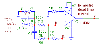

Self Oscillating Class D
Hi Charles
This circuit is closer to what I hope to try out if I get the chance. I have added phase compensation to the feedback circuit. Without it, I fear high amplitude oscillations could develop without a speaker connected. I have also input the audio at the summing node. I am not sure where it would actually work out better to input the signal, at the negative or positive input pin.
I like this concept because for a sub amp I hope to be able to use a relatively large output choke, L7, for efficiency purposes. One very good reason to take the feedback after the output choke, if the circuit can be tamed, is for not only the high NFB obtainable, but also for the high damping factor operating on the speaker that should be had in the process. Otherwise the large choke could add a lot of distortion.
Also, with class D, it easier to run the power supply rails higher than with other topologies because the on/off nature does not significantly increase power dissipation in the output mosfets. The extra headroom allows the feedback circuit room to control the inductive speaker through a large sloshy choke. To prevent running the output to the higher supply rails inadvertedly, the input can be clipped at the appropriate level.
I like to use air core chokes for linearity and their unsaturable nature.
I wind air core chokes in such a way that half of the windings are in one direction and half in the other. One can simply wind it in two sections on a form, slide out the form, and double the choke back at the middle. This way should cancel EMI at a distance.

Hello all.
Yesterday I built and tested my revised version of the amplifier. The main changes from the original were a more exhaustive bypassing of all the supplies, substitution of the zener by a 7815 regulator to get 15v over the -Vss line in order to supply all the output stage logic, and using a 4-pole filter instead of the 2-pole one.
The results were good, the ripple much smaller (but not the calculated level), but I identified two problems:
a) When connecting the feedback with C1=1nF, the amplifier failed to oscillate. However, I changed it to 2.2nF and it worked fine. This failure appeared also in the previous version. What can the cause be?
b) I measured a noticeable amount of switching noise at the audio input. I connected a CD player headpone's output. The level of the ripple is proportional to the output current, hardly noticeable when no sound is present. I have to identify where this noise comes from. Perhaps from the feedback?

IVX:
I have been having a look at your amp. Some points seem interesting:
First, you have used a driver chip that requires only one PWM signal, managing the inverted version and the dead-time automatically. Simple and effective solution! By the way, there is another version (IR2184) that can give up to +/-1.7A thus not requiring buffer transistors (just for information).
Another thing you could explain to us is the feedback method. You feed the low frequency signal and sum it with the very output of the amplifier. Then you also feed the square wave from the totem-pole and also the output from the filter to the comparator via three different paths. A bit complicated for me!
What is the output ripple level?

hi ssanmor
A) You cannot expand frequency response for feedback indefinitely highly. If to use faster mosfets, driver etc and more Fsw then ok.
B) On my experience only mosfets and driver by switching dont produce noticeable noise. Lower input gain need to avoid noise.
Regards.
