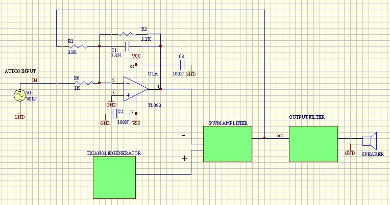

Next daily report 😉
Well, I think that things are starting to go really well. I managed to get two high speed probes so I could really adjust the dead time for both mosfets at a time. I have found that the best results are obtained with about 100ns dead time.
With the filter installed (only a two-pole one, 33uH + 1uF capacitor), the idle consumption is about 30mA each rail, so the mosfets hardly heat up a bit.
With load the dissipation increases somewhat, but I have measured about 90% efficiency with a 5Ohms load at about 40W.
Then I connected the feedback resistor to the totem-pole output, and measured gain, bandwidth, etc.
I connected some real audio to the amp, and I must say that it sounds very well. I did a 1hour test at a reasonably high power level and it show reliable, the Mosfets were only warm.
I am about to build the "definitive" version.
The surprise is that the gain was lower than expected (about 9V/V). I post the simplified schematic below. Could someone point to the correct formula to calculate it?
The simplified schematic is:
