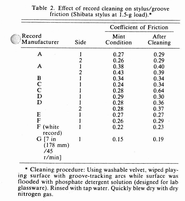

There was an AES paper some decades back that measured record friction before and after cleaning and in all cases friction increased after cleaning. As one of the causes of noise is 'stick/slip' fricion in some cases the vinyl formulation will have a large enough increase in friction to be noticable. Sadly he didn't note which record labels or pressing plants and no one has tried to replicate this so there is a huge loose end here. I suspect the friction will go back down over time but no evidence.

I guess that makes sense. I wonder if there's a way to improve it? Maybe some sort of lubricant type stuff?
There are lubricants, LAST being the most popular. However getting something to stick to vinyl is actually remarkably tricky. Nicotine is one of the few things that does. Finger prints do as well as we know and they would be great lube were it not for the dust magnet issues.
Just for interest here are the two tables from the Pardee AES paper from 1981 which shows the change in friction from cleaning and the effect of various lubricants. It shows some records are affected significantly by cleaning and some almost no change. Cartridge and record modulation also play a part as low compliance cartridges increase friction with modulation more than high compliance ones.
But the differences are, generally, remarkably small for the before and after cleaning data set. The lubed up coefficients are remarkably low, but what did they use? Was it likely to be otherwise harmless? I've always stayed away from putting permanent treatments on LPs. Permastat anyone?
In general, but there were outliers. It's not a definitive data set but some interesting pointers for further research.
. He didn't tell sadly.
