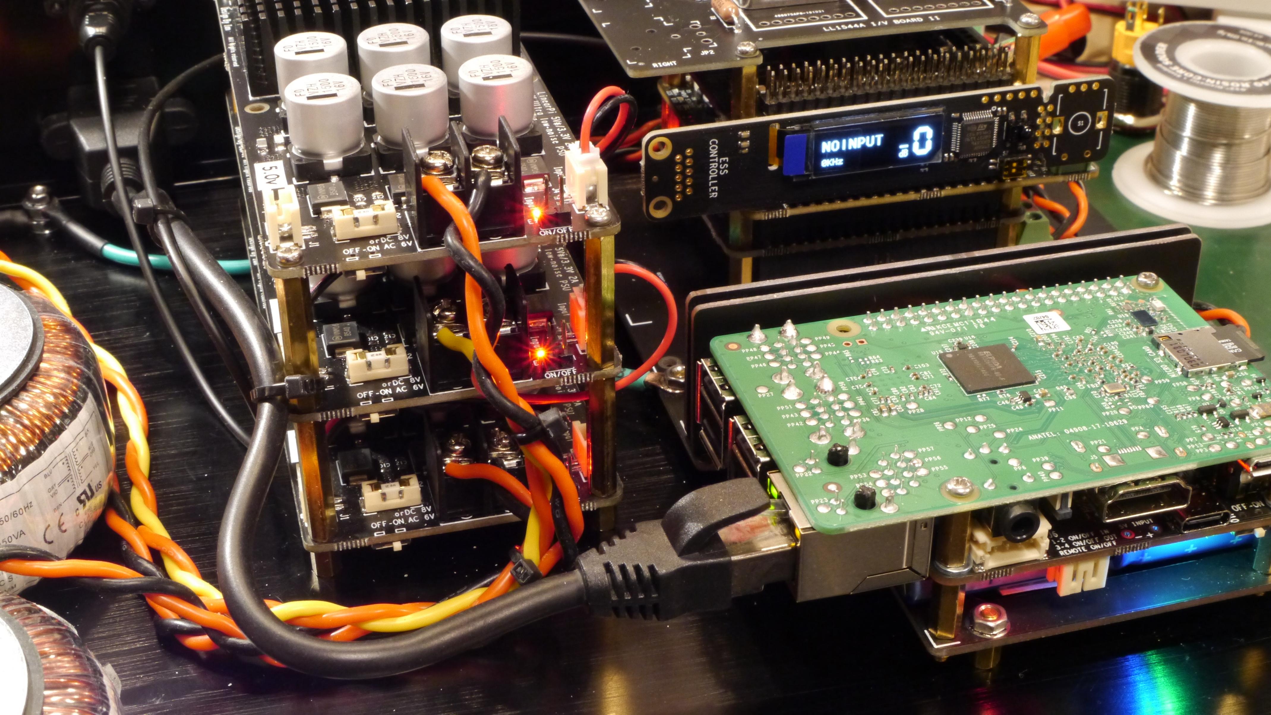

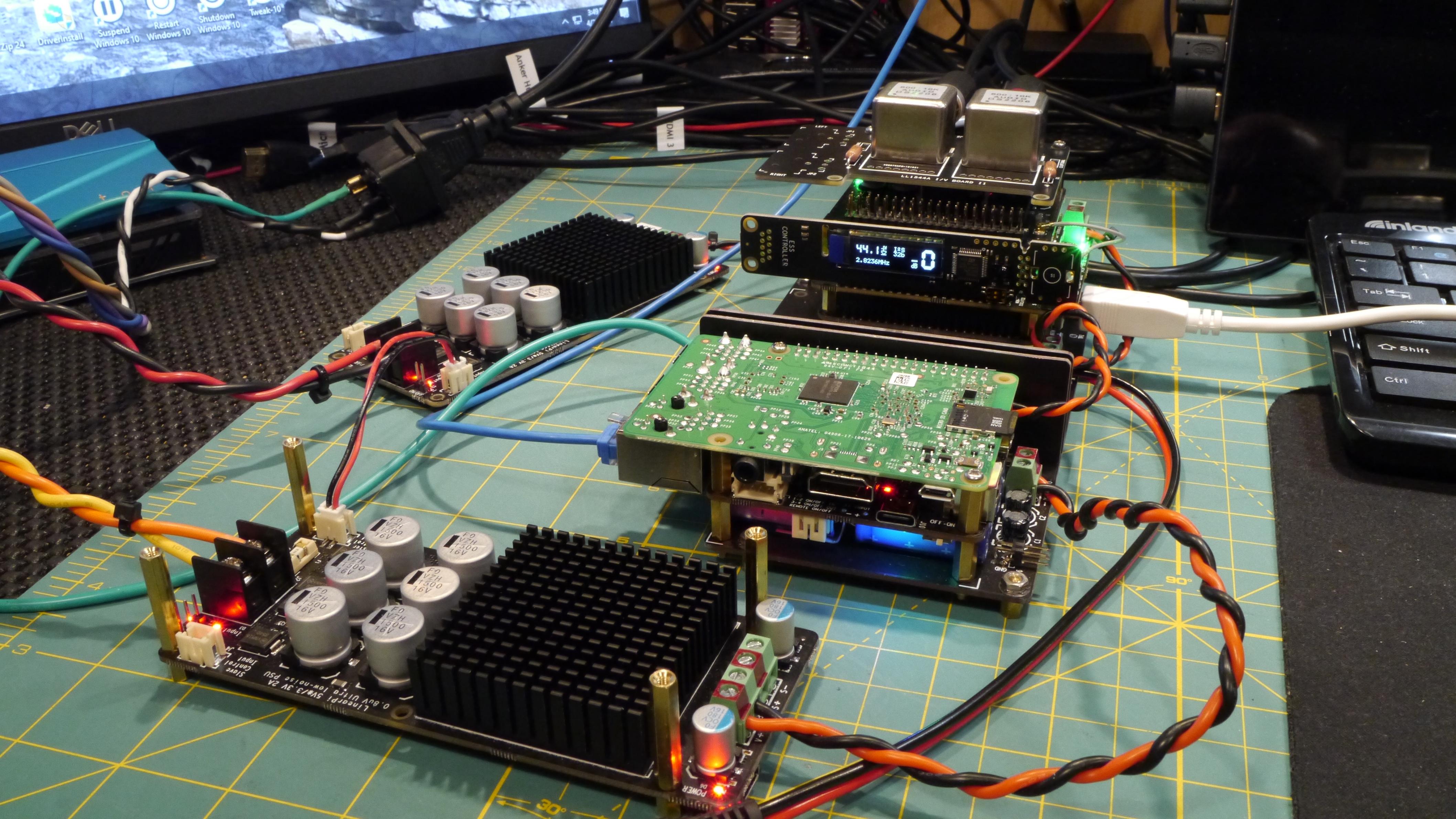

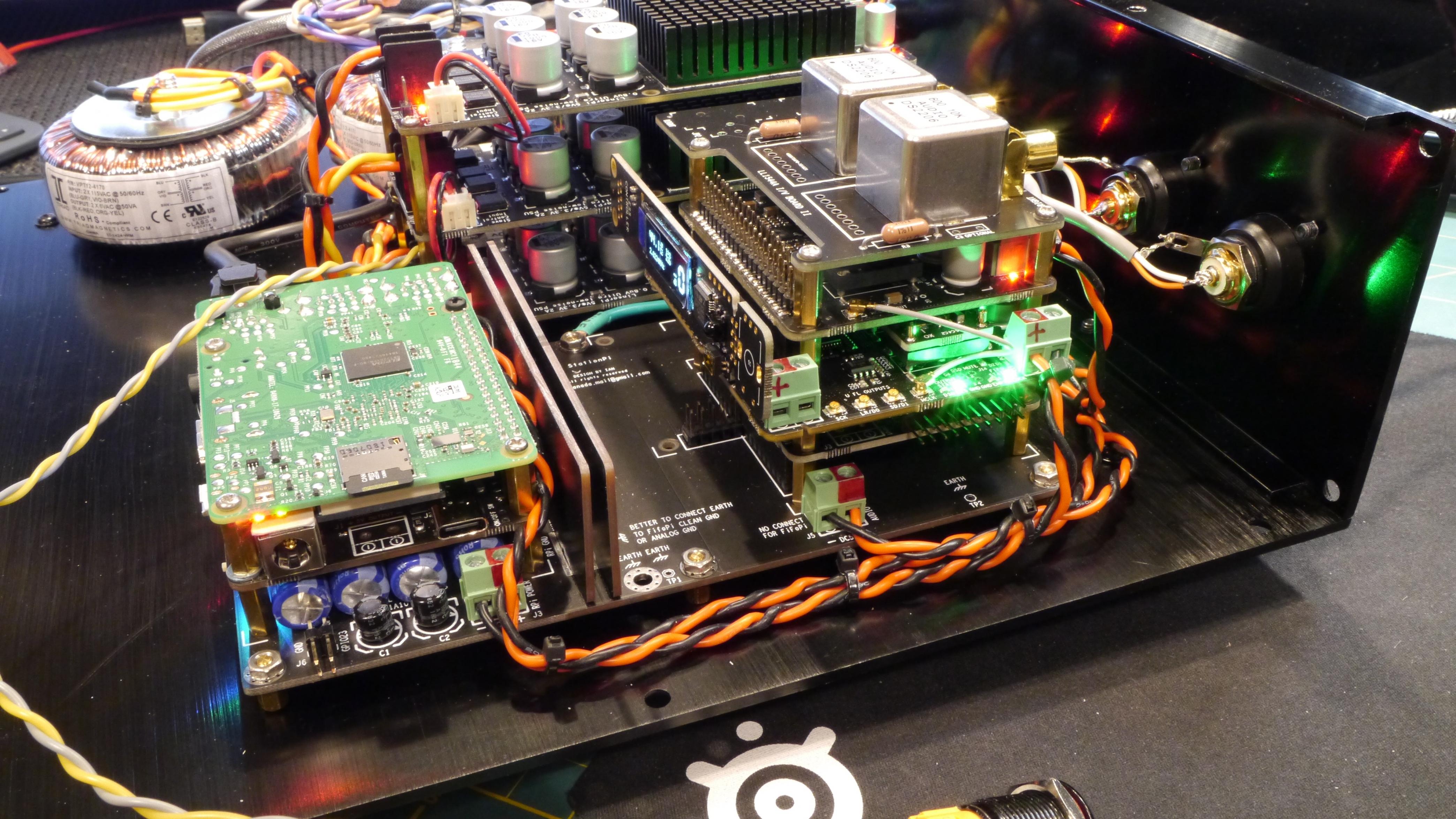

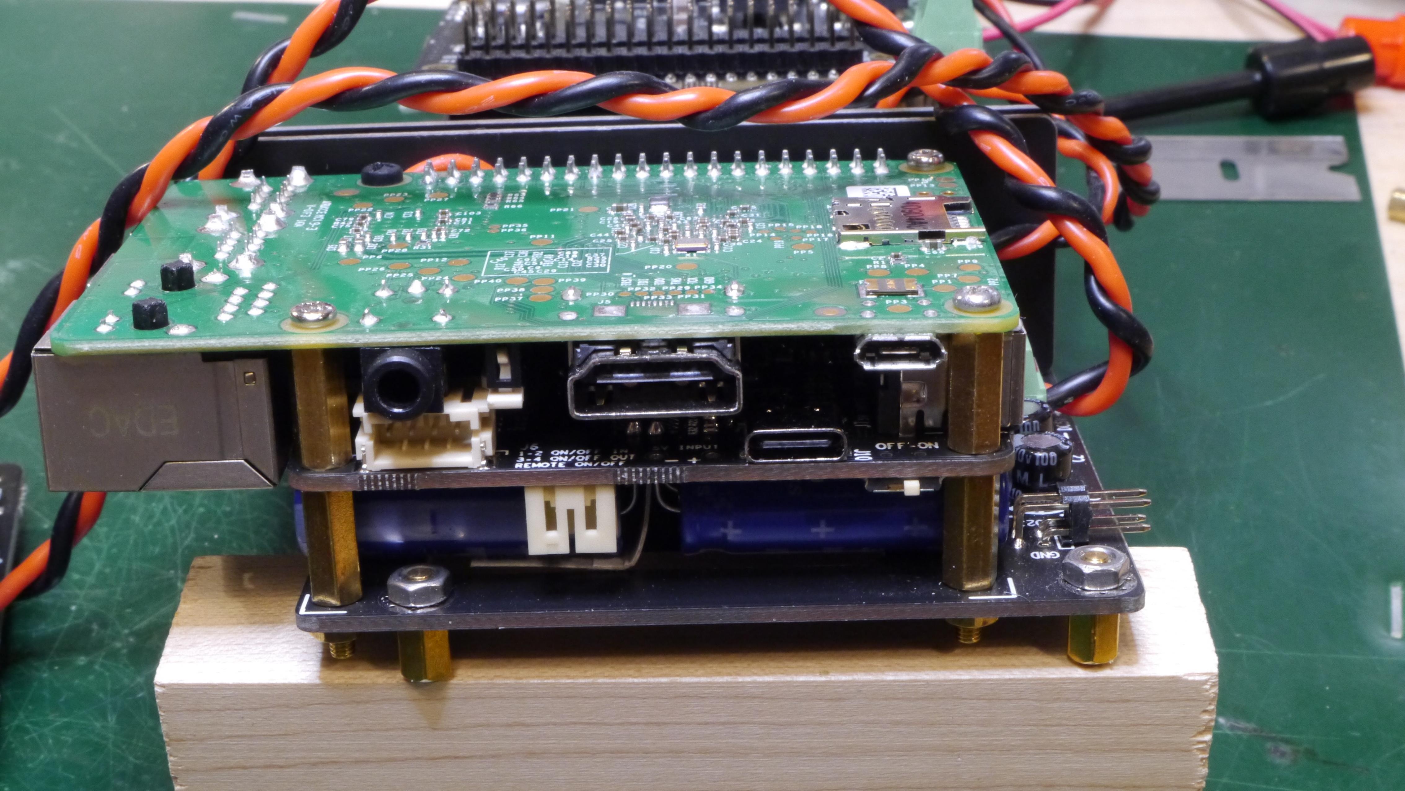

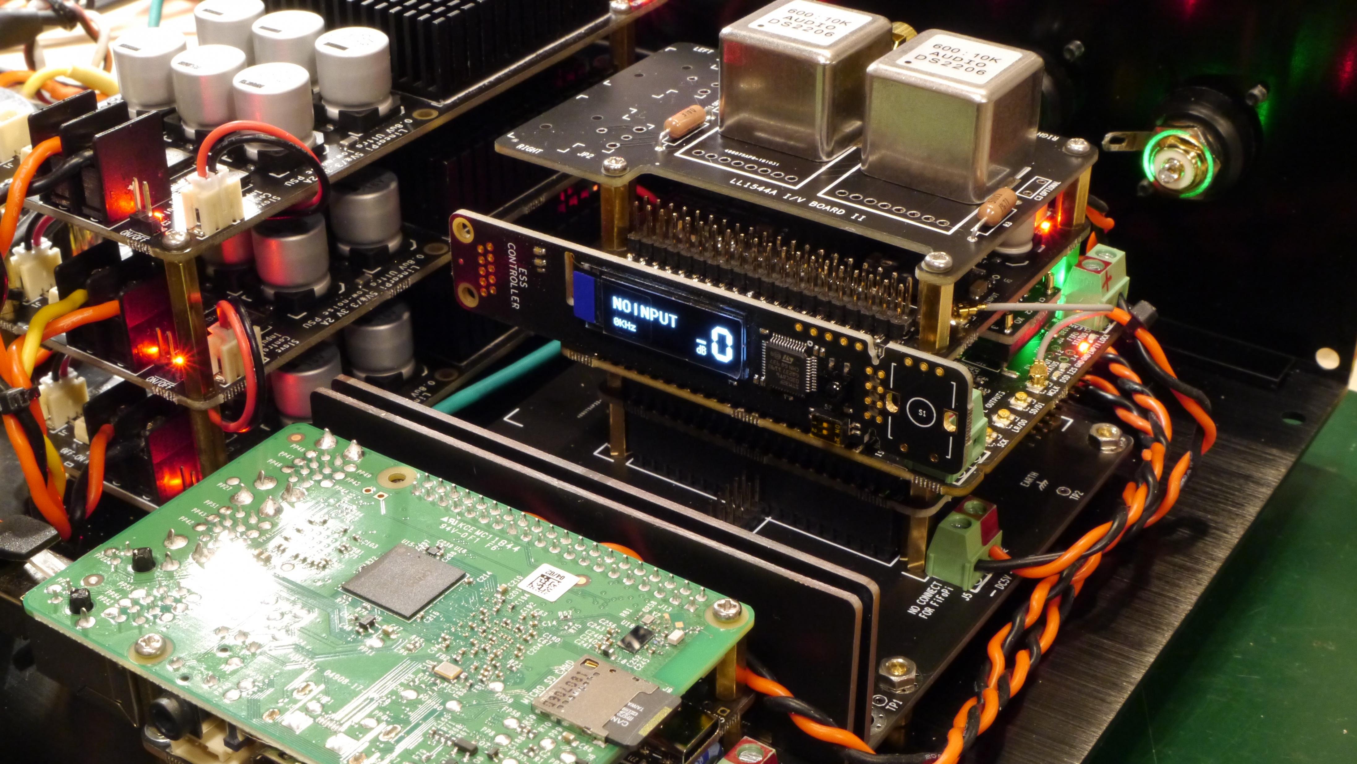

After enjoying a couple of years with Ian Canada's DAC stack, I thought I would build version 2. This would encompass using some of his new boards and use the StationPi as the platform. This is not a full evaluation of the sound, but rather a peek at some of the stages of my build using the new parts. I'm still listening to it on my bench, and have a couple more tweaks to finish it up.

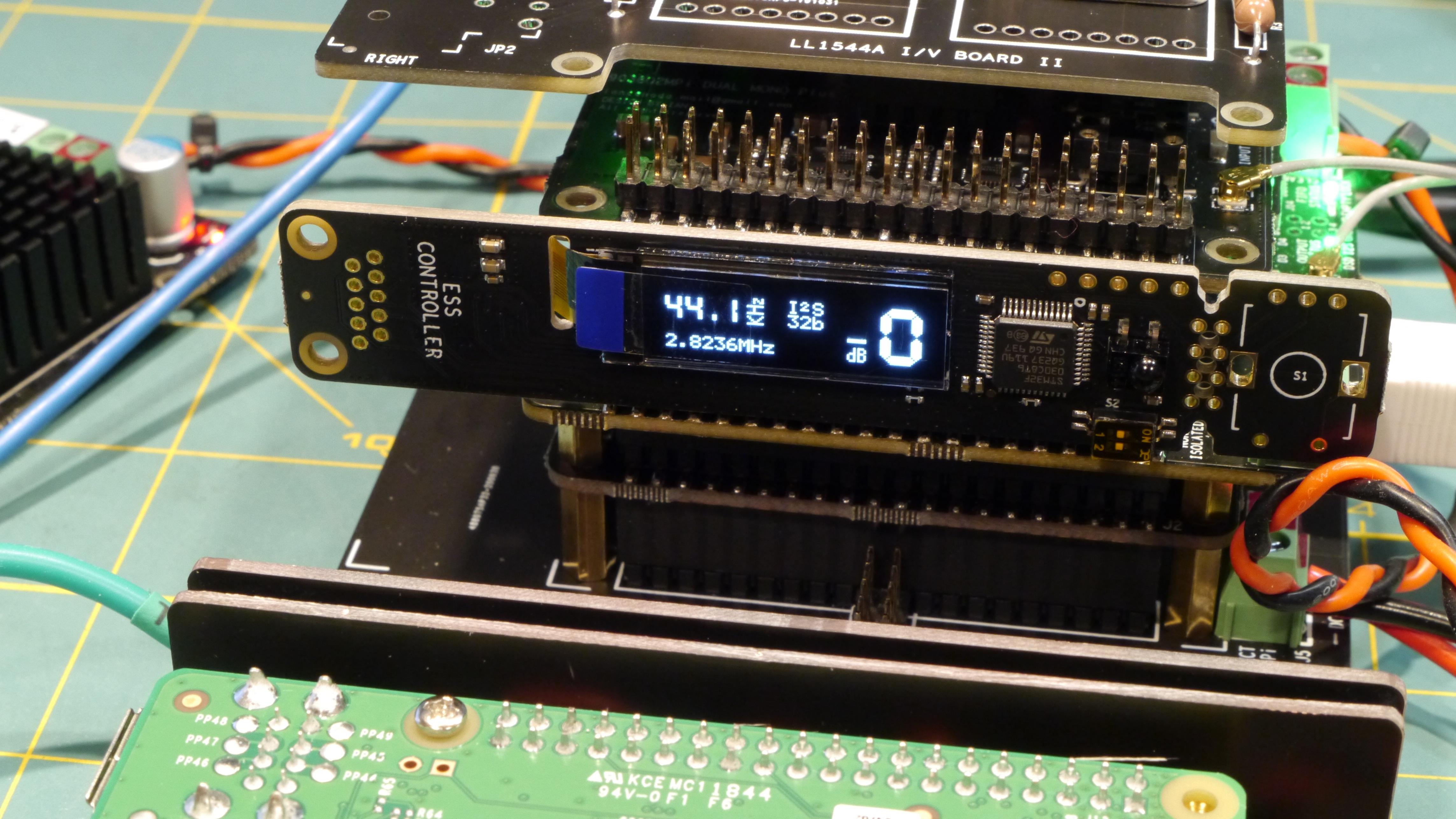

A few notable differences from my first version are the addition of the new ConditionerPi, the FifoPi Q3, the StationPi, and the use of Ian's new LinearPI PSUs. To add to the versatility of the streamer, I also added the ReceiverPi for additional inputs - primarily Toslink. Oh, and of course the addition of a transformer output stage. Using a transformer output stage is a first for me, so will be interesting to compare the sound to my opamp output stage of my original.

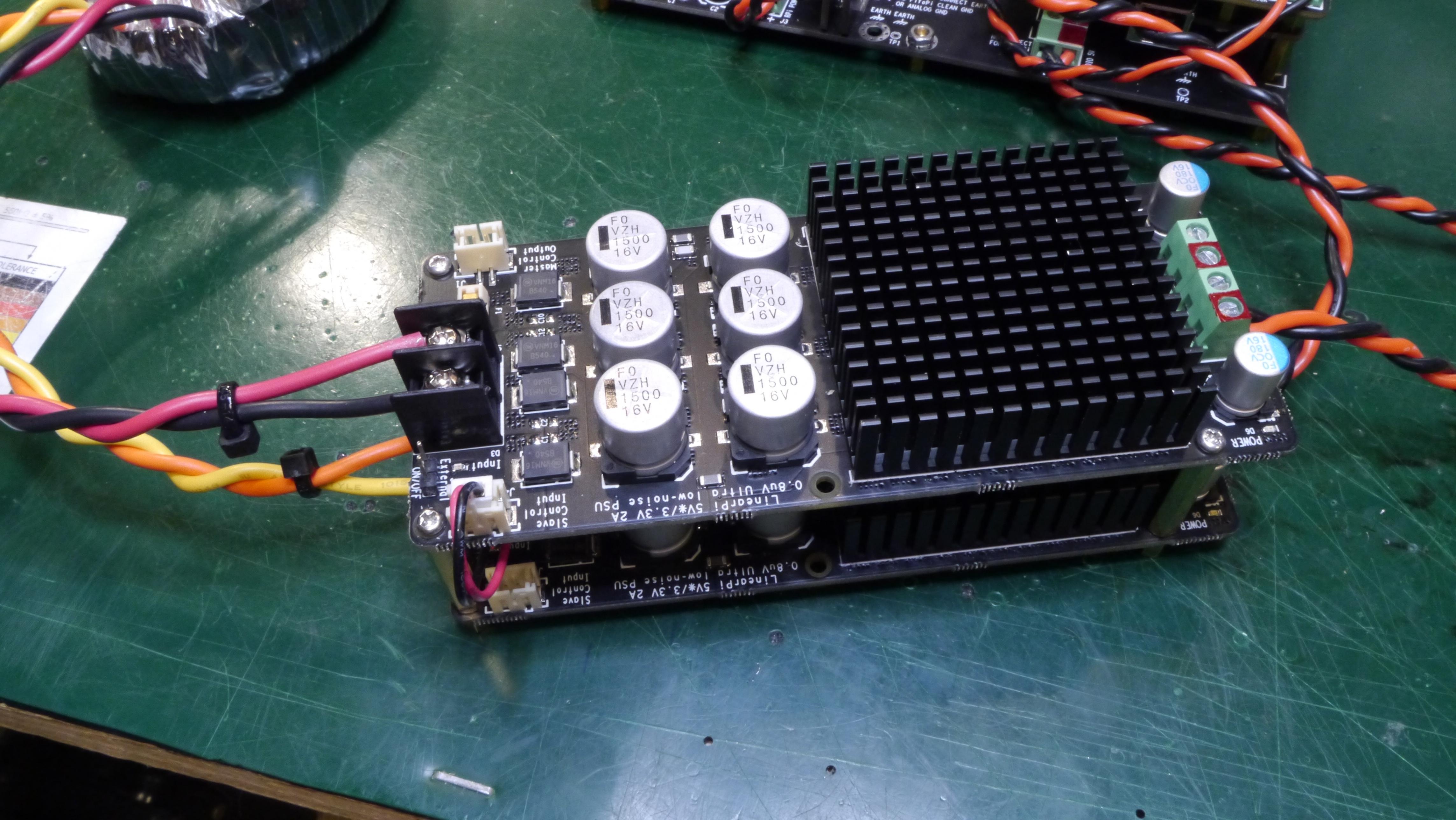

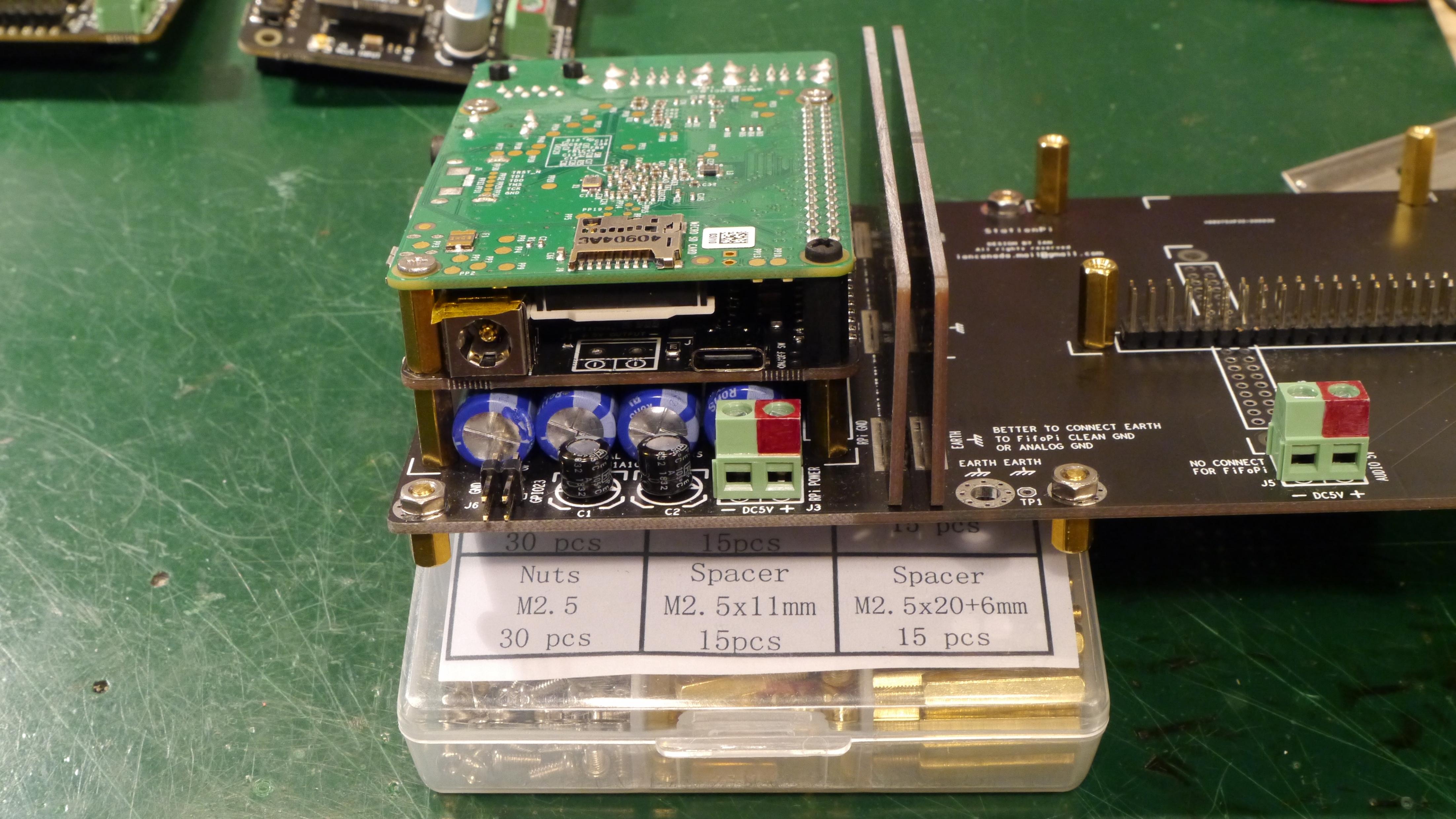

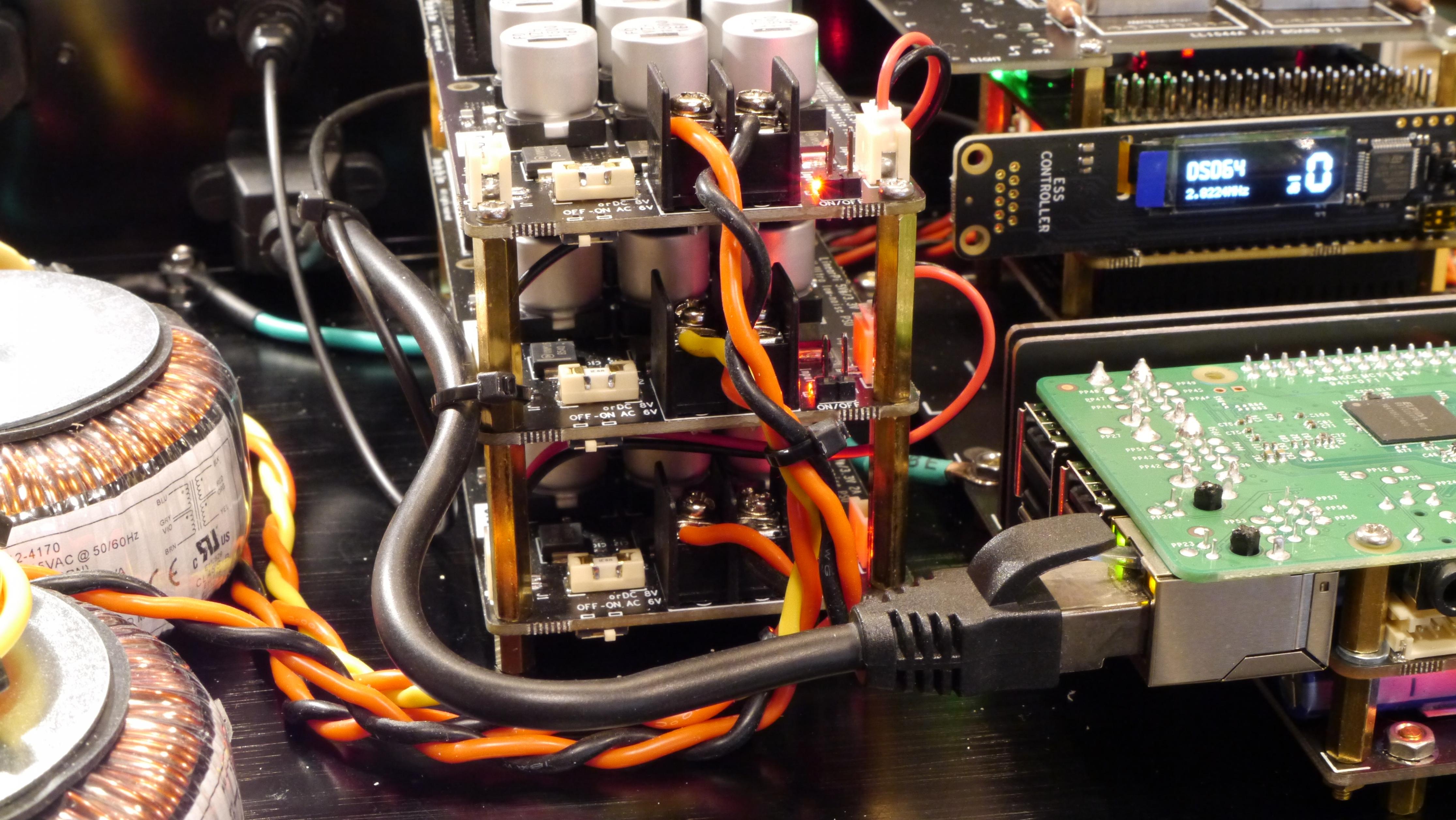

Using the StationPi, the layout is less spread-out and more compact. The stackable PSU really helped gain back some chassis space too. I used 3 of them for the necessary 5.0 and 3.3v. Still had to use 2 xformers though, to get enough independent secondary windings. In addition, I did not need the +-15V PSU for the opamps of the Std I/V stage, so that helped with space as well. A cool feature of the LinearPis is they can be strapped for Master/Slave control. The external front-panel switch controls them all using this feature.

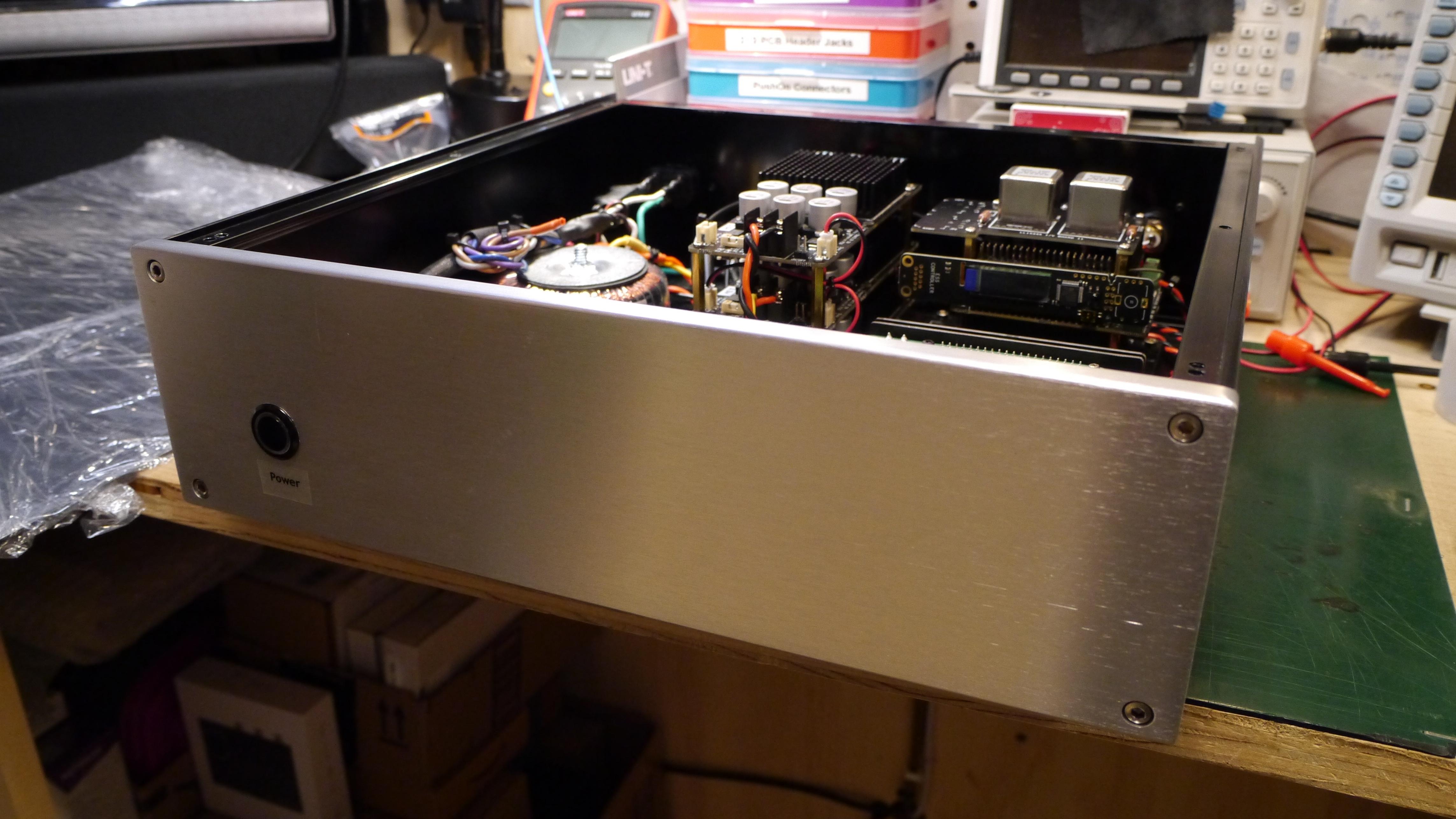

I put it all in the temporary chassis, so I could easily move it into my listening room and compare the sound using roon. The case is not up to my usual standards, but it's workable for the foreseeable future. Enjoy the pictures.

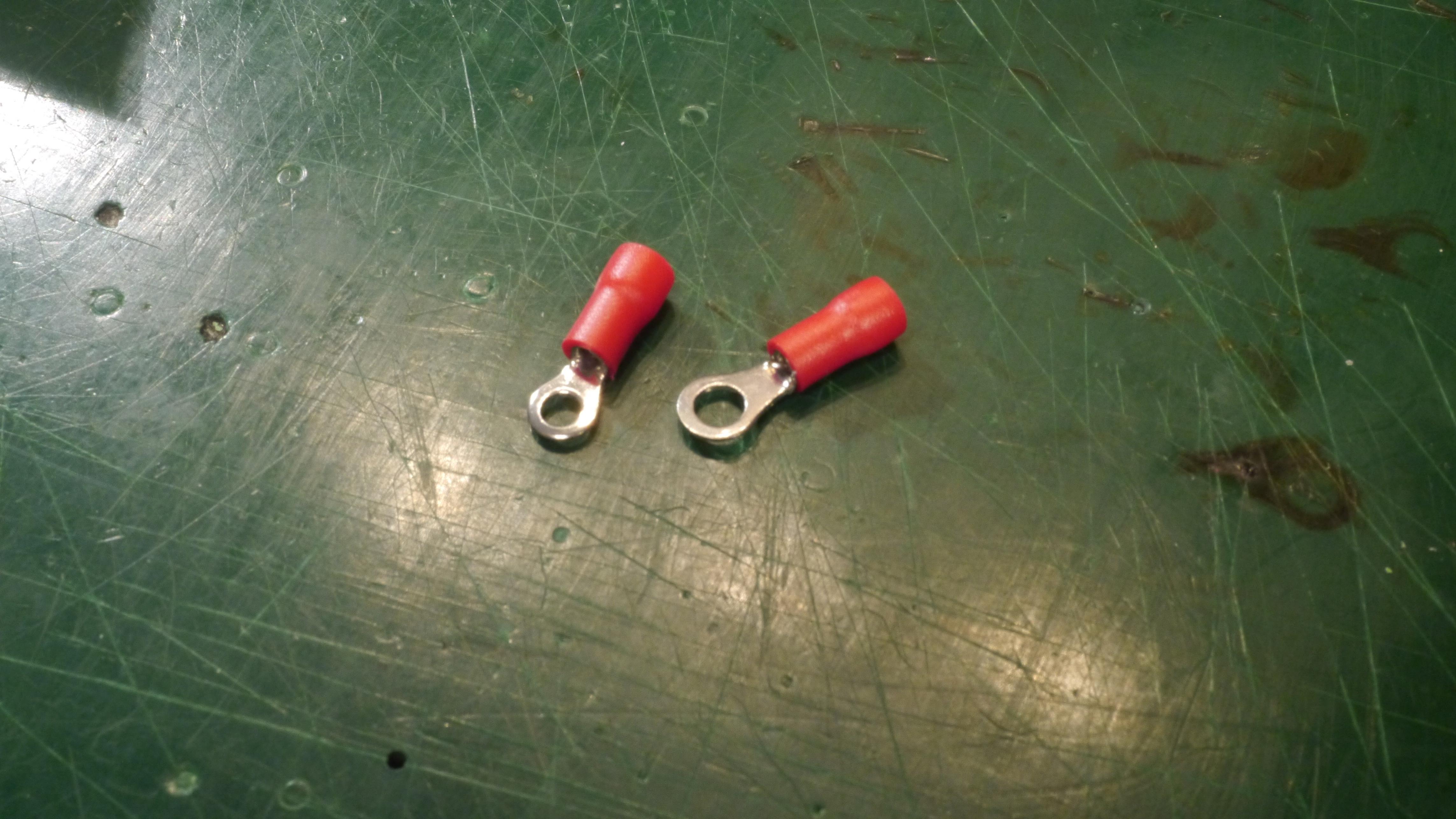

What I typically do is first ground the IEC to the chassis with a short piece of GREEN ~18AWG wire. I generally use a 4mm bolt by about 8-10mm long as a grounding post from the bottom of my chassis. The length will be determined by the thickness of your chassis and how many grounding wires you need. Be sure and sand off any paint or anodizing from around the hole in your chassis. Then use an external toothed washer to make a solid connection of the 4mm bolt to the chassis with a nut. You should be left with about a 4mm extension of the bolt to add additional grounding cable/lugs from your circuitry. I always use the round crimp connector and solder the cable to the connector first. Using the round connector ensures that it will not come off the grounding bolt. See picture below. These are useful to keep in your shop. You can get a variety-pack from Amazon here.
For this project, I used Ian's suggestion and ran a grounding cable from the StationPi (as noted on the PCB) to the grounding bolt near the IEC as mentioned above. Any other PCBs that have a specific ground point, run a separate cable back to the grounding bolt. This is considered a 'star' grounding scheme. Most DIY'ers like to use it, some are not so sure. 😉 Personally, I ALWAYS use green cable for earth ground. It's a standard color used in the US for earth ground. And you can easily, visually identify that's it the ground!
I'm not familiar with the Shanti PSU, but you will want to run an earth ground cable back to the grounding bolt, unless the ground wire from the IEC goes directly to the Shanti PCB connector. You will also want to run a cable from the USBSignature to the grounding bolt since it has an earth ground connector.
For this particular build of mine, I did not ground the LinearPis. Both of my Ian Jin DAC stacks have been working without any hint of hum, or ground loop noise. (That I can hear.)
