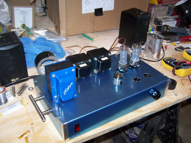

R6 (even the 7W version) stank for a week or two at least. Now I only smell it when I am up close.
The other thing that runs really hot are the two diodes feeding the bottom half of the heater circuit: D4,D5. These are not Schottky diodes and so they have a higher forward drop than D1 and run really hot. They are only 3A diodes, so they are being pushed really hard. When I had the original breadboard apart, the area of the PCB around these was noticeably burnt. Some of the smell is likely coming from these. I should have left more clearance under these. I may switch them to a dual Schotty package like D1.
I have a 10W 10k that I was planning to put in place of R6. It's a big thing - so I might have to be creative on getting it to fit without getting too close to the cap.
Hmm data sheet says 300b's draw 1.2A each for heater current and 300ma for the 5842. Err, that adds up to 3A...
Actually I don't see how D4 & D5 do anything since the center tap isn't grounded... where is the current path?
And here are some temp readings - all in F.
R6 - 157
D4 - 146
D5 - 184
D1 - 207 *toasty*
V1 - 131
I took my 13mm wrench off and replaced it with a big pentium heat sink - but I had to use two washers to get the spacing I needed. Probing around D1, it's heat sink, the washers - it looks like the heat transfer from D1 to the first heat sink it just inefficient. I may toss the small heat sink and connect it directly to the big one. Hopefully the problem isn't the mica insulator, because I'll need that...
Anyone know of any thermal epoxy I can use? Cheap is preferred.

oldmanStrat said:Actually I don't see how D4 & D5 do anything since the center tap isn't grounded... where is the current path?
Their anodes are grounded because PAD3-4 are shorted. D1a/b + D4/5 become a bridge rectifier. It's that old-style schematic format where all junctions are shorts and cross-overs are those little bridges. Not intuitive to my eyes either.
oldmanStrat said:D1 - 207 *toasty*
It's actually U1 that is generating most of the heat. Since D1 is a dual schottky, I imagine it could live without the heatsink.
I was very careful to put the laser on the body of both devices. U1 definitely measured cooler than the diodes. I could be wrong - but I measured it several times, and they always came up the same. I suppose a thermistor would be better... used to have one of those somewhere...
I wondered about that, but that would make C2 useless... but you *have* to be right since D4 & D5 are obviously conducting current.
One thing my dad taught me was to never draw a cross in a schematic ... it confuses people! These days I always insist that anyone drawing a schematic, that I will use, put a dot or some kind of indication that there is a connection in the drawing.
Wonder if George would mind if I redrew that for him 😉
oldmanStrat said:I was very careful to put the laser on the body of both devices. U1 definitely measured cooler than the diodes. I could be wrong - but I measured it several times, and they always came up the same. I suppose a thermistor would be better... used to have one of those somewhere...
It might be how it is packaged, but I'm pretty sure it's the regulator. Schottkys typically only drop .4V while the regulator is dropping a volt or two.
oldmanStrat said:I wondered about that, but that would make C2 useless... but you *have* to be right since D4 & D5 are obviously conducting current.
Yeah, C2 is useless in the 300B config. In the 45 config, those diodes become a half-wave bridge for a negative power supply that is used to kick-up the 3.15VDC coming from the other half back to 6.3VDC for the 5842 heaters. That's probably why he didn't bother using a better diode there...in the original design it was only powering the 5842 heaters.
yes but all of the heater current is passing through both of the diodes - 3A @ 5V - 15W in that TO220 package... seems like it would get hot to me. I have no idea how much current the -150V draws.
[edit]
ick - if they both only drop .4V then we are looking at .4 x 1.5 x 2... not a lot of wattage. doesn't explain the measurement...

Ok decided to break my rule and try it out on my 94db speakers.
Hmm, I have to crank the volume all the way to get a reasonable amount of sound out of it.
What is the recommended bias for the 300b's? I'm at 60ma now.
Damn this amp is quiet! Ears right up to the speakers, and I'd swear it was off...
oldmanStrat said:What is the recommended bias for the 300b's? I'm at 60ma now.
Per Tubelab, it's from 60 mA to 75 mA. You are at the lowest point. Try 68 - 70 mA range.
Insufficient idle current should not cause the apparent total lack of gain he is seeing. I accidentally ran a pair of single ended 6B4G with about 100 volts on the plate and 15 mA idle current (they should be ~300 volts and 50 mA). They sounded alarmingly normal at normal volume levels, providing adequate volume for background listening.
I think he's got the signal shorted to ground at the input, the output, or somewhere in the middle.

ACK - found the problem - I have a bad 5AR4 !! Only half of the tube was working... This makes a lot of sense since D4 & D5 were measuring significantly different temps. It may also explain D1...
I noticed that one of the filaments on the rectifier was NOT glowing at all, but the other one was very bright. Swapped it out with the one from my SSE - and the bias was waaay off !
Reset the bias, and now I have some volume...
