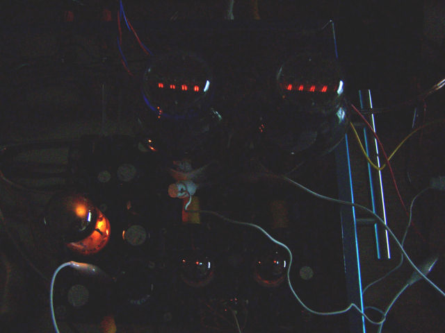

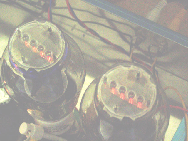

Checkout is done! Not so bad really... But there is this smell of newly heated tubes/plastic - have to keep an eye on that. And a fire extinguisher nearby 😉
At first I was worried that there was no output on the speakers, untill I set the bias for the 300b's to 60ma or so. After about 5 minutes all sound stopped. Since there was still B+ I knew this was the thermal shutdown of the CCS kicking in... So obviously I need to take care of that asap.
Here is a pic of the 300b's and one of them with a blue glow
Here's a shot of the setup... yeah, it's not exactly the neatest working environment - but I know where everything is and is going. Both tubes are set to 59ma, and B+ is at 395V.

Turned the amp on again this morning to double check the bias again... and that smell of overheated plastic was pretty strong.
Is this common - or might I have a problem? I still need to change R6...

I've had that before and it was coming from R14 and R25 which was turning brown (burnt) due to current overload issues I had with output tubes I was using at the time. I had to replace those resistors. I'm not sure if it's the same case with yours but check the resistors visually.

R6 (even the 7W version) stank for a week or two at least. Now I only smell it when I am up close.
The other thing that runs really hot are the two diodes feeding the bottom half of the heater circuit: D4,D5. These are not Schottky diodes and so they have a higher forward drop than D1 and run really hot. They are only 3A diodes, so they are being pushed really hard. When I had the original breadboard apart, the area of the PCB around these was noticeably burnt. Some of the smell is likely coming from these. I should have left more clearance under these. I may switch them to a dual Schotty package like D1.
On second thought, that package won't work because the two cathodes are connected inside the package. Regular Schottky diodes would work fine, like a 31DQ09.

My transformers are on the other side of the top plate - I can smell it int the general area of R6 and the diodes/CCS ic. I'm bringing an infrared thermometer home so I can check some component temps.
