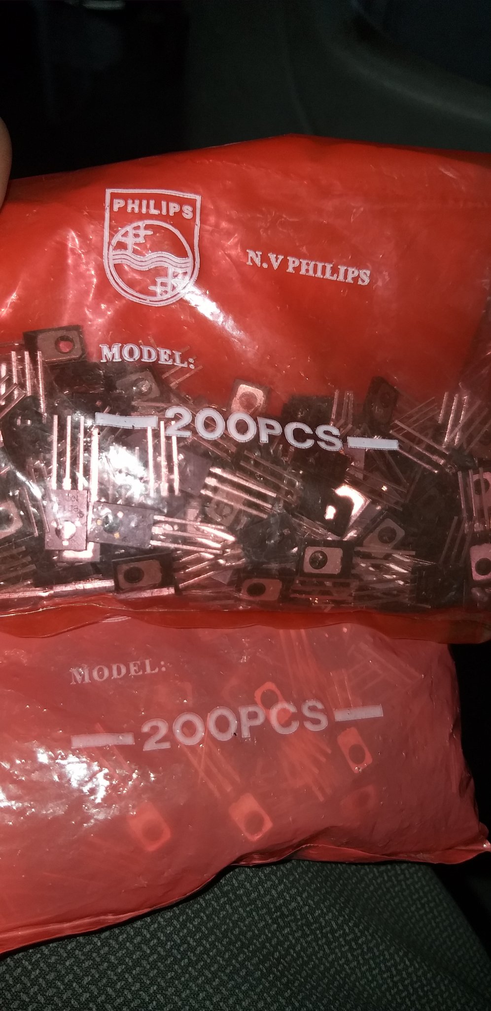

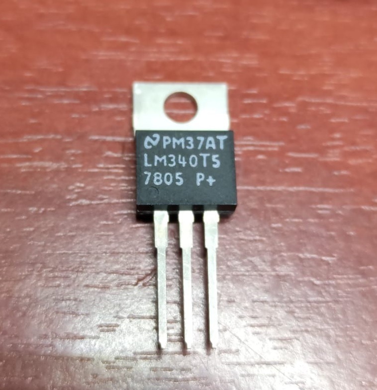

Real.Due to shortage of some elements I made a classic mistake and bought them on ebay 😳
Fancy packing but something rings my alarm bell. I have never seen this child like description before.
What do you think guys, fake or genuine one ?
Thank you in advance.

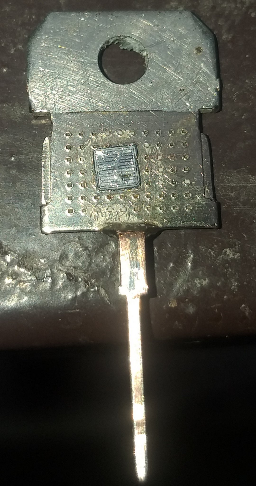

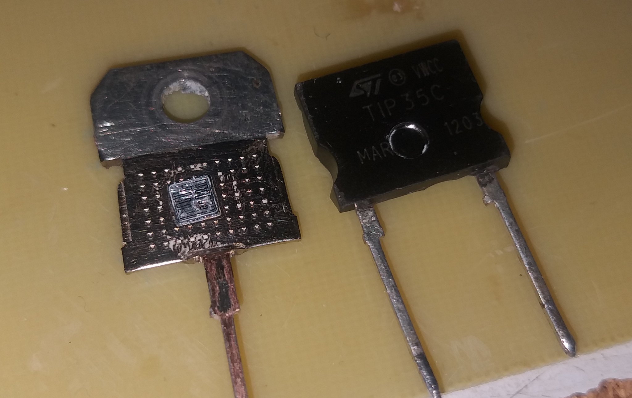

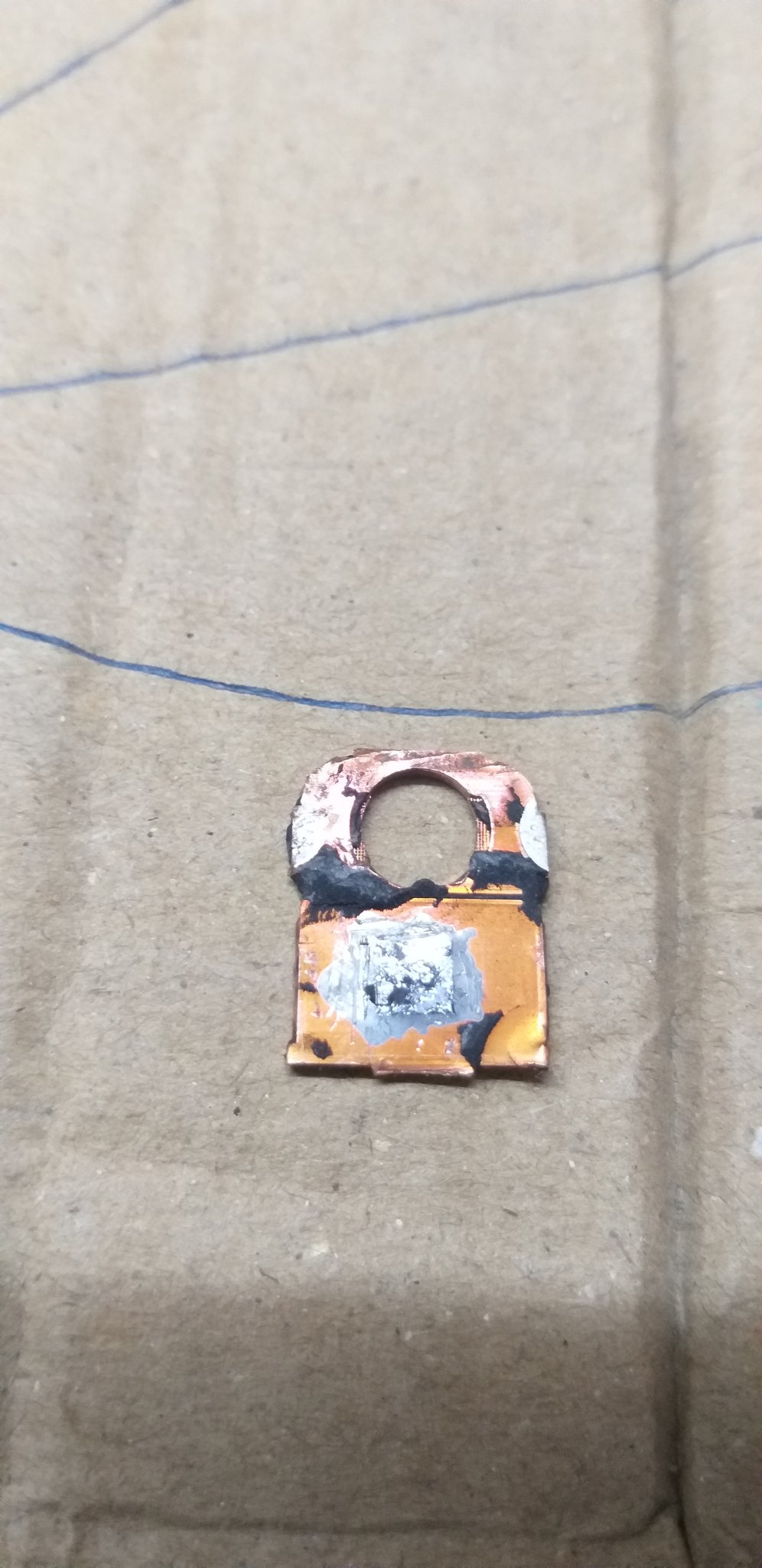

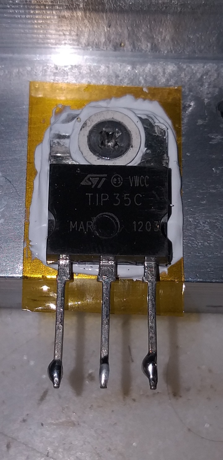

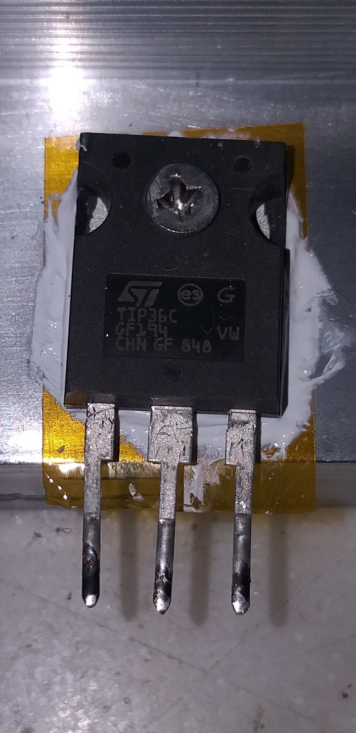

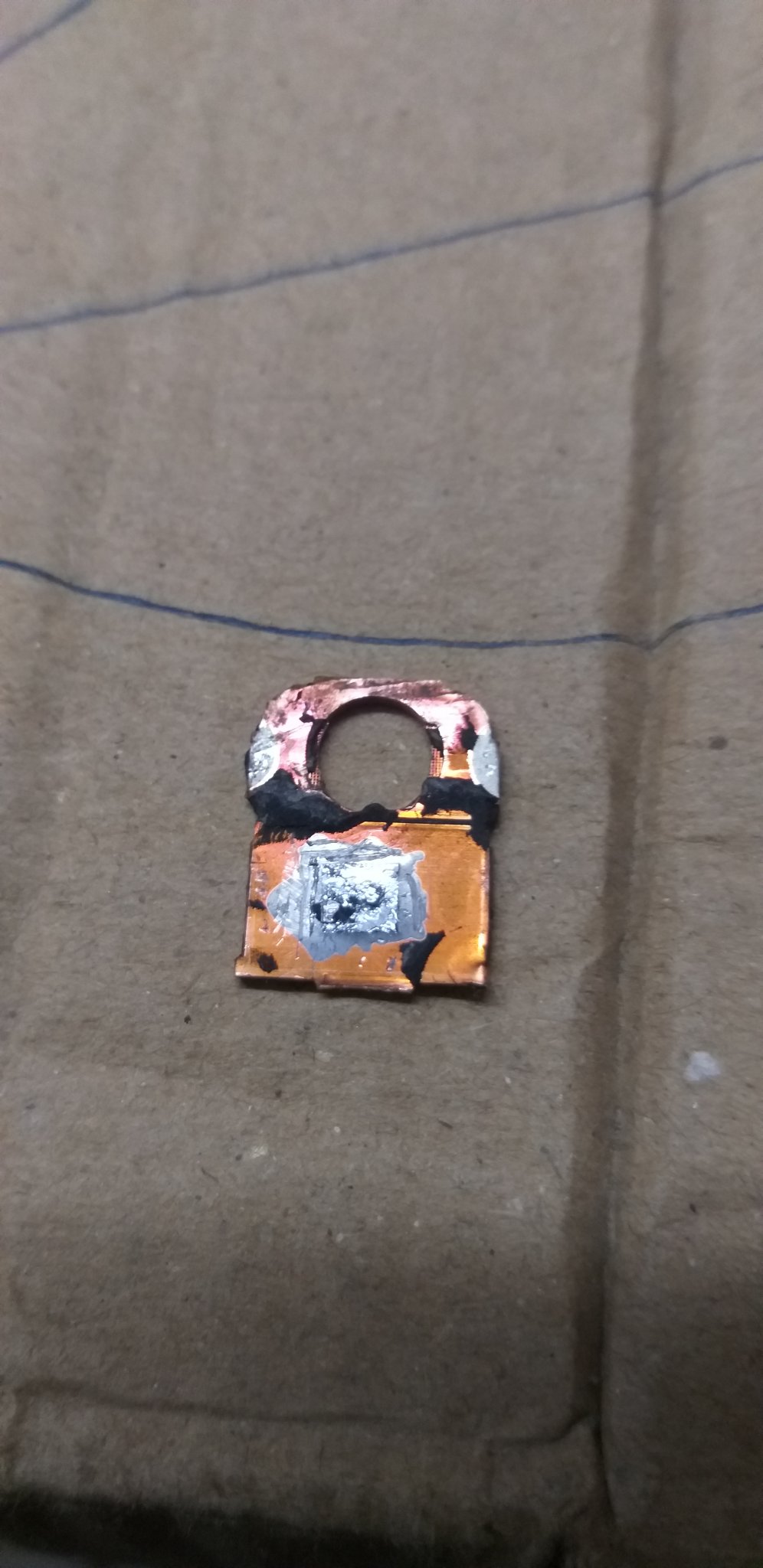

Recently bought some TIP35C/TIP36C, I wasn't able to get same type of body for transistors, I doubted that they were fake, so I break open them to see what's inside
Here are pictures
1.TIP36C (Original) die size 4×4mm
2. TIP35C ( not sure if original or fake) die 3×3mm
Tip35c die was covered by white silicone rubber
Tell me about
What's is wrong with tip35c, why 3x3mm die

That’s a larger die than they would normally put in a fake (2x2 or less). But the silicone and the package suggest fake. The TO-218 was discontinued a long time ago, before that particular leadframe or the e3 markings were in use. I have old ST (and SGS-marked) stock, some of it pulls from the 80’s and 90’s, and it doesn’t look like that, inside or out.

That's pretty much it, TO-218 obsolete back in 2012.That’s a larger die than they would normally put in a fake (2x2 or less). But the silicone and the package suggest fake. The TO-218 was discontinued a long time ago, before that particular leadframe or the e3 markings were in use. I have old ST (and SGS-marked) stock, some of it pulls from the 80’s and 90’s, and it doesn’t look like that, inside or out.
e3 marking still used,

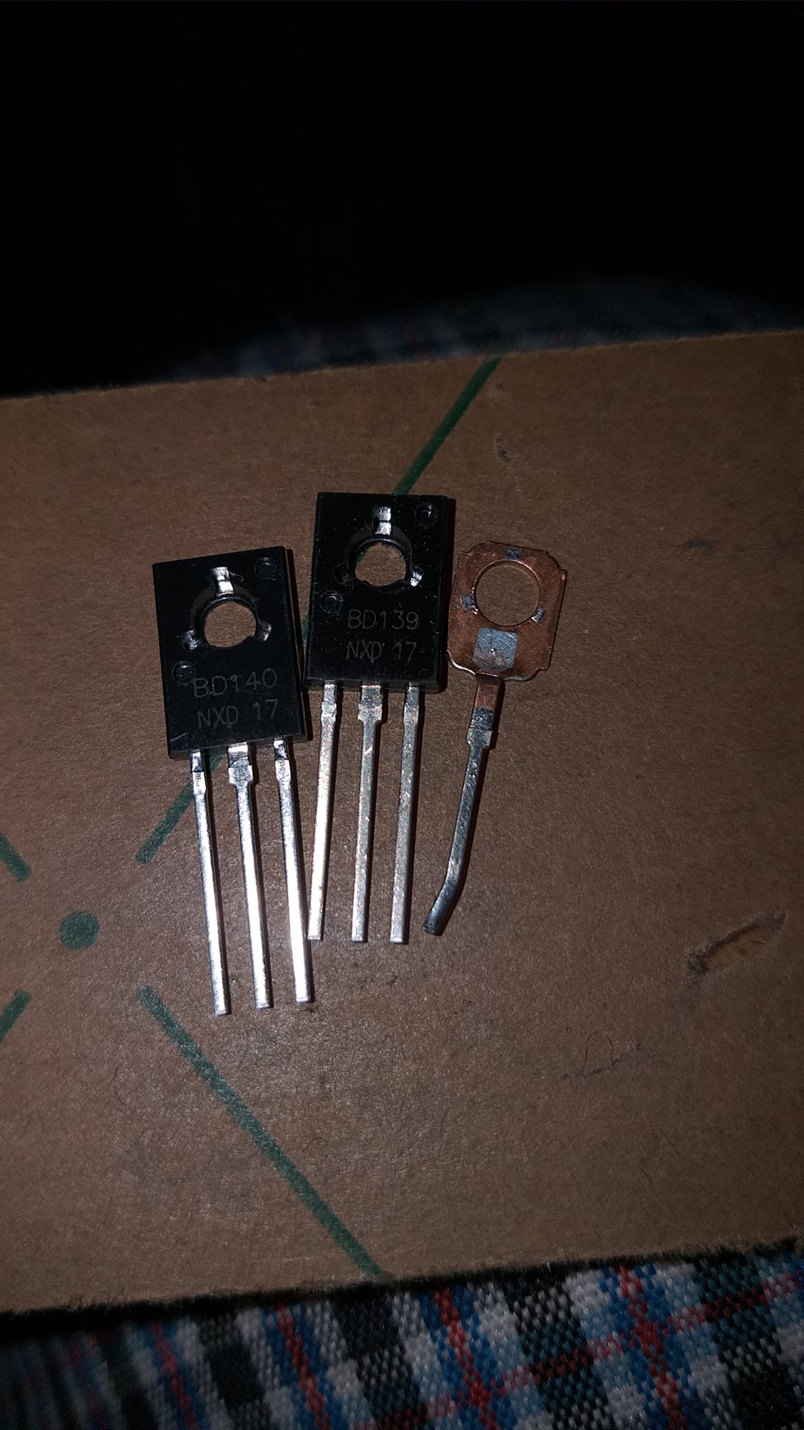

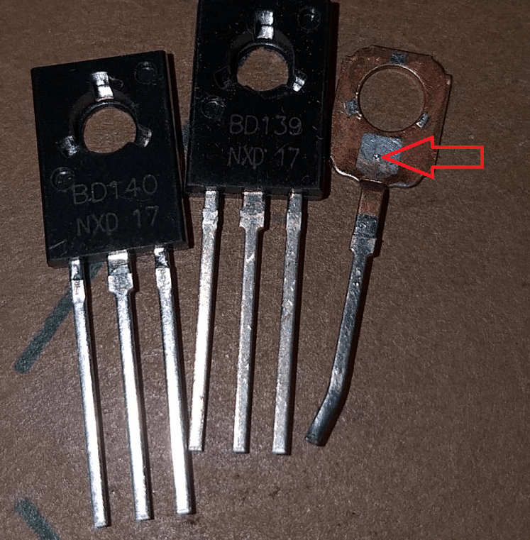

I also bought some nxp bd140 bd139, they were also fake ,

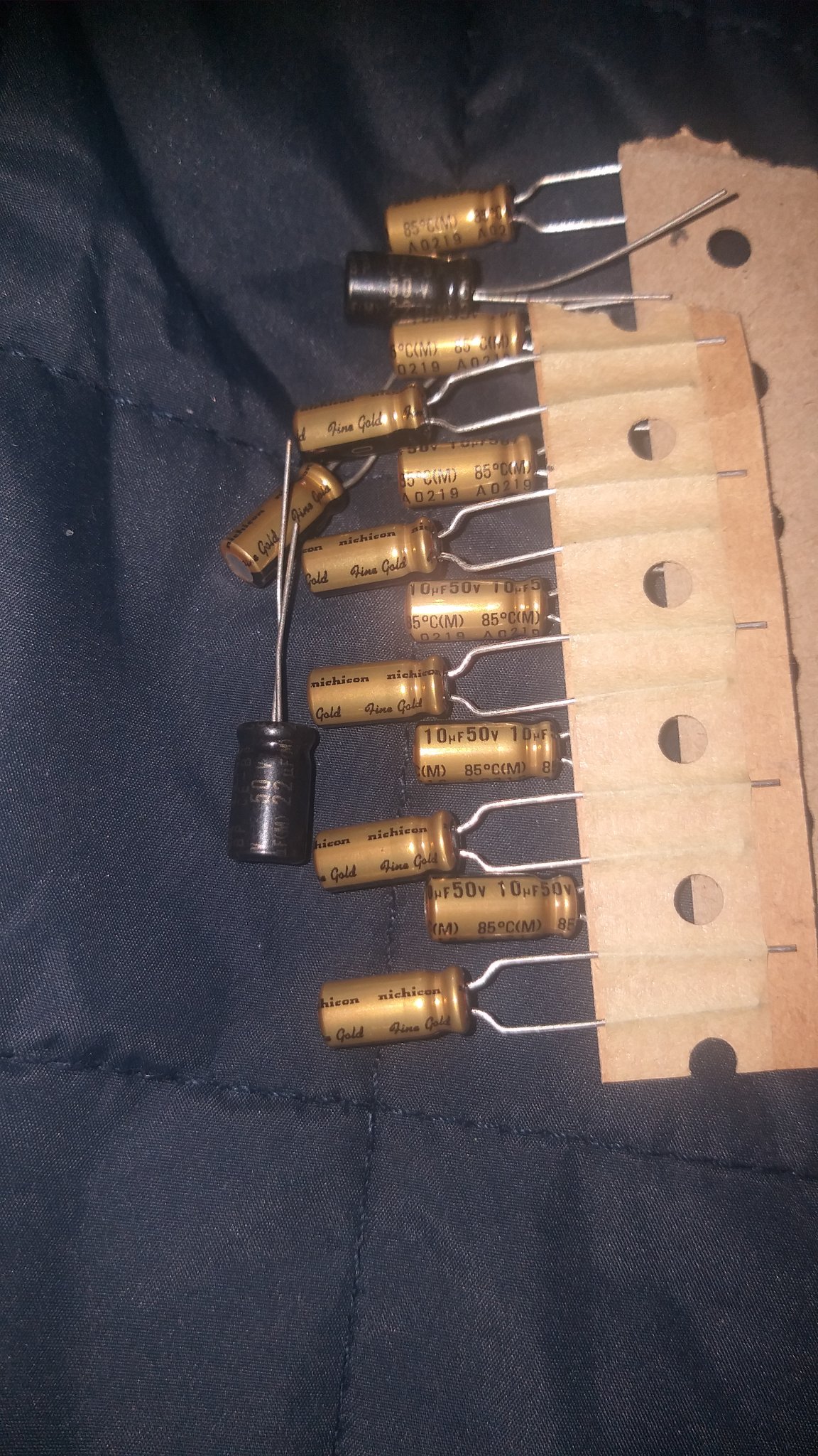

About Japanese electrolytic, 🙁 sadly I bought some 10uf 50v , they were cheap, I don't know what original or fake about them.

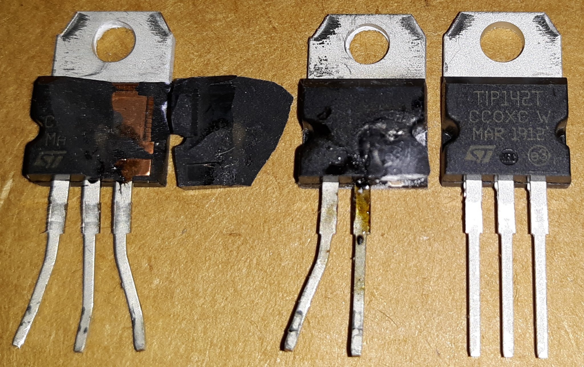

Here are the TIP142 fakes.
Any "special" or "audio" capacitors from the usual suspects are quite likely to be fake. Genuine ones are out of stock everywhere. Yet the fake sellers have plenty of low cost stock...

Those look convincing enough. But also bear in mind that the TO-220 version cannot handle anywhere near the power that the TO-3P version, even with an original die inside. You simply cannot get more than 20 watts of heat OUT of a TO-220, even if they rate it at 90 watts. You can pull 50 watts of heat out of a 3P. So it would not surprise me if those got overloaded - you wouldn’t want to run those over about +/-25V, even if you bought them from Mouser.Here are the TIP142 fakes.
10V 1A killed them in a few seconds bolted to a massive heatsink with grease. 100% fake. Current gain vs current indicates a tiny little die inside.
With the assembly of large quantities of genuine parts in the same locations the lead frames and packages are getting more and more identical to actual real production parts. Often the only indicator left is slightly different fonts and quality of laser marking along with actual electrical tests.
When these failed they emitted some sort of goo. You can see it on the center lead of the second of the three transistors.
Also, what do you think of the assembly location "MAR" instead of "MRC" or "CHN"? If you look carefully at the molded package there is "MRC" molded into the package yet the marking is "MAR". (Look at the tiny "MRC" molded in the last/third transistor all the way on the right.) Recent years Digikey and Mouser are marked "CHN".
Did they mark some genuine marts "MRC" and others "MAR"? I think these parts are now assembled in China "CHN". Can anyone confirm? Or does ST still assemble these in Morocco? Perhaps "MAR" is from "Maroc" (French)? But why mark some parts "MRC" and others "MAR"?
Really confusing if ST molds "MRC" for Morocco on the very same part that they mark "MAR" for "Maroc".

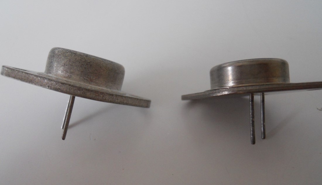

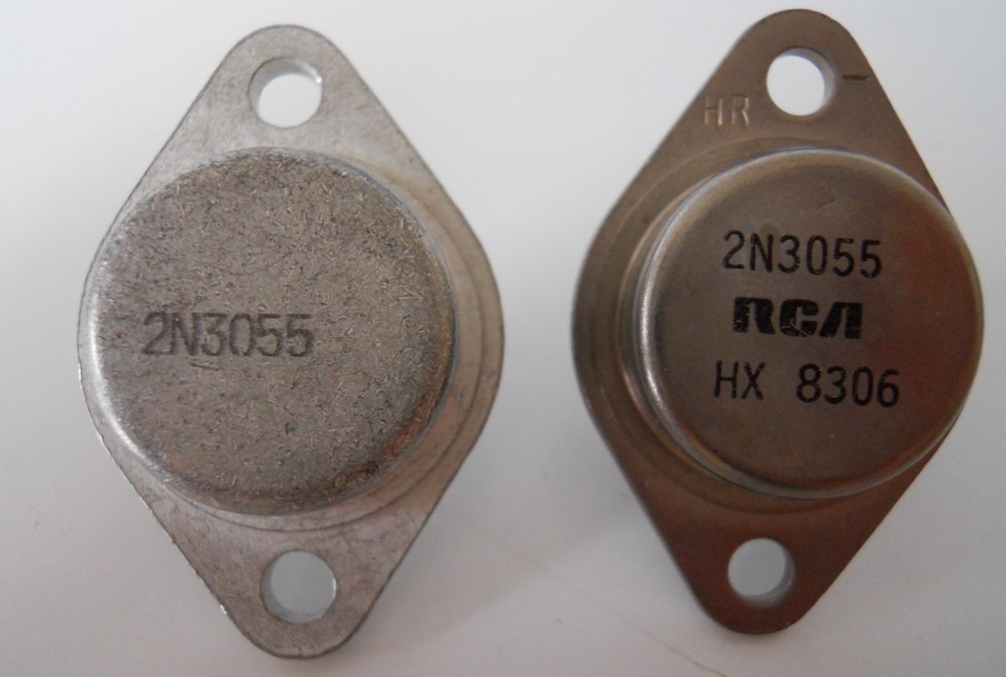

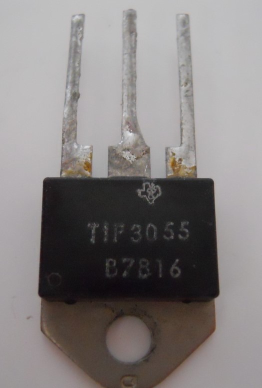

I like to find old parts like that - especially RCA’s - because you know they’re real. But that old TI version of the TIPs were notoriously unreliable. That was back before full encapsulation and eventually moisture would get to them.
ST either uses CHN or MAR markings (not MRC). Older ones either spelled out “Morocco” or “Italy”, before they stared using the China fab. Those predated the proliferation of fakes and still had the old “SGS” logo. There was also a brief period when they didn‘t have an origin code and they were still using silk-screened printing. That was right around the time when fakes started being introduced in general. Fakes were one of the big reasons they moved to laser marking and standardizing origin codes.
In my photo of the fakes you see both "MRC" (the three little letters molded into the package, third transistor on the right) and "MAR" on the laser mark.
Do you know if ST uses MAR for both the marking and the molded package? Or just the marking? (And then MRC for the molded package?)

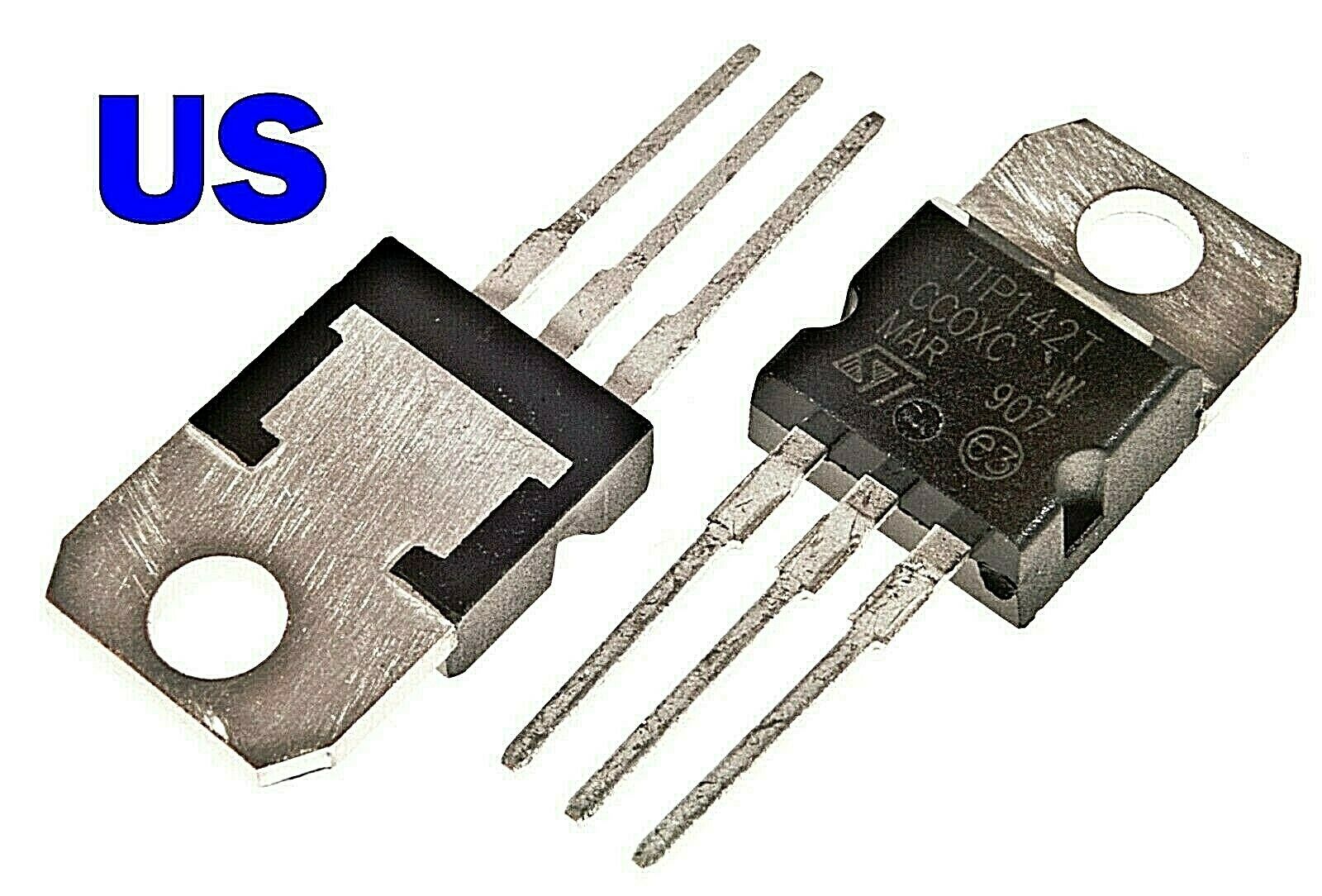

On the internet I found the attached photo of TIP142 with very different font from my fakes. On the fakes I received I think the font looks sloppy/odd (see the "2") compared with genuine parts. Also look at the "4" and the "9". Of course the photo I attached to this post from the internet might be fake too.
(seller been truthful and trustworthy before )

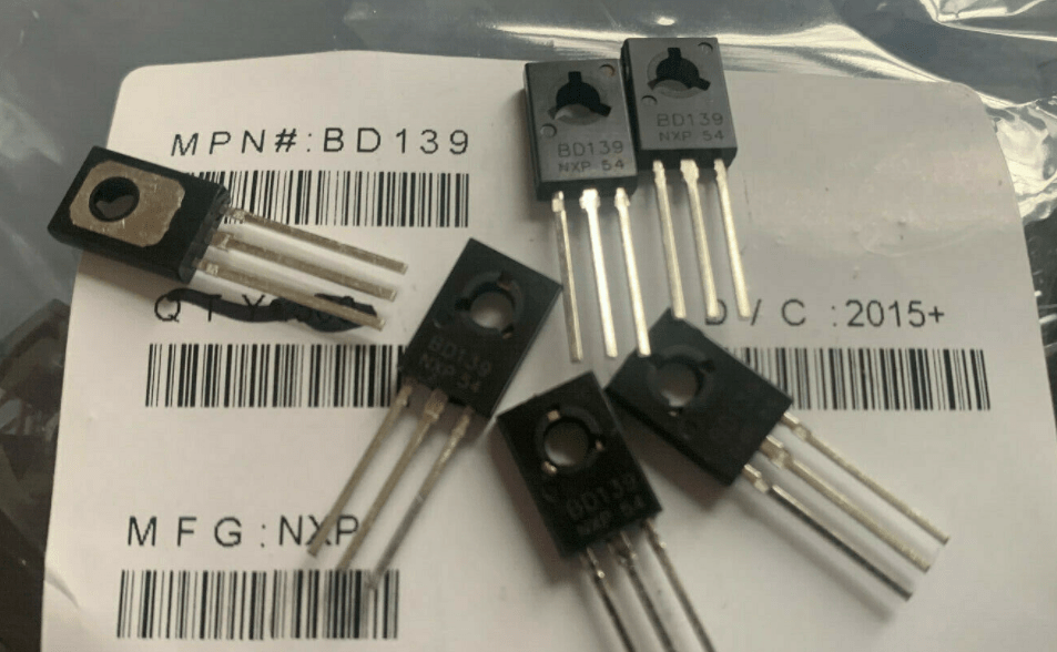

Seller said that these were original bd140 bd139, but I don't know what original or fake/counterfeit bd140 bd139 looks like,
So
Someone who else knows about these transistors, please let me know
So
Die size very small, I can't even measure it.
Probably it's 0.5mm or something less than 0.5mm
Does someone have real die size pictures for bd140 bd139
I see the die is not such a very small one, and looks like original.
