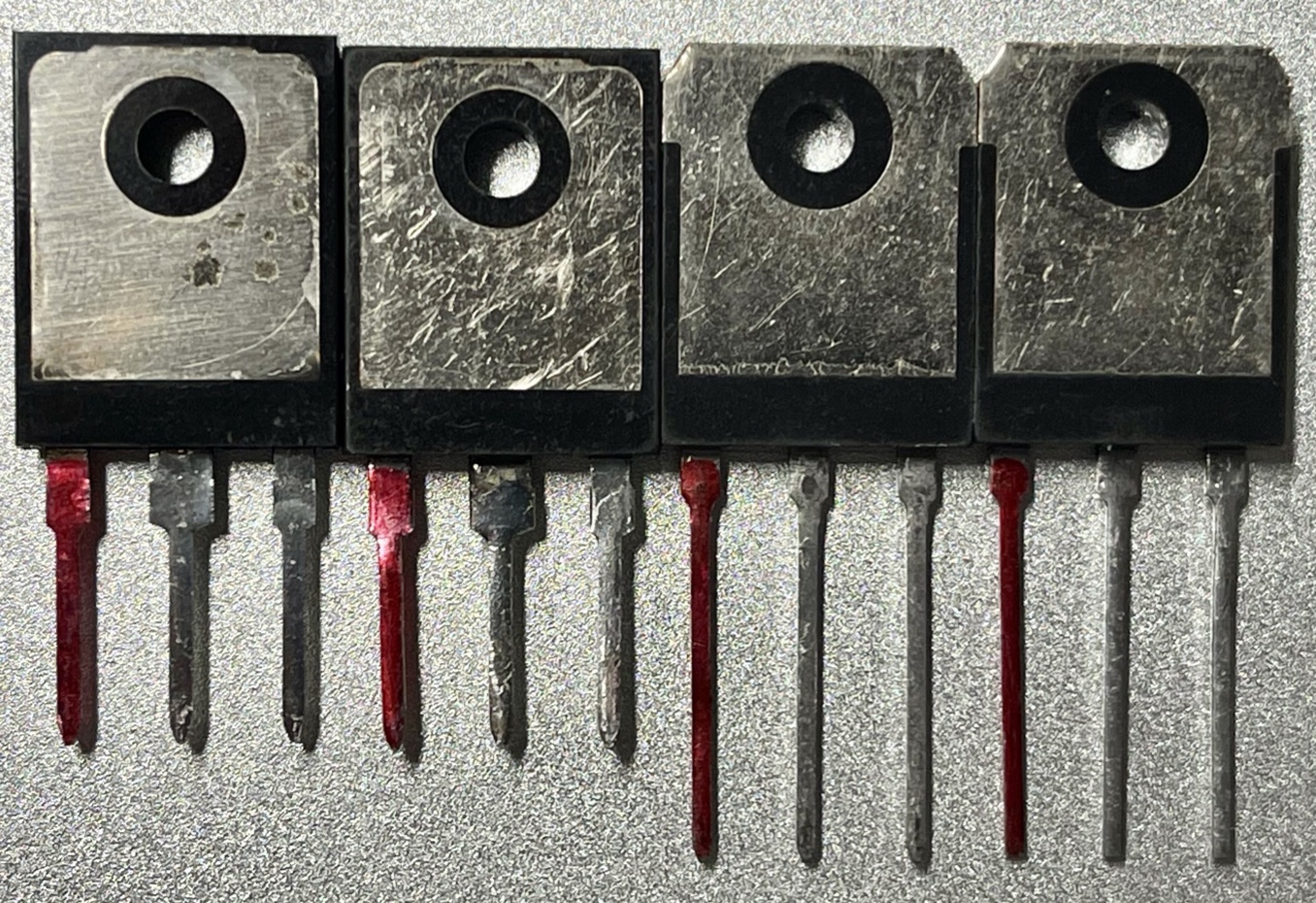

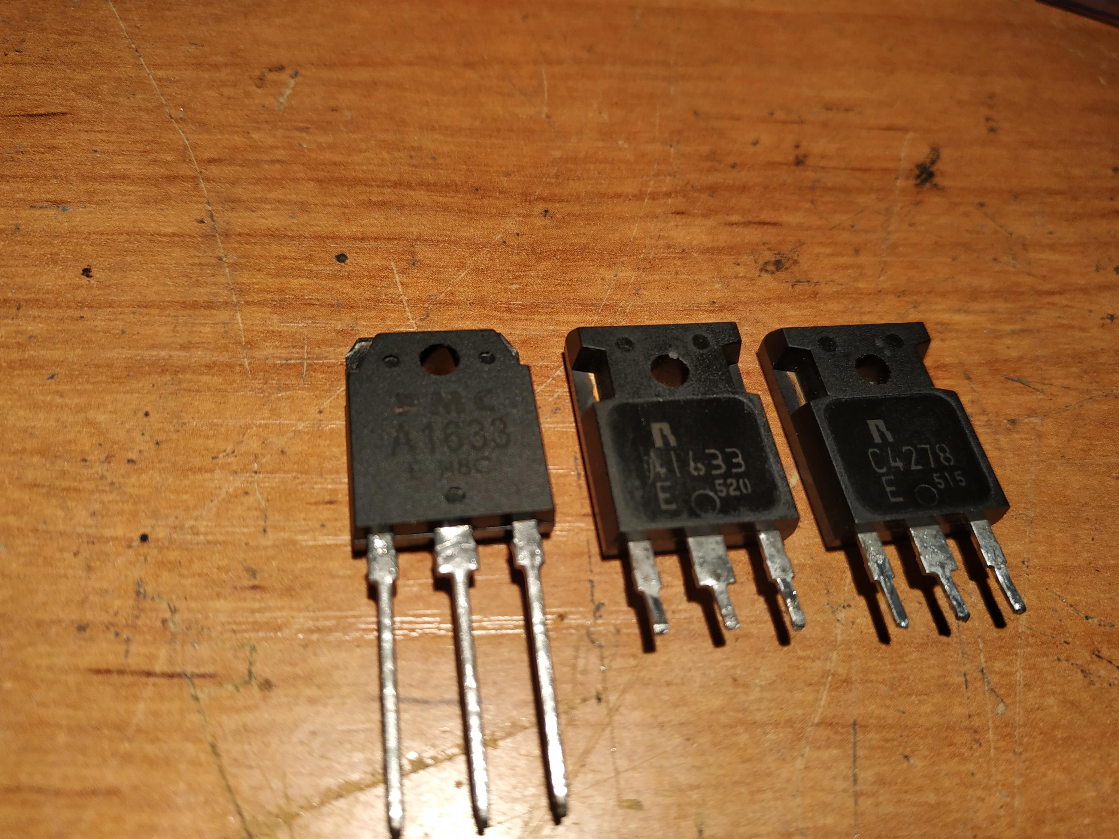

Repairing Thule Audio Spirit IA60B amp. Bought 2SA1633 by Rohm (as original) but receive PMC. According alldatasheet.com only New Jersey Semi-Conductor Products Inc. uses TO-3PN for this transistors. All another use TO-247. And no information about PMC. What is it? Another one chinese manufacturer and I can use this transistor?
I measured Hfe=94 (datasheet corresponds 100-200 for 2SA1633E and original pair 2SA1633E/2SC4278E has hfe 147/148).

Those packages look like many that I have received from Ebay and Aliexpress with just about any brand and part number you want on them. They have always turned out to have much lower current and SOA than they should. I concluded that they were all fakes with much smaller die inside. I don't buy them anymore. After the first few failures I started making test circuits/jigs. Pretty soon it was obvious that every one was a fake regardless of the part number or seller. Many of the sellers appear to be the same person or group with many accounts of different names.
For repairs I try to find some sort of currently available Sanken or Toshiba that will work and order from Digikey or Mouser.

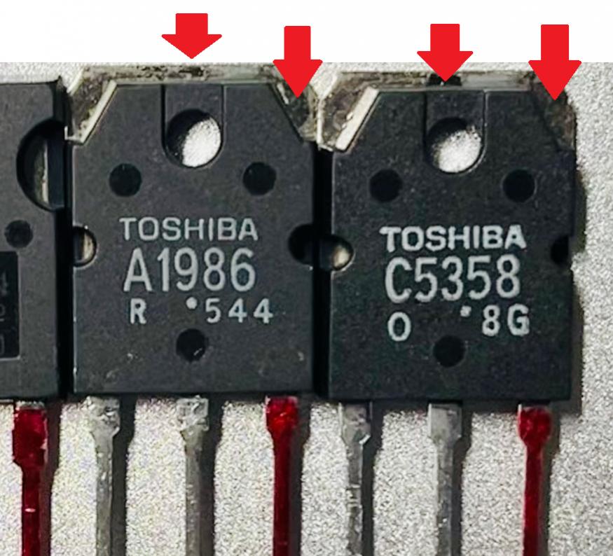

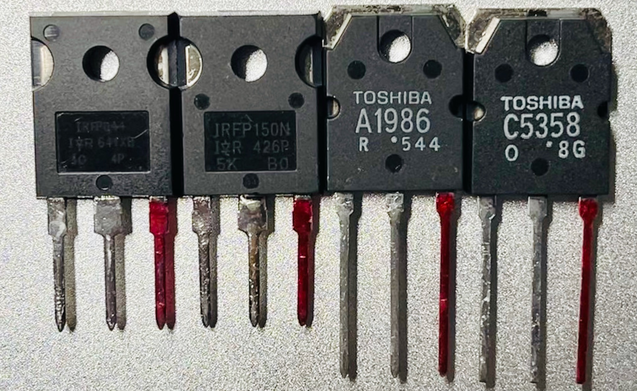

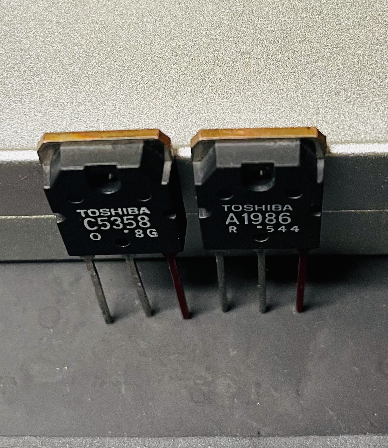

The mold flashing on the Toshiba transistors does not look like Toshiba quality to me. When I order Toshiba from Mouser or Digikey they look very clean and perfect.
If you are talking about the one on the left hand of the second picture, that’s an International Rectifier not Toshiba, its an IRFP044 and yes that’s the only thing I noticed, more like rust than mold and only this one came like that.
Interesting. Please ask on your delivery source (ordering address), from where they in turn bought the ROHM copies.Repairing Thule Audio Spirit IA60B amp. Bought 2SA1633 by Rohm (as original) but receive PMC. According alldatasheet.com only New Jersey Semi-Conductor Products Inc. uses TO-3PN for this transistors. All another use TO-247. And no information about PMC. What is it? Another one chinese manufacturer and I can use this transistor?
For this ROHM transistors I use as replacement parts such from SANKEN (2SA1294/2SC3263, order on Profusion). Your image I have upload here, because on imgur.com the image was delete someday.
Under "PMC" I have found this:

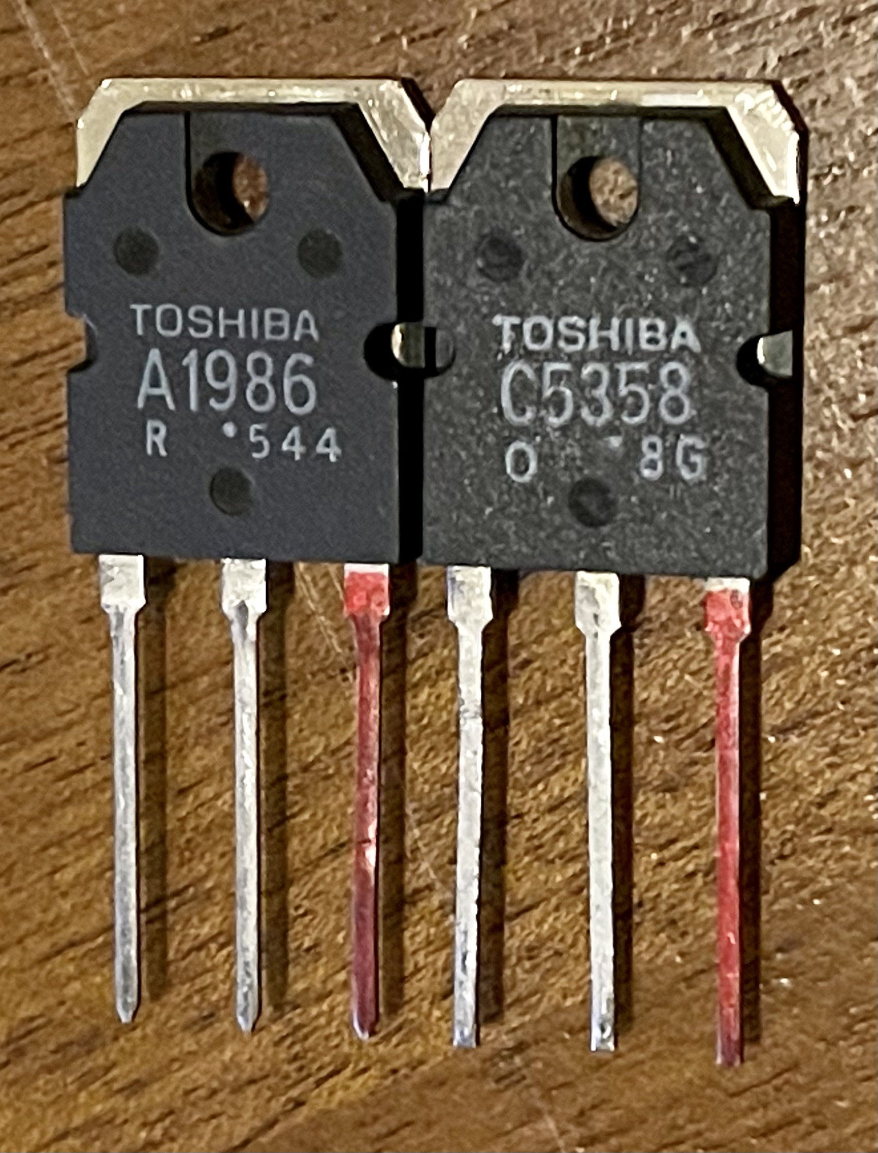

I see now, yeah those are reflections, I have seen what you are referring too but in small signal transistors where the leads came out of the case, here’s a picture with a better angle with indirect light.

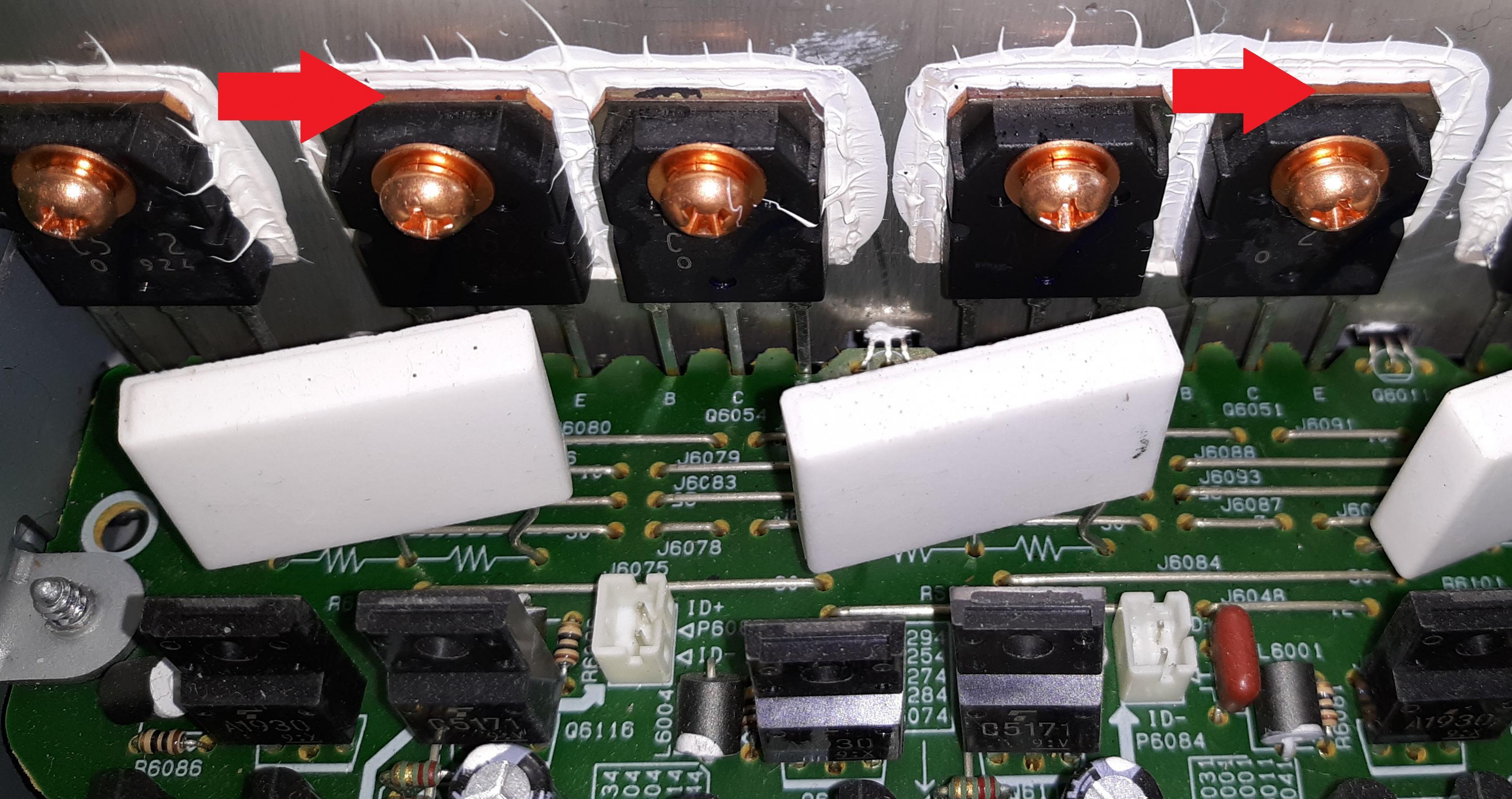

If you look at the edge of the tab is it a copper/copper alloy color? Genuine is a copper color as shown in the attached pictures of genuine Toshiba 2SC5242 and 2SA1962 in one of my defunct Onkyo receivers. To the best of my knowledge your 2SA1986 should externally look like 2SA1962 if they are genuine.
Unfortunately I can not get a better picture since they are still inside an assembled amplifier.
The copper based lead frame is a good sign. I guess it is possible then that they might be genuine. But they must be quite old stock given the marking technology compared with modern Toshiba manufacture. I am very suspicious when I see very old Toshiba stock with full length leads. Toshiba power transistors are very commonly faked. Especially the ones that are long out of manufacture.
One other check you could do is at Vce = 5V you could measure the hFE at the current specified on the Toshiba datasheet and see if that matches the hFE rank printed on the parts. One is printed "O" and the other "R". Fakes often do not match the marked hFE rank.
I would be careful otherwise with fakes you can blow the new outputs, the drivers, etc.
Oh well that was a good test, so I measured 3 each and the results aren’t quite accurate.
C5358 - O are supposed to be 80 to 160 Hfe and I got 60, 61 and 63.
A1986 - R are supposed to be 55 to 110 Hfe and I got 52, 58 and 70.
If you measured them at the datasheet Vce and current then I would be concerned, especially the O rank. Note that the very useful M328 tester is not really suitable for testing power transistors because the test conditions are far from the datasheet test conditions. (I mention that just in case you used that.)

I used Locky_Z Curve Tracer at +/-5Vce @ 1Amp to measure.
I have not used one of those but 1 Amp and Vce = 5 volts should give you a result close to the datasheet.
I have stopped buying power transistors from sources like Ebay and Aliexpress. My recommendation is to cross to a suitable currently available device and try that. (Being prepared to measure and set bias, etc.)

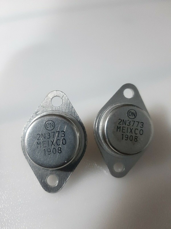

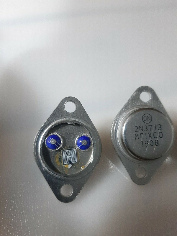

These are currently on offer on Fleabay.
Anyone spot the error ??
ARE THEY GENUINE ?
.Matched Quad 405 Replacement 2n3773 Transistors,best quality ever | eBay
