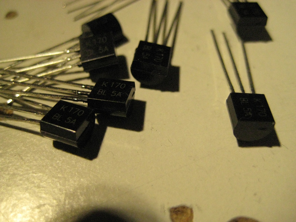

Hi all,
We all know that eBay if full of fake J74/K170.
Anyhow I went and bought some from Germany. 20pcs for like 15€ to be exact.
I must say I have not seen this kind of K170BL before.
Thickness: ~3.65mm
IDSS: 14-19mA (on the 4 I measured so far)
Yfs: 30-35mS (tested 2pcs, 200mV change in VGS gives 6/7 mA change in IDS 6mA/0.2V = 30mS, right?)
Laser marking looks like top quality. There are no signs of sanding. No tiled front e.g.
Burr is not Toshibalike. (long and centered) It is short and towards the side, but also pretty much all around the device and thus hard to distinguish from photo.
If you look at the leftmost 2 you should see the burr on top of the devices.
I have received fake toshiba JFETs multiple times, but Yfs has always been way below the Toshiba specified 22mS typ.
What could these be???
Not many JFETs have that high Yfs.

But there is the difference that WalterW measured (like I in every other case did) too low Yfs.
And yes, IDSS has a tendency to drop like 1 mA when these weird devices heat up for me.
I bought the same, 10 pieces in China for around 6 Euros with free shipping :🙂
They measure all around 15,5 - 16,5 mA Idss, 2 are 14.5.
When I change the Vgs 100mV they lower from 15.50 to 12.35mA.
So around 32mS!
I was surprised for that high Yfs indeed.
Also the 1 in 170 is like this: 1 and not like this: l .
So good looking fakes, BL is never 15-16mA.

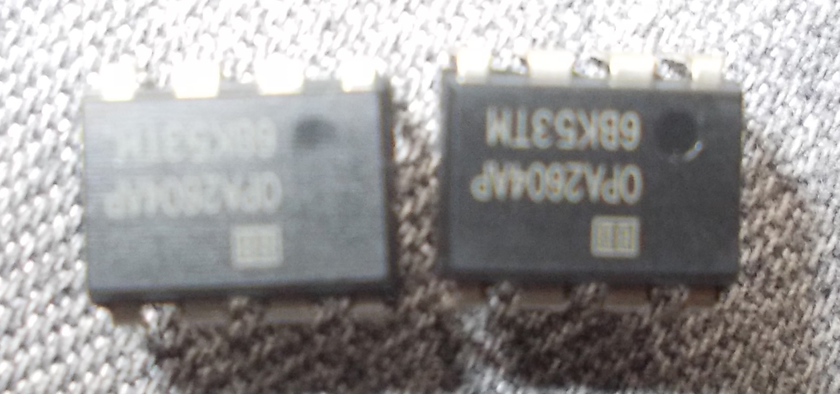

I get opa2604 but I am afraid these are not original because there are signs it is reprinted.
better picture I can not make. Came from eleleparts ebay seller from china.
regards
regards
They do not look bad in the photo, but looking at the sellers prices (fraction of official dealer cost) they are probably fake I'd say.

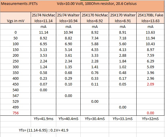

Today I received a package from NicMac who sold the strange looking Toshiba's JFET's.
In it was one 2SK170BL and one 2SJ74BL.
I have measured them both and compared them to a matching Idss JFETs from my personal stock.
And sorry NicMac, you are right, they are real Toshiba's!😱
Tomorrow they are both going back to Italy 😀
The JFET body is exactly the same size, pins are the same, the stripe at the top is in the middle. They look good. When I place them in my test jig Idss rises also, which is good.

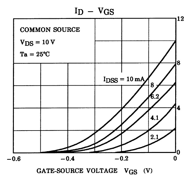

Have a look at the numbers, I measured the Id - Vgs in 50mV steps.
The Toshibas are cut-off at around 500mV that is according to the datasheet. See picture what I measured.
Look at the fake it is cut-off at 750mV! and Idss is above spec.
