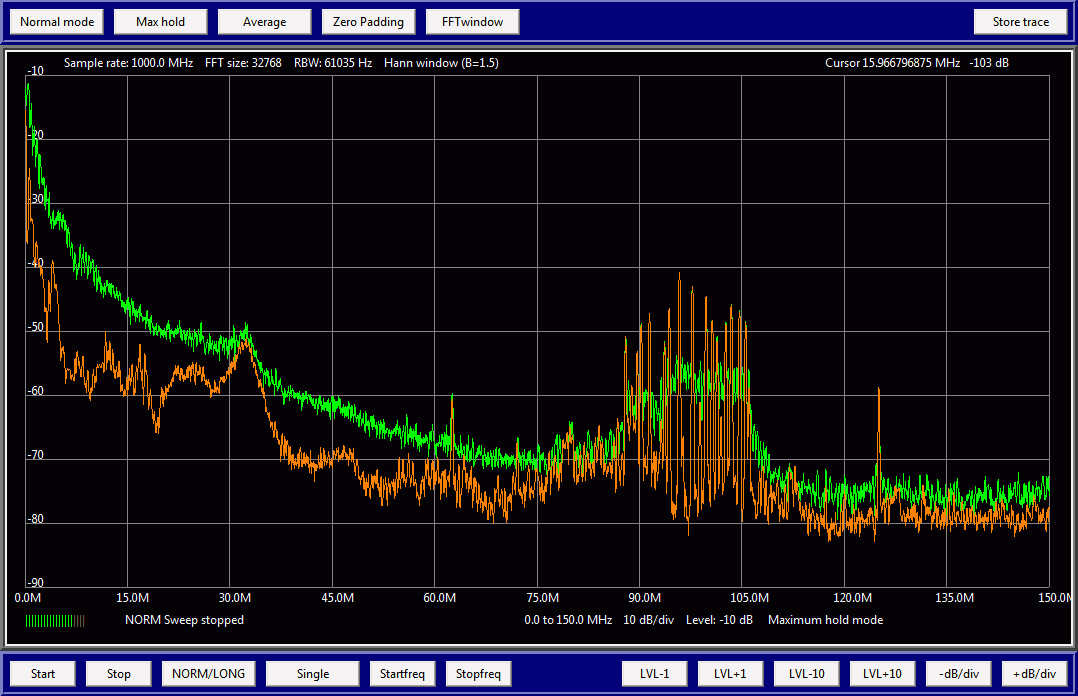

Just for curiosity, this is a XL6009 boost converter powering a switched load (at 20Hz) in a distance of 10cm (3x18650 11V -> 36V), with batteries between sight picked up up with a 15cm wire-antenna at the scopes input...
Anyone ever complained about smps radiation?

yes would be a conducted test. (fixture required)
They always require at minimum a ferrite line clamp or in severe case a seperate pi filter.
better ps have on board filter. the ps could still fail radiated test.
Antennas for radiated emissions are always calibrated ,Usually a log periodic.
Im not sure the scope probe on wire is telling complete story.

Might be, this was just a quick test on my desk.
We have all thos EMI/EMV stuff at work (SA, Antennas, Probes), but actually not a proper room (chamber) to do calibrated tests. Measurement services aint cheap here in town, not even for students.

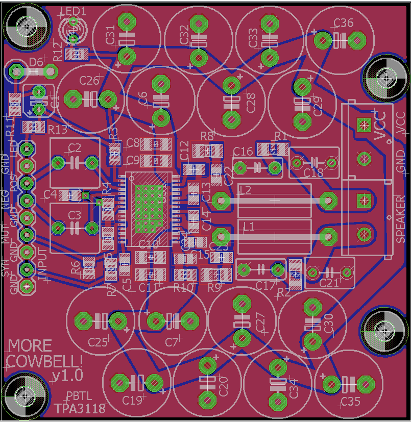

So, in my mind, I always think, emphatically, More OSCON! And that immediately makes me think of the "More Cowbell" SnL skit. So I created yet another variant of this tpa3118 board, lovingly named More Cowbell.
How effective this amount of decoupling is I can't say. But given the way these PWM amps operate, I think there is a real benefit to getting power as clean as possible. I've seen other members use significant amount of capitors to provide clean, low impedance power to circuits (Abraxalito, I'm looking at you). So I figured why not?
The other limitation of these amps, discussed recently in this thread, is the matching of output filter to speaker load. So here I present a minimal ferrite bead filter. This assumes a very short run between amplifier and speaker, of course.
I envision these being used as monoblocks in a relatively low-power design. Specifically, I'm thinking 12v supply. Per the datasheet, with a 4R load, max power will be 20W (at 10% distortion, so you'll never actually go this high). At 90% efficiency the power supply only has to be capable of about 22W... Call it 24W for a little headroom and the convenient fact that there are a million 12V/2A power supplies available. With these modest current requirements, a very low noise power supply shouldn't be too hard to come by (and hopefully gets a further boost from the onboard caps).

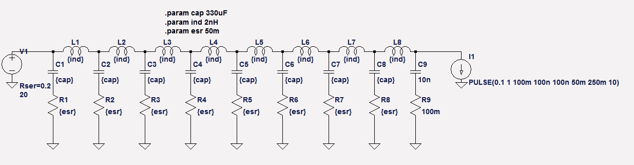

I'd say, it's "useless" from what the simulation says.
The voltage drop is domintated by the supplies ESR/resistance as the capacitance, even with 8x330uF, is still not enough to hold up the rails. Abraxalito is using a lot more capacitance, so a benefit is seen. With 8x330uF, the holdup time is less than 2ms for 1A current. Voltage then drops by 0.2R*1A in this example. Even then the rails voltage dropped by only 200mV or 1%.

Just now I was looking at Panasonic 16SEPF1000M. This should work for a 12V supply; the cap is rated 16V, and 1000uF. Also, ESR is 0.012R (versus what looks like 0.050R in your sim). Does that improve the sim at all?
...Or, how about this: United Chemi-Con APSG160ELL222MJ20S. 16V, 2200uF, 0.008R ESR.

Not much at all. Keep in mind that ESR is measured at 100kHz, it's supposed to be higher at "DC". Compared to 100kHz and up, frequencies under 500Hz is "DC" for the cap.
Things will change from 100000uF and up. So assembling some more caps to get 0.1-1F with low resistance/inductance would do.
Will you hear it? Probably not.
