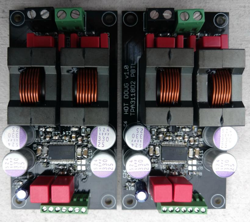

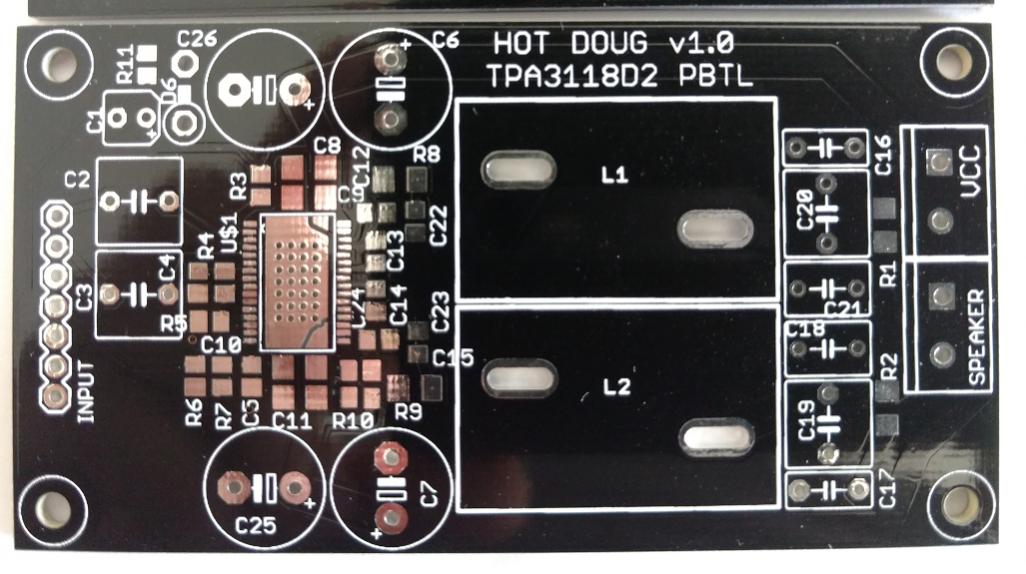

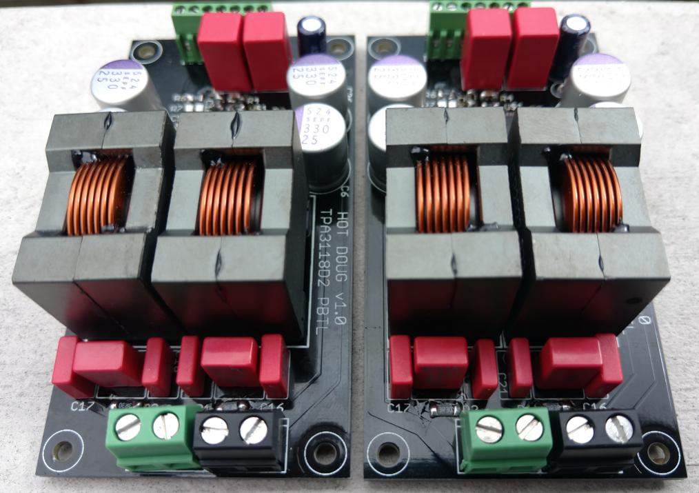

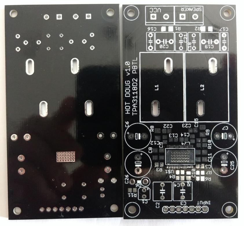

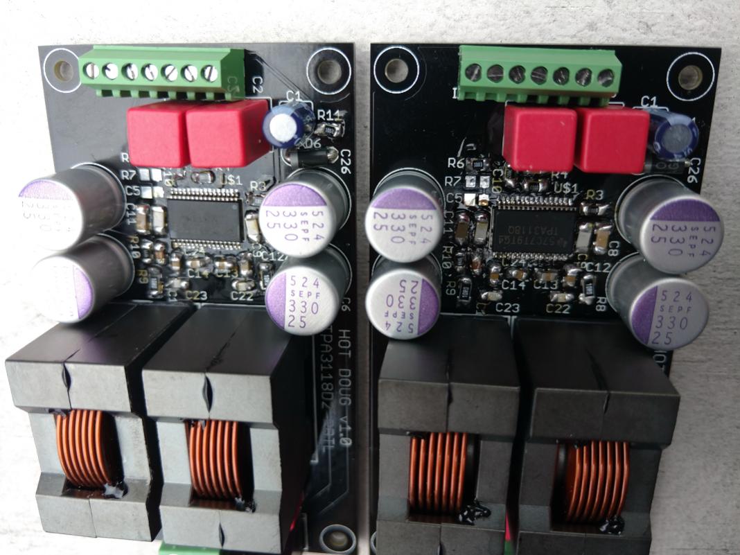

Just to bring a bit of closure to this little project: the main point was to introduce myself to board design. And in that regards these are a huge success. At the end of the day, this design is really just a tweak of DUG's design. The schematic is identical to DUG's, except for the addition of two power supply decoupling capacitors. All the component values use the same identifier (i.e. R1 on this board has the same function as R1 on DUG's board).
Because this is literally a first design from a novice; and also because DUG and GMARSH have excellent group buy boards available, I assumed no one would be interested in these boards. And indeed, so far jfetter is the only one who's shown interest in actually getting these boards.
But in the spirit of being an "open source" project, here I'm posting a few things for anyone who might be interested in this project:
Thanks again to everyone who helped me with this design!
- BOM, in three formats: CSV, PDF, and ODS. Content is the same in each file, I'm providing three formats for convenience.
- Eagle files: the SCM and BRD (schematic and board) files.
- Gerber files: in case you want to have them fabricated. I had the fab done by Elecrow without any issue (under $20 shipped to USA for 10 boards!)
- And some pics of two finished boards

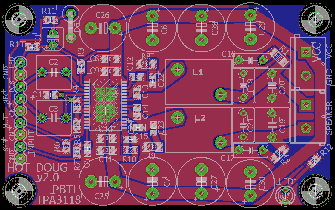

While I love the deliciously overkill Coilcraft VER inductors, they consume a significant amount of board real estate (and are expensive and only available directly from CC). So I tweaked the design a bit, here's version 2.0. Changes:
Too many projects in the queue right now to actually fab and experiment with these. But if anyone is interested, let me know and I'll provide any desired files.
- Use ICE Components 1D14A inductors instead of Coilcraft. Cheaper, smaller, easier to get, but still with decent specs.
- More power supply decoupling capacitors. Save money on Coilcraft inductors and spend it on OS-CON capacitors. 😉
- Overall reduced board size, 70x44
- Added an on-board LED
- Added a header pin for an off-board LED
- Actually labeled the header pins/terminal blocks
Very nice - looks like brute of a TPA 😀
I personally, think the CC's are the main badge of honor on these amps so would keep them.
These look really awesome, excellent work! But, Matt, we gotta know...how do they sound???
Well, to be honest, I haven't done any critical listening with them. 😱 My main goal was to familiarize myself with PCB design and actually produce something that works. And in that regard---thanks to much hand-holding from this community---it was a great success. (Also, thanks to Gmarsh's tips, I now having experience doing reflow soldering via frying pan!)
That said, at least with casual listening, I don't hear any obvious flaws. In fact, I'm a little scared to attempt any true critical listening with these, for fear of extreme "baby bias" (they are my babies, after all).
Also, basically as soon as I validated that they were working, I shifted gears to focus on DACs. Some day I'll circle back to amps. 🙂
Ha, fair enough. Well you definitely did a great job, and it's always fun to pick up a new skill. Do you have a BOM? I might be interested in building one if the cost isn't too great.

By the way, all the above applies to the v1.0 board. The v2.0 board that I recently posted I haven't actually had manufactured, nor have I created a BOM for it (although the bulk of it is the same as v1.0, just a few tweaks).
