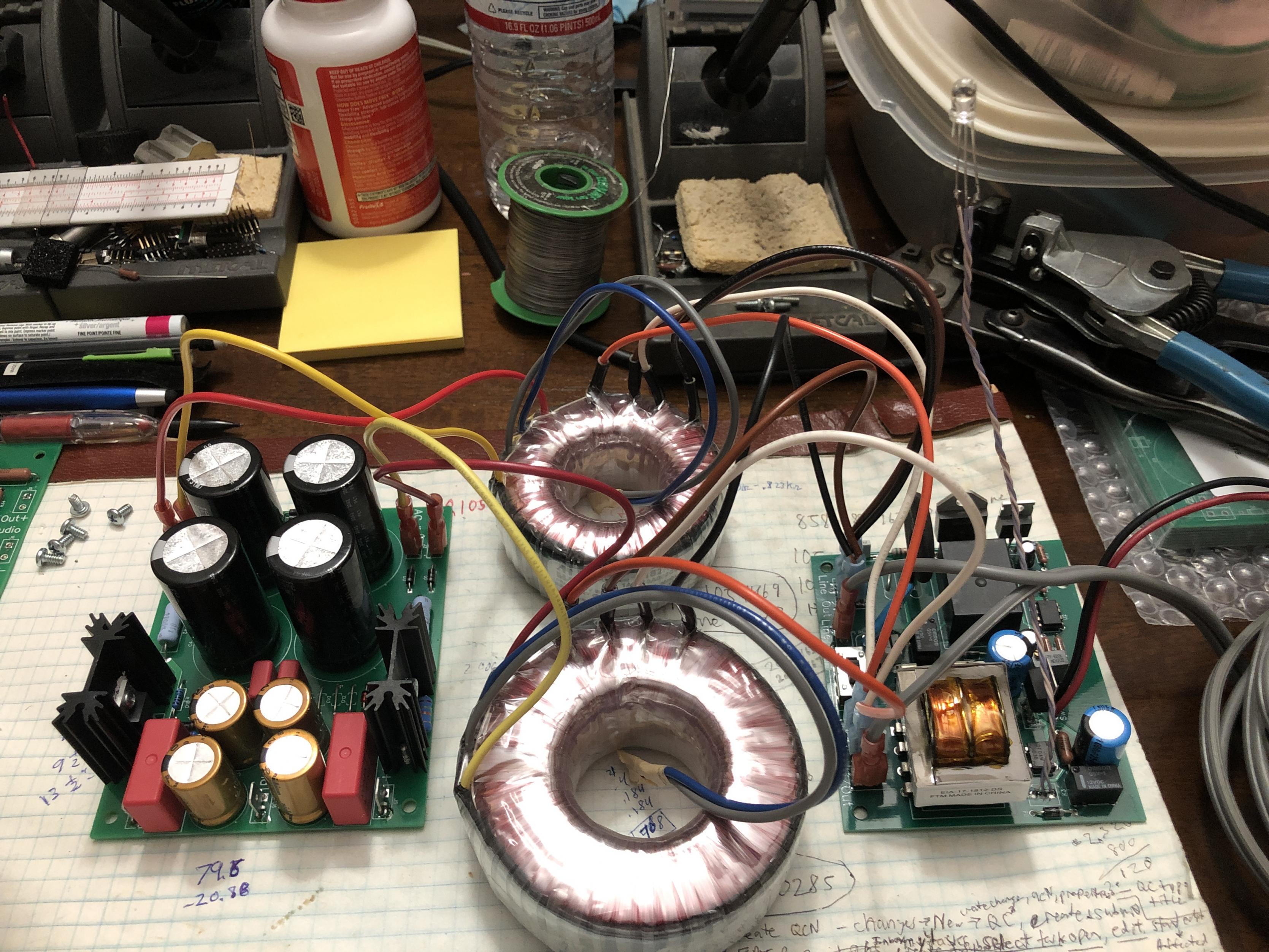

I built up a couple of the PS board, connected the toroids to a soft start board for first startup and it came up without issue. I used 24 volt and 75 volt Zeners and the voltage stabilized at 79.6 volts and -20.9 volts. The plus side seems a little high, especially since I used 80 volt caps. Will try lower voltage zener.
Also was I supposed to use two sets of toroids? One set for each channel. Over kill? I like over kill. 😁

In anticipation of my new PS boards that are arriving this week, I have been doing a little work in that area with some Antek toroids and found similar issues. I purchased the 50VA 35-volt versions and tried two (100VA) in my initial testing and had results like yours. at 79.3V into my test load of 809R. That should approximate a single amp board’s expected draw of around 80 mA at 70V output. 80V would give it closer to 100 ma. I checked my voltages closer to what the 4700uf filter capacitors see and it was reading 96.3 before the CRC filter and 93.1 after the 27R resistor. I was also reading 83.9V at the “75V” Zener. The amp heat sinks were quite a bit warmer than usual after a few hours when I put a pair of amp boards in.
I removed one of the 35V toroids and this reduced everything around two volts across the board, but it was still high with 77.2V output and 82.2V at the “75V” Zener. I took two lessons from this.
1. I, like you, used “75V” Zener in my boards. While I don’t have a DC power supply with a voltage high enough to test it directly, these are not 75V Zeners and either are yours. At 2% tolerance they should be in the range of + or - 2.67V. This should give us around 77-78V at the Zener and 73-74V at the output. I have noticed, however, that Zeners will rise a bit if you increase the voltage enough. If you are getting 79V at your output, guess what voltage your 80V filter capacitors are seeing at the front of the CRC!
2. The 35V toroids that I was using are overkill. Looking back at the early power supplies for this system, they were using 30V toroids which should generate about 76-77V after the CRC filter, which would provide a small buffer for line variations. I ordered the Antek 32V 50VA (AS-5032) toroids, which should be a good compromise. My line voltage is 122.5Vs in my house addition with modern wiring, where I do most of my system testing, but drops to 120v in the 1950’s section where I have an office and do most of my building. I have recently pulled out my father's old Powerstat variable transformer that should easily be able to provide 5A into that voltage range which will allow me to test the boards at various AC voltage levels. I have also purchased several lower voltage Zeners that I can test directly with my DC power supply and build my 75V that way. While I have been seeing 75-77V V+ with my existing PS boards, I would be happier getting closer to 70V.
Interestingly, my original toroid’s, purchased during a group buy back around 2005-6 were 30V and with two Power supplies, I was getting around 75V V+ loaded and 80V unloaded.

I used 30x2 volt toroid which is putting 85 volts at the input to the CRC. So I will look for 27x2 to 28x2 volt toroid and try a 68v zener. Lower volt will be safer on the Caps and produce less heat. And will try 10k bleeders. 🙂
Was that 85V under load? You normally get about 1.31 times the AC voltage under load. That is over 1.4 times the nominal AC voltage, which you might get with no load. If you are under load, what is your AC volt output? Is your line voltage high? That doesn't seem right.
