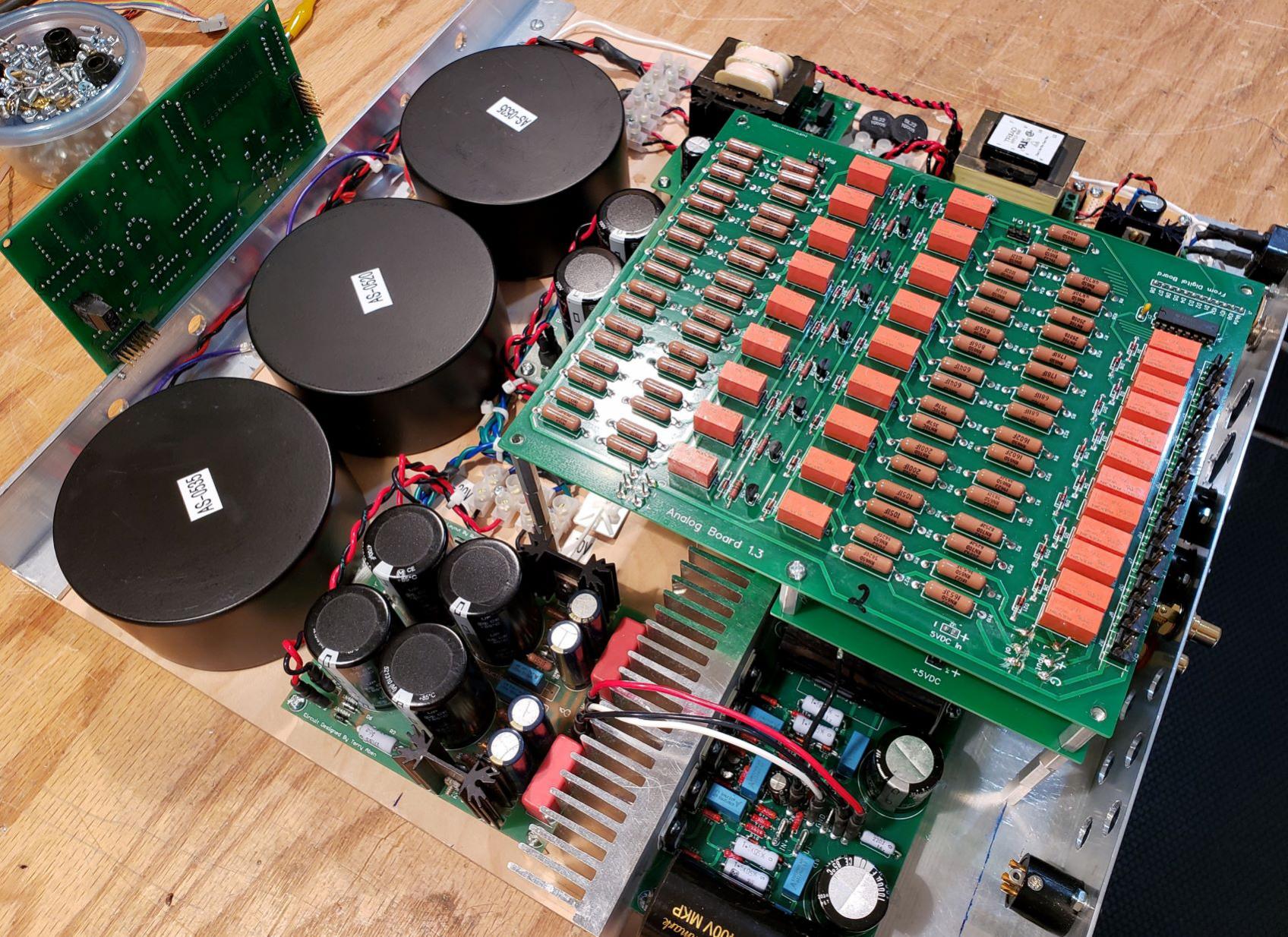

John,
The PCB Looks good to me. One thing that I think you should add is bleeder resisters, particularly across the +70V side. There is nothing to drain the 10,000 mf on the PS board or the 2,000 mf on the preamp board. That potential short just sits there waiting to zap you or your boards if you try to remove them without discharge.
Looking at the BOM, the Hammond transformers are pricy at $107 for the pair if you can find them in inventory. A lower priced option might be the 25VA AnTeks. The AN-0235 and AN-0225 are $24 and always seem to be in stock. If you want to go with the typical DIY overkill, you can get 2 AN-0535 and a AN-0525 for $57 to give 100VA for the +70V side and 50VA for the -20V. Further, they come with a shielding wire, while the Hammond doesn’t and the 50VA models have steel cases available as an option.
Roy
