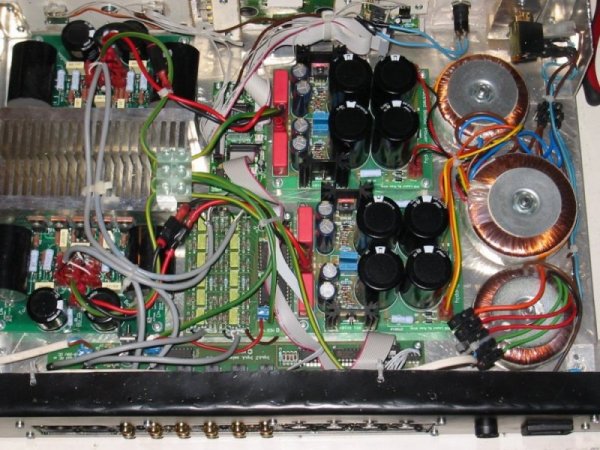

So, it's been a while, and I've been getting tires of having "free-range" stereo equiptment playing from the workbench, so I am finally finishing up the case (cage) for my X-BoSoZ.
I am using a Darwin SS and JT attenuator. The wrap on my trafos had somehow started to unravel on me a bit (from being shuffled around the workbench too uch I guess), so I wrapped them in Scotch Super 33 electrical tape. I think they look pretty nice that way actually. Might do that more in the future...
Anyway, I got my brother to do a little CNC work for me for the rear panel. Now I just need to find a few more sources 😉
Brian,
Do you think your aluminum dividers are thick enough? Why not just go with 1"
Looks great,..I'm jealous. I don't have a brother that's a machinist🙁 Come to think of it, I don't have a brother.
Joined 2002
Thats the same chassis i have except that the rear panel is removed and changed. LOOK's good tho 😀
Thanks!
He did this work on a CNC at work, but actually just bought his own for his house (!).
The case is from Par-Metal. We were actually throwing around the idea of offering pre-machined rear panels to fit their standard chassis sizes (12x3, 16x3, 12x4, 16x4) to go with some of our kits... 😉

How are you guys managing connection to earth?
I finally wired this up into a chassis and for the first time actually have wired earth into the circuit and now I get a nifty hum. Of course, I'm also running it with different amps (not my project X-GC still in-progress but a pair of Outlaw 2200's I got cheap). It seems to get worse as things heat up. And it DOES heat up a fair amount, though never ever too hot to touch, just nice and warm.
Tonight I'm going to try removing the connection from ground>earth (chassis will remain earthed) and see if that solves things or if it is in fact something entirely different causing my hum.

Hi C,
Mains earth and signal GND should not be directly connected. I do not connect them at all.
If you do want to connect them I would recommend using two diodes arranged in parallel with opposite polarities. This should block most small signal hum. Any voltage going across the diodes would have to be more then the forward voltage drop of the diodes.
Cheers!
Russ

Hmm, ok then. 🙂 That go for power ground to earth as well, as I think PG and SG are already connected? Just earth the chassis and leave it at that.
Guess that answers the "why" quite simply. 🙂 Could have saved myself a bit of work!

cjd said:Hmm, ok then. 🙂 That go for power ground to earth as well, as I think PG and SG are already connected?
C
Yes it goes for PG too, and yes in this case they are really one and the same.
