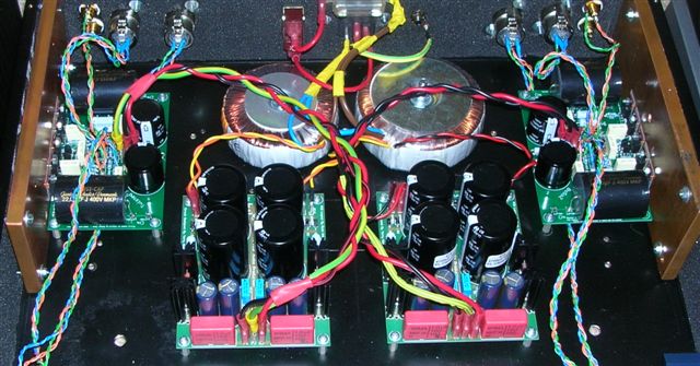

Joined 2002
Now that i have some time. Here are some pictures of my pre-amp running straight 4 days now 🙂
Assesears said:Finished and burning in on the test bed, very happy with the results just need a good case to do this justice. Many thanks to all involved. An xbosoz and mini aleph together perfect.
Cheers Bruce
Nice work!!! Glad to see you did not seem to have much trouble.
A nice combo indeed. I hope soon to have an Aleph or Balanced Zen to be fed from my XBoSoZ.
Cheers!
Russ
jleaman said:Now that i have some time. Here are some pictures of my pre-amp running straight 4 days now 🙂
Jason,
I am glad you seem to have things well sorted out now and can sit back and enjoy the music. 🙂
Cheers!
Russ

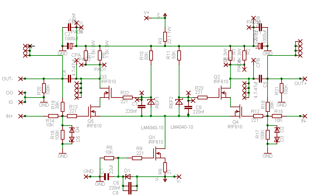

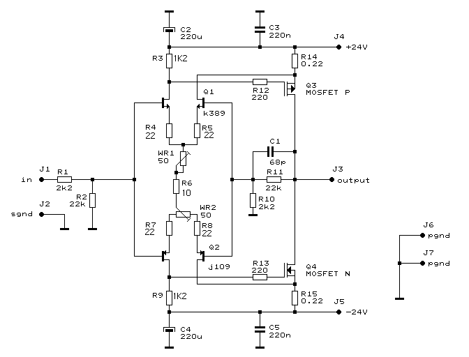

I need help from all of ya junkyard runners with ugly looking and ugly working preamps........
friend of mine bring me one little and sad preamp ,not 100% functional......
schematic and project background enclosed in attachment.....
now you know everything......
non profit pcbs and kits ......
my question is simple: give me No. of post where is last valid (or actual-if you like) schmtc of your local "humpty dumpty super duper dear god how many acronyms in one name" preamp........hehe-meaning on X-Bosoz............
I want to remake this redundant preamp in something nice and workable (man-two CCSs in paralel!!!)
you all are bloody nutz......who can find anything in 100+ pages thread.......

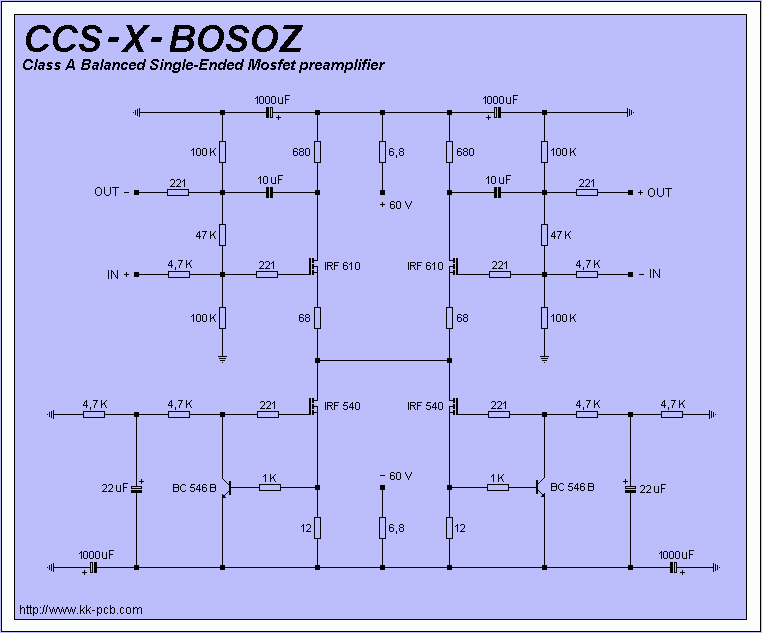

Russ White said:Here you go.
and here you go 😉
edit :
Russ -can you point me also for these :
value of Ref1 and Ref2 zenners ...just voltage-I'll calc dissipation 😉
value of D1 (or just give me current through CCS)
and-also-I presume that V+ is in range of +60 and V- in range of - 15 to 30V.....
waiting......😉
choky,
Nice bit of circuit you've got there, for a SE in to SE out. Make it fully balanced and it'll be pretty close to Nelson's UGS module.
For your questions, the REF1,2 are 10V, and we have been using the LM4040-10 precision references (they are much quieter than zeners). The CCS should target 80mA. Optimally V+ is 70V, but will work just fine with 60V. The V- can run as low as -9V, but I would not recommend coing any less than -20V (better stability and less noise from the CCS at higher negative rail values)
Cheers, Terry.
Cheers, Terry.
Hi Choky! Thx for that babel thingy!! 😀
The refs are both 10V LM4040-10 is what I used.
D1 is 6.8V
V+ should be 65-75V
V- should be 17-22V or so. (not too critical)
:EDIT: Terry you were too quick for me! At least we were in agreement 🙂 :EDIT:
D1 is 6.8V
V+ should be 65-75V
