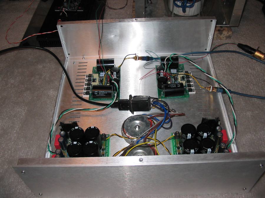

Well we have lift off 🙂 I only powered one channel up at a time ONE works one does not. They both produce sound but the other one is really faint. I think it is the zener dodes i checked them again and they are really dead now.
I have to admit at half there voltage using a variac them resistors get hot still.I think im going to order some 5 watt ones or get the same ones Russ uses from Digi Key

Id have to say i made it to the land of both channels working 🙂 Sounds Good Guy's.

Here are some pic's of the pre-amp in action. The fix for this. checked the diodes & replaced the thin isolation pad's. If any one wants the part # for the pads that i have used please just email me.
