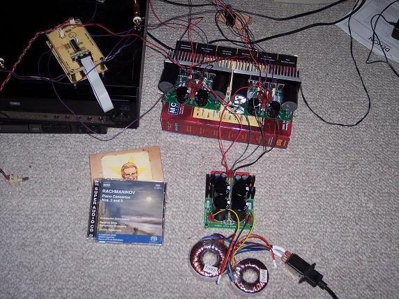

So, I got tired of waiting for my case to come (par metal) and decided to rig the XBOSOZ on the floor and try it out. I connected it single ended in and out from and old (but good) SACD player to a pair MyREF Rev. Cs monoblocs. I used my "twisted log" relay attenuator with 2.2K output impedance and input impeance from about 4K to 28K, and easy enough load for the XBOSOZ.
I tried the attenuator on input, and quickly found it not to my liking, way too much hiss, so I put it on output. WOW!!! dead quite now, what a difference.
As for sound, well I could not turn it off all day yesterday and today. 🙂 It is in fact still on. Very muscal and lush bass, awesome clear details, absolutely rock bottom noise floor, noise is undetectable to my ears unless I put my ear to the tweeter.
Thanks to all who got the project to where it is. I am very pleased with the result so far, much more than I actually expected.

Re: Here is the ugly pic 🙂
Can we perchase them transformers off of you ?
Russ White said:Looks aweful, sounds wonderful 🙂

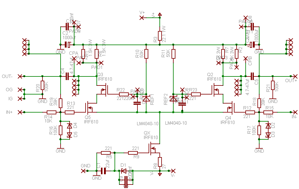

Some questions for the experts
1) C1 on my preamp seems to get pretty warm. Looking at the traces I don't think it is too likely that the heat is being conducted from R1/R6,R2/R7 instead I wonder if the heat is being generated by D1 (6.3V zener for the CCS). this made me wonder if 6.3V is the optimal value for any negative rail voltage, or if it should be adjusted. In any case I will try it with that diode elevated above the cap and see if it helps.
2) Does C1 need to be bipolar? The schematic I started from had it as bipolar electrolytic, but I wonder if 105C 22uf standrad electrolytic would serve just as well. If a standard electrolytic will work I assume the positive lead should go to GND. Is that correct?

metalman said:C1 does NOT need to be bipolar, and the +ve terminal goes to ground.
Ok then here is a very important building note for my PCB. For some reason (I think I drew something in a wrong layer) the C1 cap is shown with only one solid white line (it should have two denoting bipolar). The positive side is where the white line is, that is OPPOSITE of the way caps are usually marked. So if you don't use a bipolar cap (such as the one supplied with the TP kit) make sure you get the polarity right.
