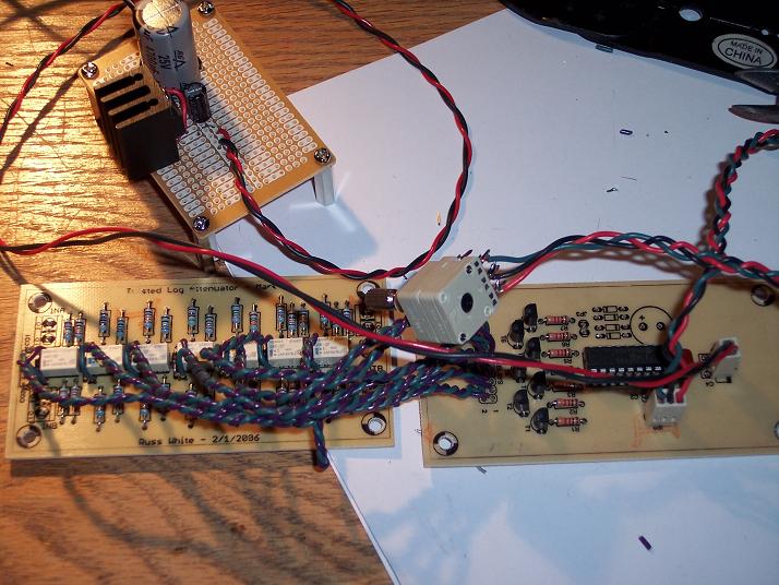

the attenuator
Dear Russ,
How is it going ?
Thomas
I am actually reworking the attenuator for logarithmic taper at 2 db per step from 0db to -64db.
Dear Russ,
How is it going ?
Thomas
It is working.
I have a 128 step (.5db) 64db total attenuation prototype working.
The attenuator can be controlled any way you like, but with the controller I am using here in the photo it behaves exactly like a true one turn log pot when controlled by a 5K linear pot to the PIC's ADC.
So far it is working pricisely as designed with no nasty surprises. The software worked on the first try, but then it is super simple.
I expect this thing to be in full swing here very soon.
Remember the picture is of a prototype, the real thing will be much more polished.
Cheers!
Russ
Cheers!
Russ
