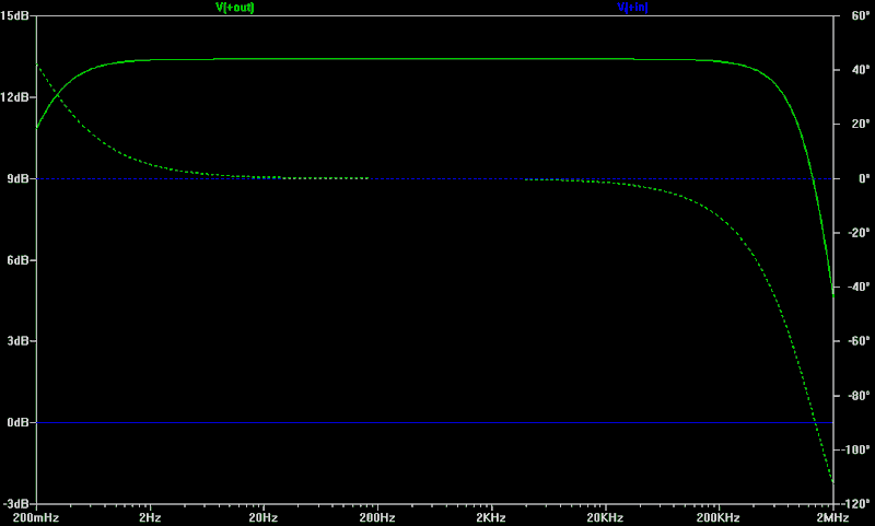

With those Jensen Caps, here's what the bandwidth will be.
