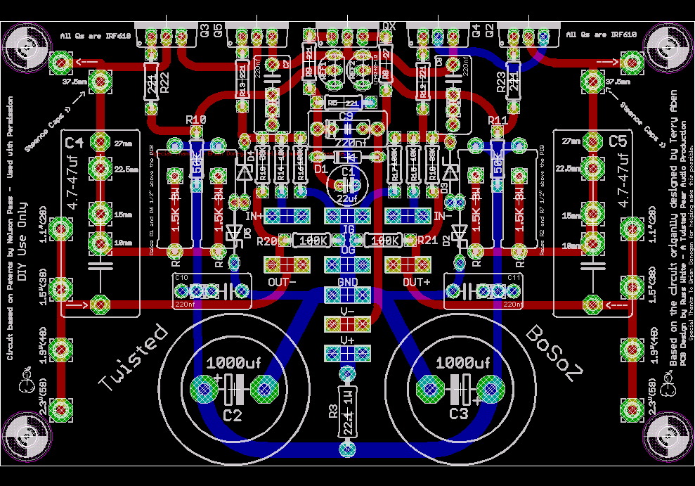

final tweaks
Here is the Pre:
Good to go? 😀
That should get you very close to what Terry did on his schematic here
Terry states that the value represents a Zenerstack. I think 8x9,1V Zeners would be more reliable than a single 75V Zener. The string of Zeners a commonly used in NP's preamps. Maybe Terry or someone else could tune in on this?
Steen🙂
Steen🙂
I think the stack is ther just to help you get the to the desired value, since most times that can't be done with one zener. 🙂 But I could be wrong.
You guys are making the right assumptions. It represents a stack of zeners in series to get the right reference voltage value. And Russ is correct that achieving the exact voltage isn't critical. The circuit will easily tolerate a volt or two in either direction of the spec'd values.
CHeers, Terry
