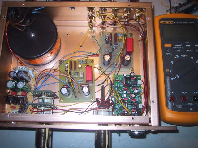

Okay guy's, we have a working preamp😎 There was no problems at all implementing this little wonder🙂 The sound is very promising, indeed. With a better implementation than this proto, I wouldn't be surprised if this will be a very well sounding preamp🙂 I am running it from a simple LM317/337 supply at +/- 22v, since Choky didn't like my other supply😀 (I am inclined to try it anyway's though😉) The parts used for the boards, were just some components I had on the table. The pot is a 10k Elma attenuator wired in at the input. The transistors are MPSA18 for Q1 and Q3, Q2 is a BC560C. (watch the pinout if you will use these, as they doesnt fit the silkscreen!!) Turn it 180 dg. The trimpot is 200k. All component values as per schematic. I guess this means we can safely move on, and see if something can be perfected, somehow. The foundation should be OK 🙂 Here is the prototype, dont mind the build, it is really just a proto 😀 I will wait a bit, before committing to another build. Lets see what suggestions there is for improvements first.
Steen😎
Edit. The adjustment process is a little tricky. I managed to adjust both channels to 0v at the output. But the voltage drifts when turning it on and off. At turn on the voltage is positive approx 300mV, at turn of it goes negative to about -150mV. The circuit settles slowly. So be a bit patient when adjusting.
Steen😎
