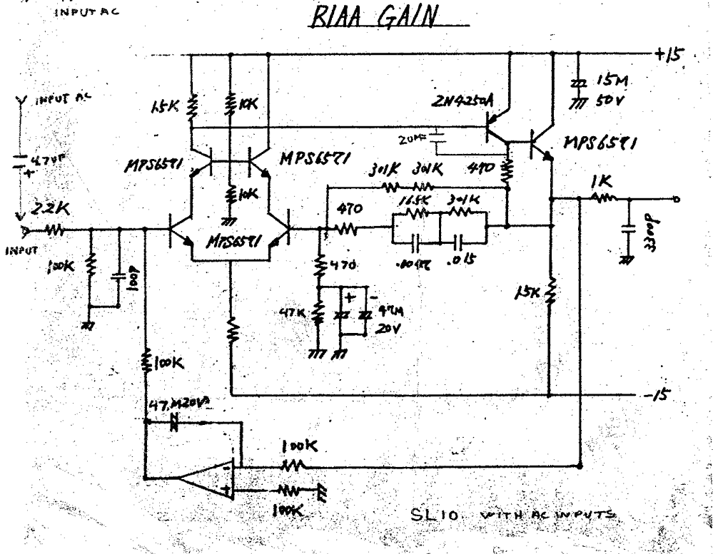

My 2SK30Y has IDSS of 3mA. What is the minimal threshold of this "starving for current"? Do you have any rule of thumb in what mA should we use a Jfet with a certain IDSS?

the Phono-Stage is the same as in SL10 MC input
you can see the Phono-Stage on www.passlabs.com/np

like this?audiotux said:Hi choky ,
Greetings from Germany
Jürgen
without servo and cap connected?

Hi, Steenoe,
Thanks for the link.
In that article it is very clear about how to use Jfet. But I don't find a "rule of thumb" about what is the minimal threshold of "starving for current" in Jfet usage.
Refering to the original NS10 (Nelson Pass') schematic. If I use Jfet for Q1, what is the value for R4? Do you think 10K is too high?

Maybe you are right. Why NP himself put bipolar for Q1 particularly on NS10. Other preamps like Fet10 use Jfet, but not in NS10? He surely have checked all devices, and he decided to put bipolar for Q1.But insisting on a JFET just increases distortion.
I can find no reference to John Curl's remark.
http://www.diyaudio.com/forums/showthread.php?postid=243094#post243094
Marcel, I noted your earlier post. Actually, JFET's can be paralleled with relatively less increase in overall operating current, BECAUSE the transconductance of the JFET's drops as the square root of idle current, rather than directly like a transistor does. This keeps the noise from increasing as fast as you 'starve' the JFET of current. An additional advantage comes from lower internal self heating of the individual JFET's. This improves noise performance, as well.
http://www.diyaudio.com/forums/showthread.php?postid=270252#post270252
This is complicated. Normally use the highest current to get the lowest noise. If you HAVE to starve the fets, then the GR parts may work best, but the BL parts are actually better operating at nominally higher currents. Run at high current, if possible
