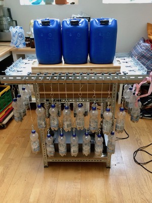

not really. i know i have to go and finish it 🙁 but the weather here is so bad its either raining or windy(or both), and i have to buy my wood and transport it by bike 🙁 it gets wett or i go flying in the wind 🙂 haha
i did order all rubber bands, and coated all the clambs for one side. so i have to make almost 4 times as much of these clamps. i also bought a mica heater i might use to heat the film. its a verry thing heating element 40x40cm i might need 2 of those in the final design. but first tests i will probable use a paint stripper. it should work as well.

the optimum is where quad used to put it. for 3 micron mylar that is just before breaking point. when tension is to low you can play lower but spl will suffer down that low and it will drop earlier then when the correct tension is used.
so the decline will start sooner but will extend further down when tension is to low. to high tension is almost impossible with 3 micron since it will rip before you reach much higher.
Problem is many use 6 micron, now 6 micron mylar is easy to get the tension TO high. since it it much stronger.
another downside of to low tension is the ability to play lower frequencies, but they need higher excursions, so you will hit the stator when you hit the resonance frequency. at much lower volume then normal. (i have this problem with one of my quads)

still i am torturing myself to get it to 3 micron. and since there are 2 sets standing in my living room for over a year now, i might help myself and use 6 micron. witch would result my other time being wasted.... but might get things going and moving out of my living room for once. and get some spending money for other projects , like a bigger CNC table or more research into some of my projects i did , where i never wanted to spend to much money.

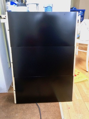

Stretching
It is a long time ago. I also have experimented wich streching jigs and heat treatment etc to repair panels for a ESL (Beveridge 3s). I ended with a method that worked quick, simple and delivers controllable results:
(1) marking to rectangles on a table tennis table with white edding. One with the original size a second scaled by +2%.
(2) Then placing the mylar, attached with loose tension with tape
(3) mark the smaller rect on the mylar with an edding
(4) stretching the mylar starting by the halfpoints off all sides until evenly stretched
(5) when finished place first grid from top (used 3m double sided tape, for mirrors, still fine since years). Remove taped and join with second half.

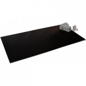

Yes , the oven does not exceed melting temps of mylar ofcourse 🙂 but it could be localized heating to. i have a ceramic heater i bought for this project its flat and large and i might needed 2 of them. idea was to make a jig so you can roll it over the stretch jig heat it and tension it then remove it again. but i must say i sort of stopped working on it. i try to fix my ESL's and be done with it. i have no energy for the quads left. i want a cool fresh project from start to finish 🙂 these speakers are standing here for 2 years now and i had enough 🙁
Part of satisfaction is mastering the technique for me, I guess 🙂 The jig I built uses simple clamps and bottles filled with metal punching caps. For heating I used 3 heating panels of 60x30 cm to cover the diaphragm. I place it over the diagram while stretching. It sort of hovers 2 cm above the mylar, and will get to around 110 degrees. I heat for 15 minutes.
