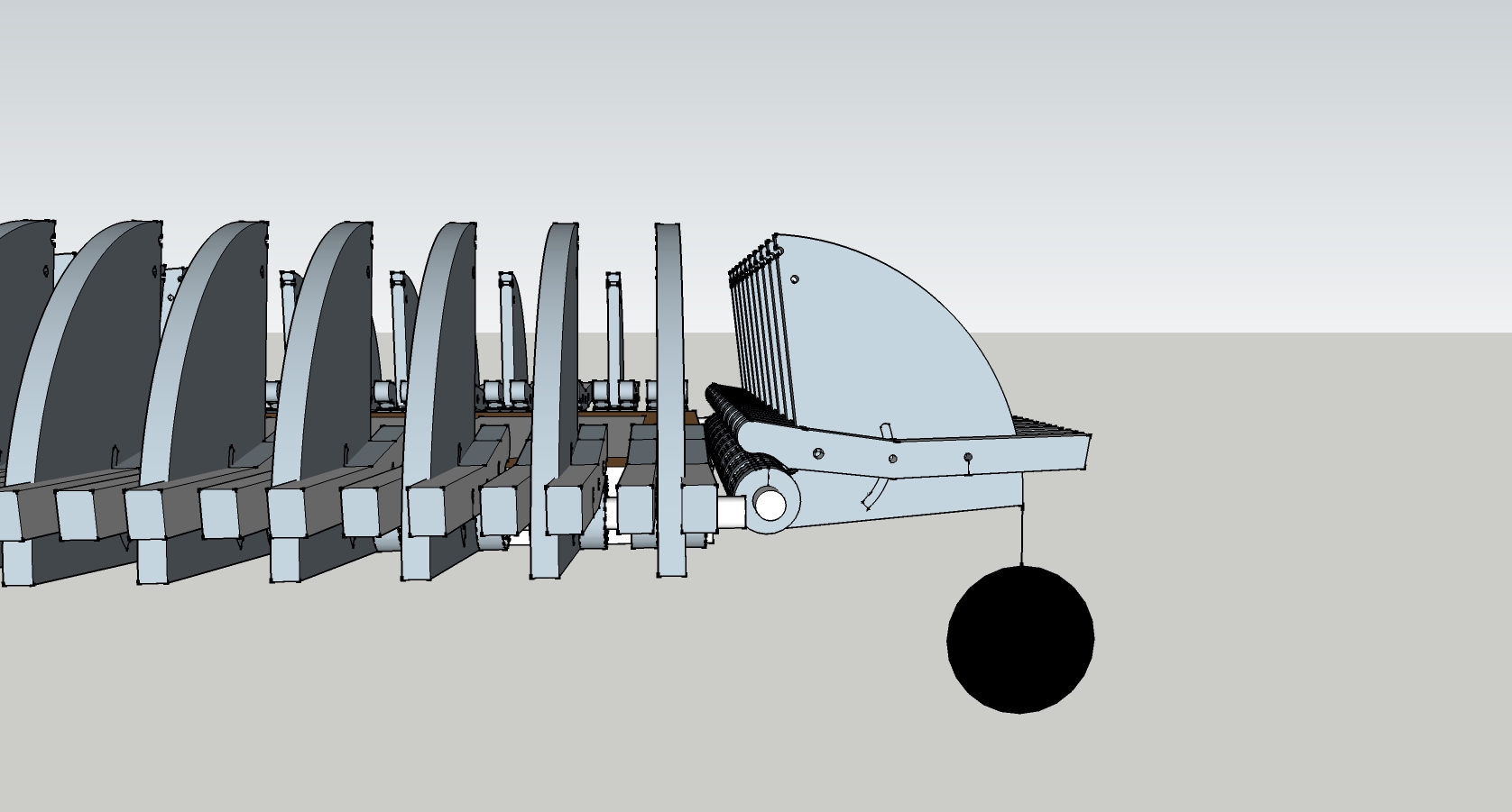

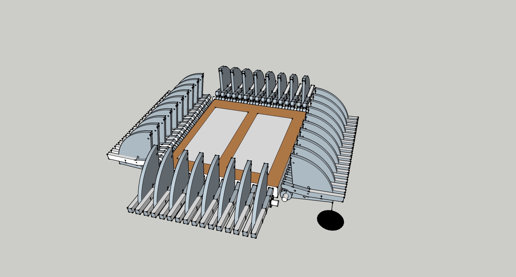

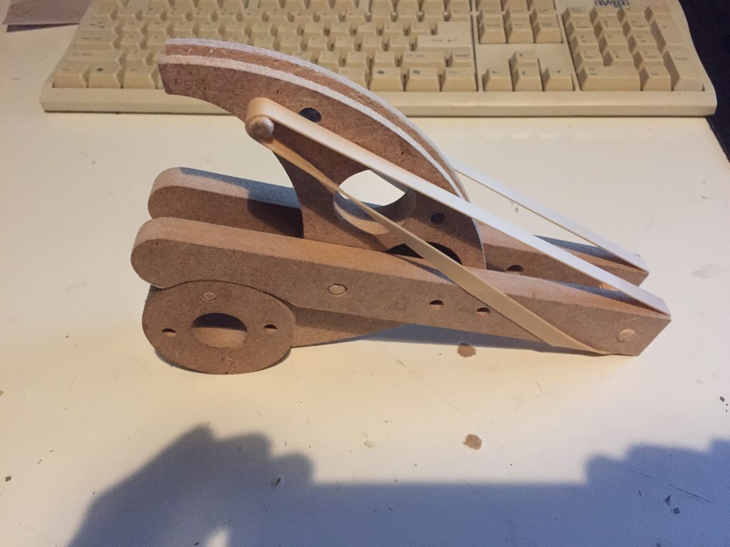

Well here a 3d version(without base etc and details 🙂) , i am not sure yet if i should make the small circle that's on the metal tube a little larger, this would increase the maximum length of Mylar it can pull sideways(it pulls 1/4 of the circumference). but it will lose some of the arm so a little more weight might be needed to pull to correct resonance.
in previous post i showed one of these arms, and the weight alone when you hold it at the hole in the small circle has already some force.
i also did a test with some glue on the clamps to see if it can hold Mylar. this is hit and miss. although tolerances are pretty ok there is still a tiny bit of room in the clamping so mylar slips. witch is not weird since my machine wont mill to 3 um precision 🙂 that would be fun 🙂
i might try single sided foam tape, i once used that to hold Mylar between 2 mdf piece of wood, and it never slipped before it broke(and that was 6um)
I did not draw the rubber bands that come between the outer hole in the clamp arm and the top hole in the 1/4 circle. i also only draw one weight(the black circle) just to hope clear how this would work.
Further, there is an option to automate all this, for now i will drill an extra hole in the 1/4 circular piece so i can lock the clamp in the open position. later on i would like it to be automated. when i could get a ram of some sort it can push the 1/4 circles into the beginning position, and at the same time push the clamps against a bar so it will go in the open position. so 4 rams needed in total. or another solution 🙂
any suggestions or stuff i miss please let me know. don't want to make soooooo many pieces and come to the conclusion its is a dumb idea 🙂 haha

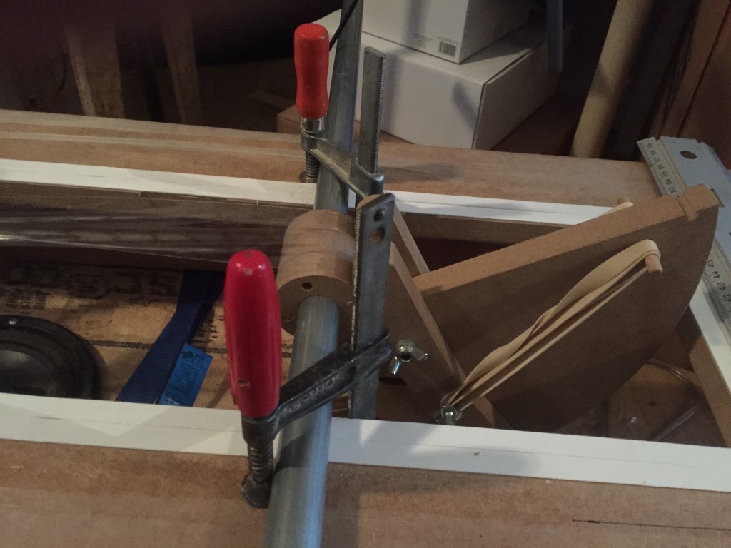

So far i gained knowledge that my clamps are holding and my tire is not leaking any air. (not even a tiny bit) at least the panel would be glued by now. since glue dries in 40 to 60 minutes.
last be not least. you can see that just mechanical stretching a membrane then glue it to a stator is not gone give you a steady result. it will drop. be it 2.5 hz over 17 hours, who knows where it will end up

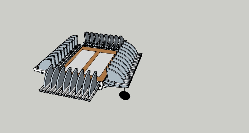

so i kind of have to build the other jigg, or at least a spin off.

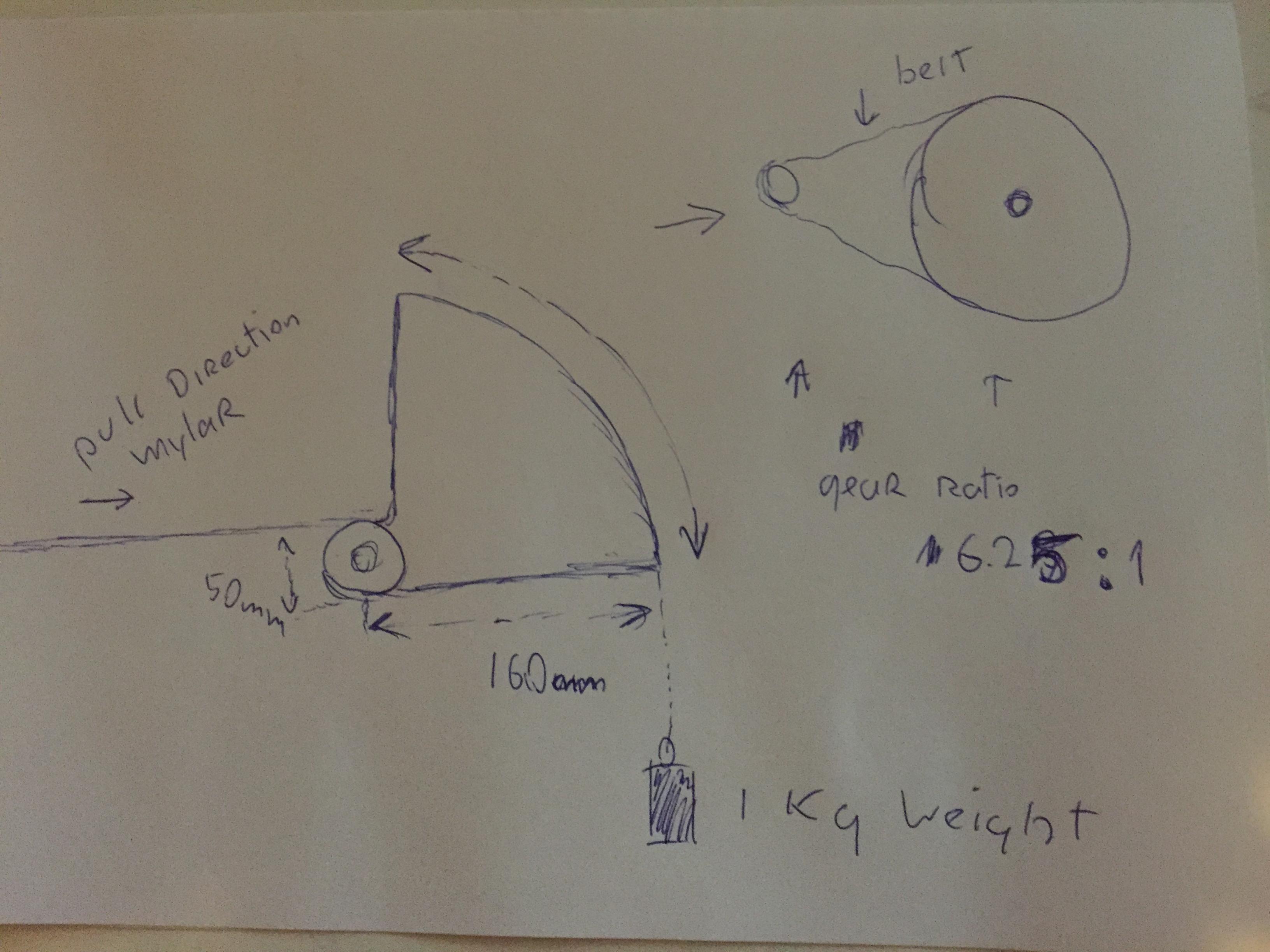

the drawing shows how the thing would work. i left the clamping part of the mylar out since this picture is about dimensions.
it actually works like a pulley system.
The front ring where the mylar gets attached to is 50mmin diameter and the bigger 1/4 circle is 320mm in diameter at this point. so its ratio is 1 : 6,25 . so hanging a weight on it of 1 Kg it pulls on the mylar with 6.25Kg , that is way to much.
as i recollect the 57 stretch jigg used 45 Kg for the 6 micron foil. you can imagine for the 3uM we wont want to come anything near that value or it rips 🙂
so i actually thought of making weights of around 1 kg from molten lead in water drain pipe of a 40mmm diameter. inner diameter is around 34mm
so surface area is 9,07 cm2 if i make them 10 cm high i got 90 cubic cm. 90 cubic cm filled with lead is +-1Kg.
if i hang this one kg on the current drawing i end up with 6.25kgz of pulling force... times how many clamps i can fit on the table. my guess is around 40 or so. that would result in a total amount of force acting on the foil or 40x6.25 kg 🙂 haha 250 Kg well thats only about 5 times the amount needed for a 6 um foil 🙂
So i can reduce the ratio, by either making everything smaller, or using less weight. or a combination of both to still be able to accurately add small weights to get the desired tension.
Last option is not making the large wheel smaller but the smaller bigger. this reduces the ratio torque wise. but gives the clamp a greater length it can pull while being complete linear. with this setup it can only pull 4cm, but on the opposite side of the clamp there is exactly the same clamp pulling in the reverse direction so in the end it can pull a maximum of 8cm. i hope this is enough. accordingly to the data sheets mylar only stretches for 3% normal width of 3Um mylar is 680mm so it will only stretch as much as 20mm in total over its length. thats leaves me 60mm for positional errors when putting the film into the clamps... think that would be doable

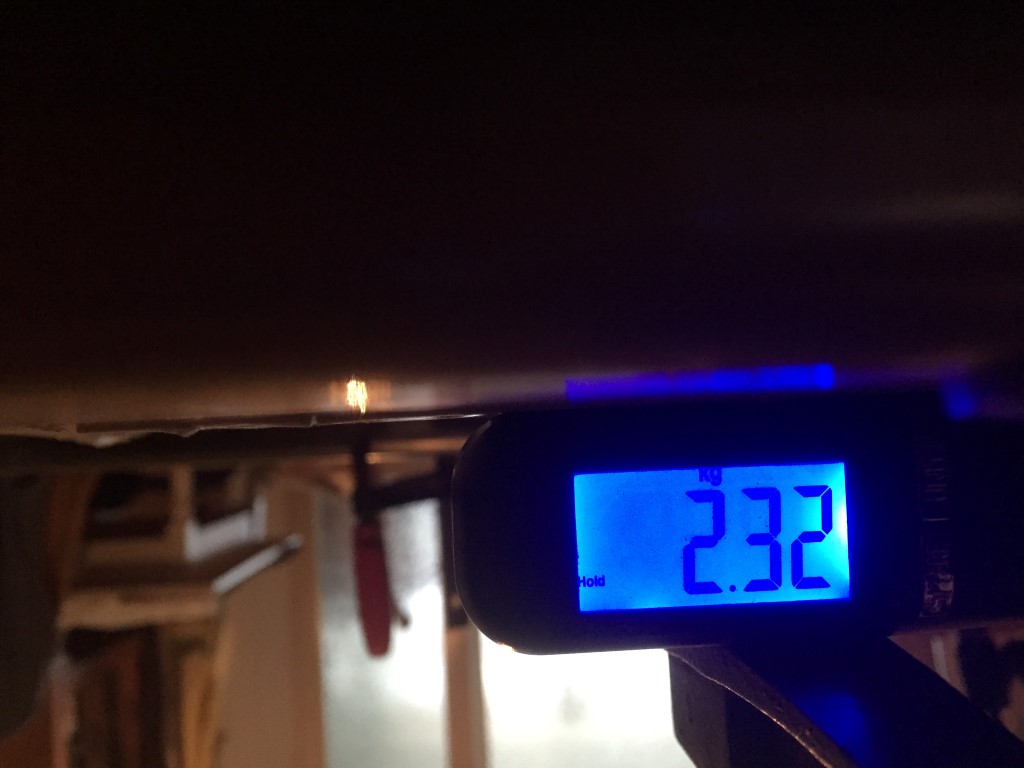

well bought a pull scale. nice stuff for only 10 euro it measures from 4 grams to 35 Kg 🙂 awesome .
well i rigged it between the prototype pulling thingy and clamped the scale.
Thig prototype was even larger the 1/4 circle diameter was +-400mm instead of 320, wich in theory makes the ratio to the small circle that holds the mylar 1:8
The weight of the wooden contraption alone pulls at 2.3 Kg as seen on the scale.
no lets see what it does when added mass
i added 300 grams the way i would attack the weights in the final rig.. so 2.3Kg is the default. lets see how much increase i get from the 300 gramms.
well it readout was +-4.5 Kg minus the 2.3 Kg that leaves us 2.2kg increase from 300 gramms added. 2.2/0.3Kg = 7.33 ratio. well thats pretty close to the calculated 1:8 ratio. considering the measurement og the weight was not extreme accurate and does gets amplified by 8 to small fault becomes a bigger one.
so successful experiment. ratio theory is correct, and clamp could work so we can move on 🙂

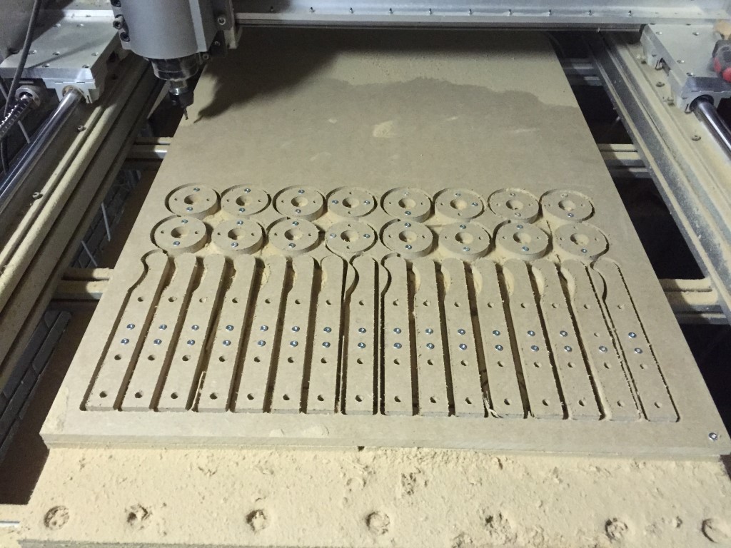

Made the new 1/4 circles for the stretch jigg. at least 24 halves 🙂
wish i could find my words more easy on camera 🙂 hehe

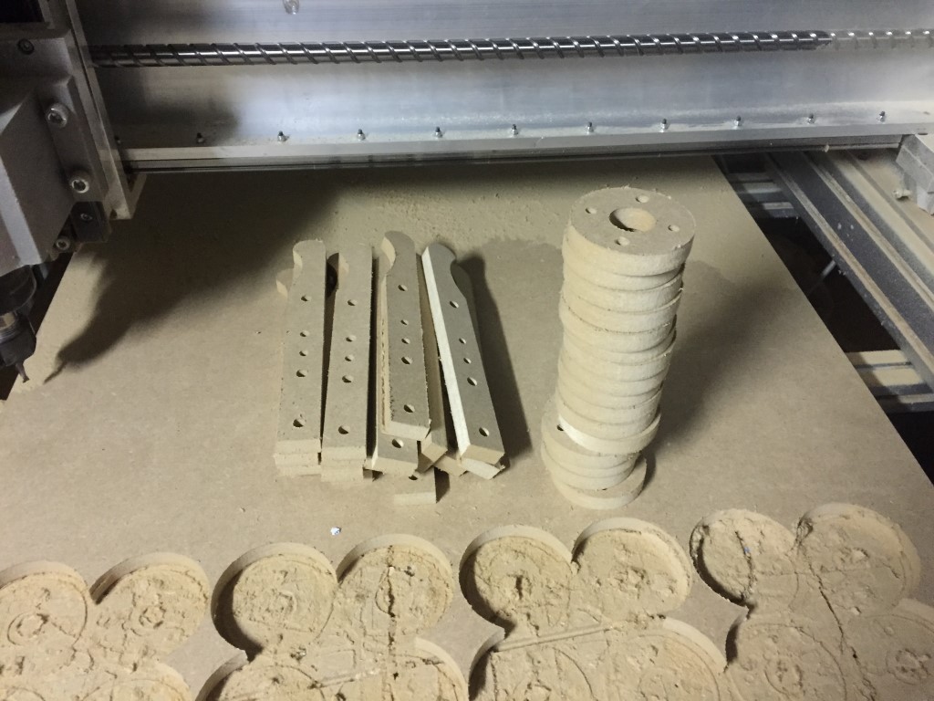

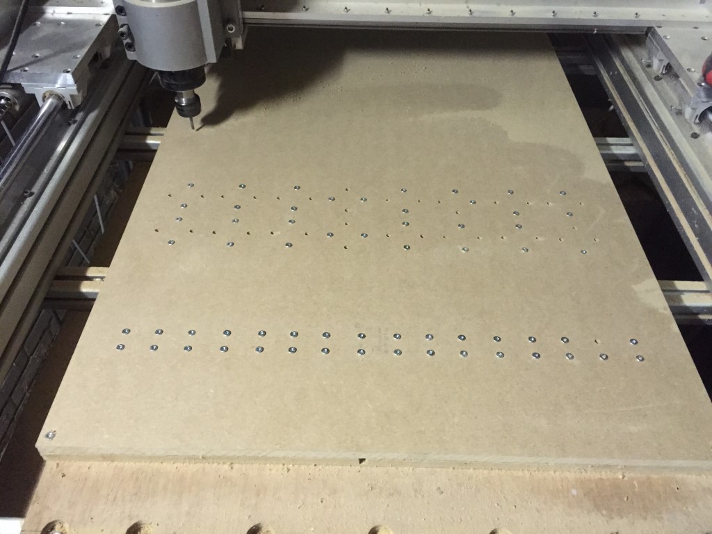

Some machining later. i milled my clamps and rings that will go on the 1/4 circles.
just a few ofc not all of them at once. i try to get one side complete to see how all works.
still there will be 12-14 clamps on the longs side of the jigg so 14 times 2 for every piece you see. this is just 1/2 of the longs side items i need. its not the machining thats anoying its screwing every piece to the table inhaling large amounts of dust 😉 , and getting the wood by bike..... on a windy day i cant get 2 plates of wood 120 by 60 cm by bike 🙂 sop yesterday i did not get any. today i got some 12mm for the clams and rings 🙂
