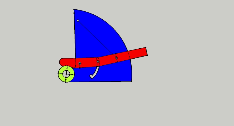

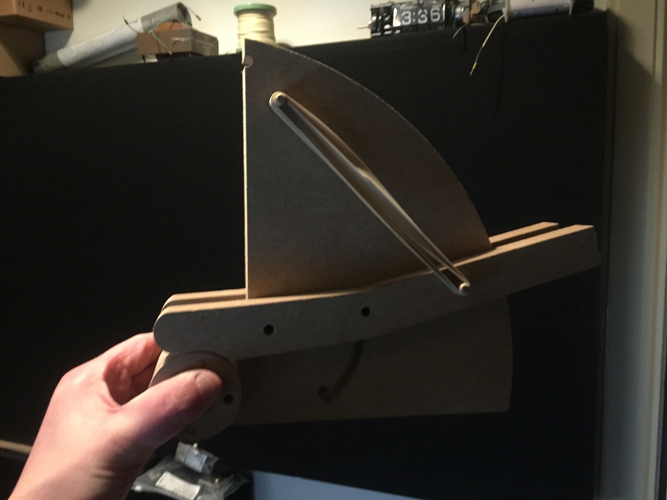

Dont mind my shitty modeling skills 🙂 but i hope i can explain what happens.
This is my first iteration.
First of all the green circle will fit on a metal shaft 22mm thick, the blue part has a circle as wel atached to the blue structure, so its green circle blue circle and green circle.
The red part will be the clamp holding the mylar on the green circle. you can slide it downwards with a leaver(red). there will be 2 of these clamps one on both ends of the blue piece.
the black line between represents some rubber bands..... the pivot point of the clamp is all the way to the left. the middle pin is just to keep both clamps (on both sides of the blue thing) together and to lock it in the open place . as seen at the bottom, since the rubber bands pull up but as well to the left. so when you force the leaver downwards(the red thing) at the end (to the right)
it will engage in the lock position. also it has a leaver of around 2 to the pivot point so any rubber bands force wil almost equal 2 times that, the leaver on the right (red has almost 4 times the ratioj so it will be pretty easy to pull the clamps open)

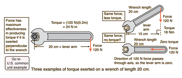

now for the blue part. why is this 1/4 of a circle?? think of it as a pulley, but only 1/4 of it. just like a pulley or a wrench, a wrench increases torque on the bolt. but when forces are not at a 90 degree angle(on the end of the wrench) torque is lost. and allot of it.
If i hang a weight from the top of the 1/4 circle with a rope down, and use the 1/4 circle as a pulley, the force it puts on the green donuts to turn backwards will be equal over the entire 1/4 of the green circle. but amplified. by the arm length. in this manner i could use lower weights, and save money on pulleys as well. wood is dirt cheap 🙂
See the blue part as the wrench, when you have a wire with a weight on it lying on it as if it is a belt, the angle will always be 90 degrees
if you would build a ramp to put the 1/4 circle back to this position you could automate the the opening of the clamps as well with the same upwards motion. (like a ramp or something)
any good ideas please tell me, im breaking my head for like 3 weeks to find a solution that does not cost 100000 euros to make, and could be automated and could give same results time after time.

Oh in this case linear motion is only as far as 1/4 of the circumference of the green circle. that is 47 mm for a 60 diameter mm circle. you can increase the circle but lose torque.

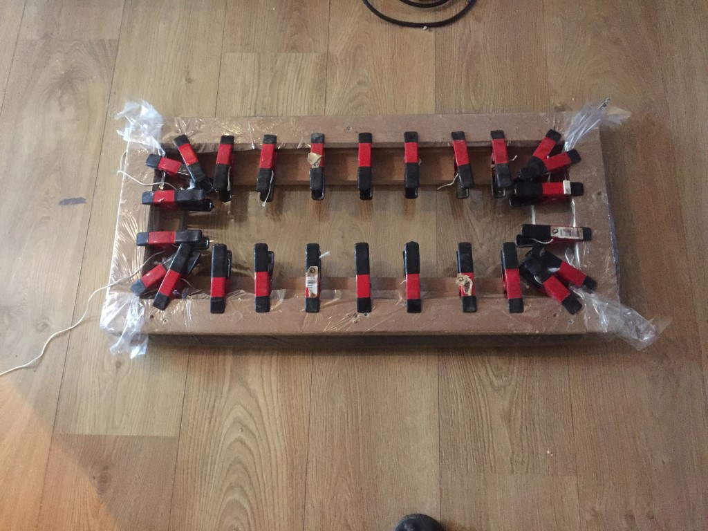

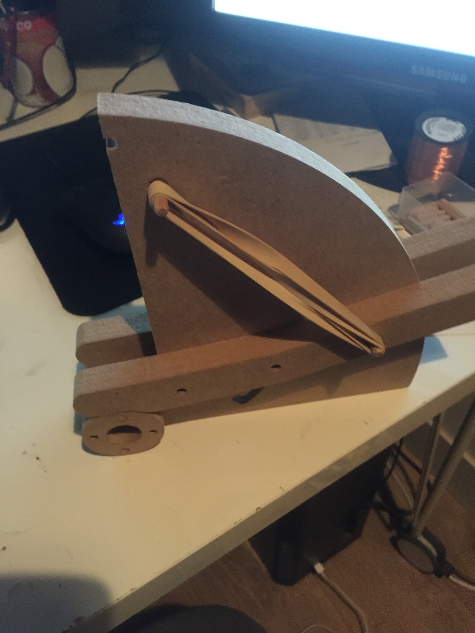

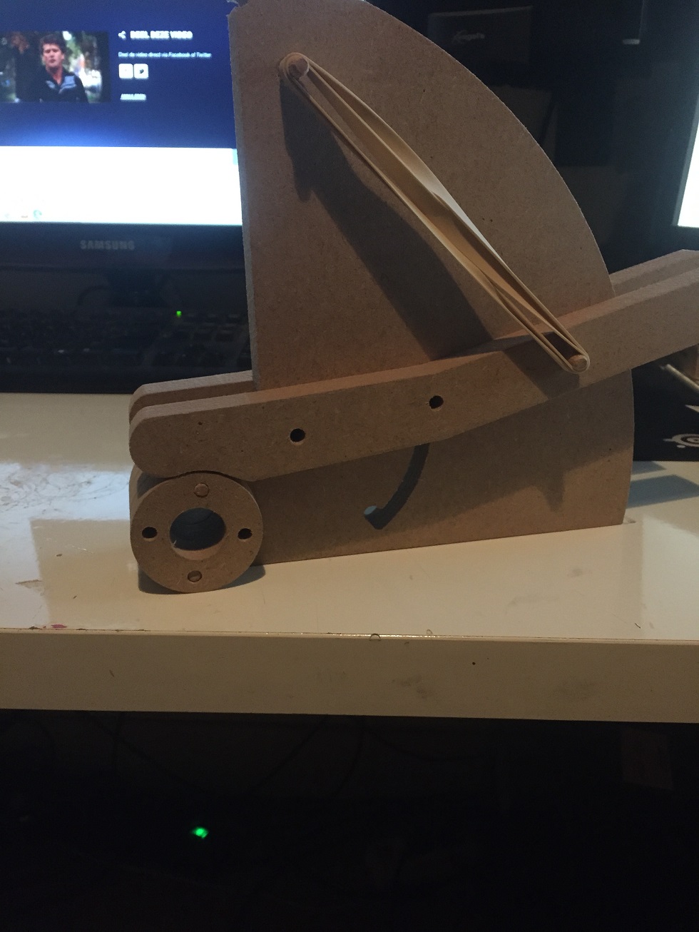

Well i finished the milling before i left home, and now took some pictures. hopefully this explains more 🙂
still managed to **** up making the tool path. first of all somehow the circles inner dimensions is not 22.3 mm but 21.7 so it wont fit on the metal pipe. further, one drill hole that is used as pivot for the clamp got misplaced in the tool path program (cambam) so it wont fit 🙂 but both are easy to correct and should not be a problem in the future.
the clamping force with 1 rubber band on each side is pretty high thats good news 🙂 i will add foam or rubber glue on the clams to increase friction so stuff wont creep.
I'm intrigued by your jig but still a bit confused on it's operation. Perhaps if you could show it in the larger context of actually stretching a diaphragm, I might then see the light and say "wow, that's cool!"
yeah i might make a 3d drawing because, i need to make 30 more of these to see if it actually works. that kinda sucks 🙂 haha

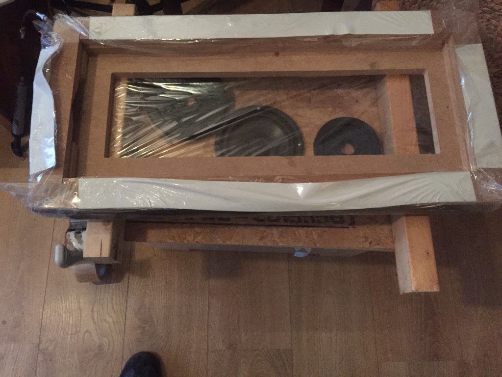

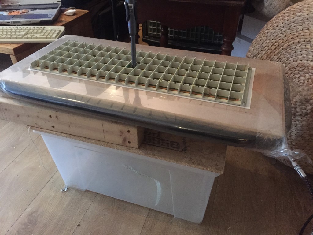

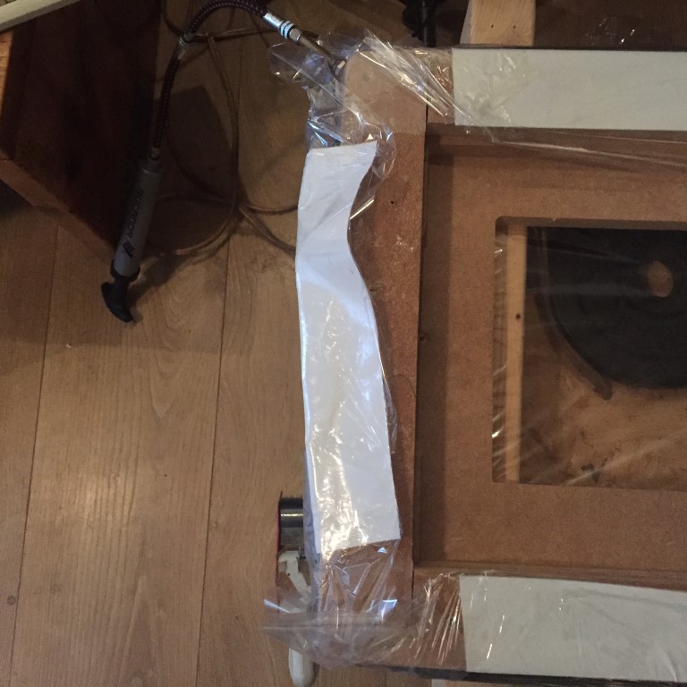

So , altered the frame to accept the clamps on the inner rim.
picture 1 i put Mylar on the floor and put the jig on top of it, wrap the mylar around at all sides, and use clamps to hold it in place. i might need a few more, if i can find some. another 12 or so will be more then enough.
picture 2 is the Mylar stretched with the measure mic on top of a stator. i look for the desired resonance in this case just a random high value and get my timer going to remeasure after 10,20,30 minutes then 1 hour etc. to see how much it drops.
there on the translucent box, there is a wooden baffle with a woofer in it. i play a sweep from 20 to 120 hz, when swept there will be a peak of the resonance of the foil. the mc is really close to this foil so it will detect it easy as a big hump. in the frequency measurement
i like this method more then pulling on tape and such. since in this case it does not matter witch material you use(3 um 6 um 12 um), you measure what the resonance is of that particular membrane
almost forgot to mention the hole in the jig has the size of an quad panels foil area(without spacers), otherwise this would not be accurate.

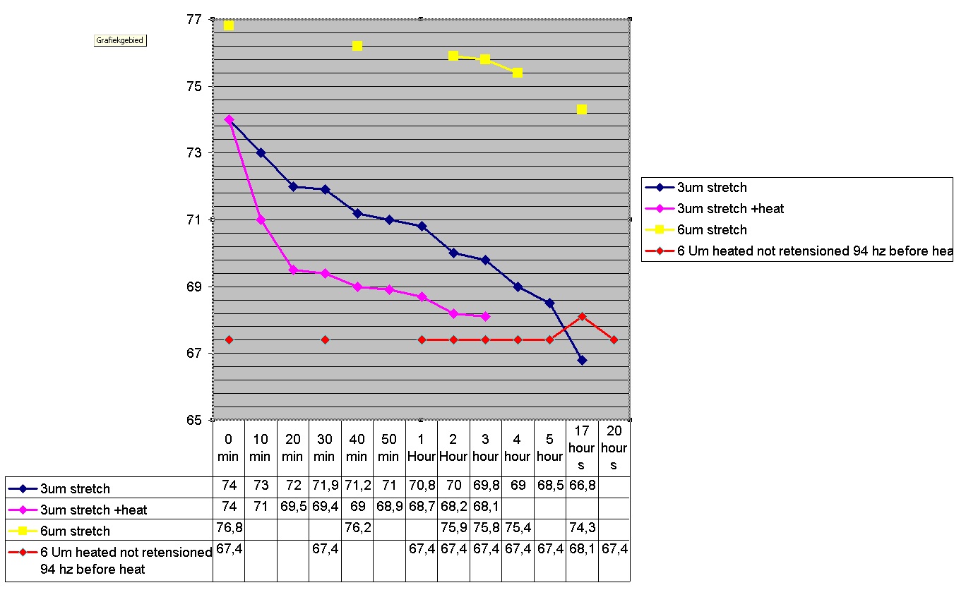

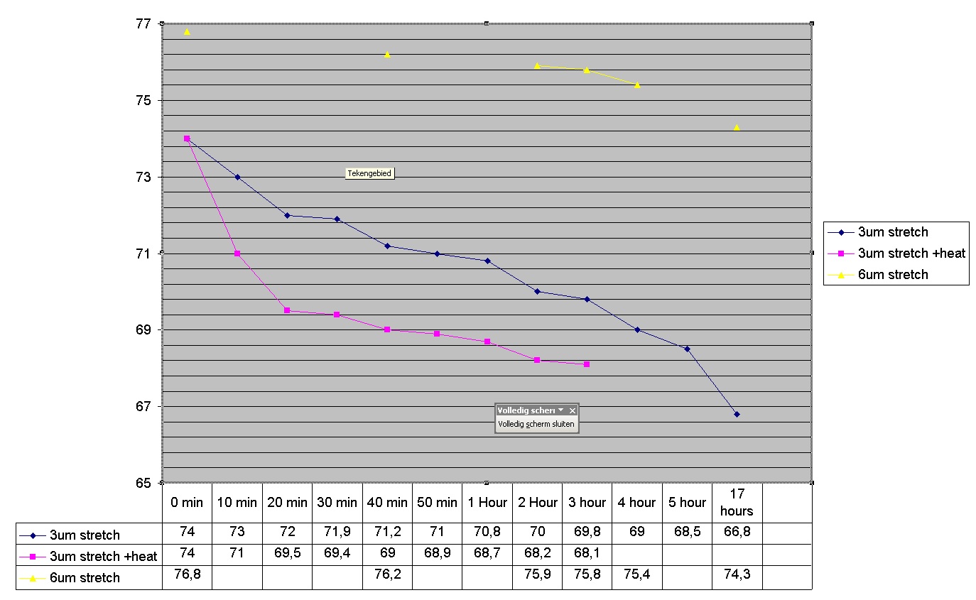

Did some testing with stretching mylar 3 um and 6 Um heated and not
i must admit for the 6 um stretch i used another inner tube. i wanted to use it on the 3 um but i ran out of 3um Mylar 🙁 40 meters gone without even fixing one ESL 🙂 i am persistent to have it correctly working , i already ordered new mylar just 3 stretches before i ran out 🙁 so when it arives i use it with the same tire once more. but still there are some funny things happening
by the looks of it the 6 Ûm is most stable. but since i changed inner tube i still have to do it once more with the 3Um 🙁 oh god. (might have been the tube at fault , that would be a waste)
Another thing to notice that the heated foil drops quickly and then setles in compared to the ongoing unheated 3 um foil witch keeps dropping.
One thing i can say about the test is that it shows that my clamps are holding, at least. so next up to rule out is the inner tube.
Like to follow your diagram over a timespan of at least a month..
I´ll be waiting...
How do you measure the tension/relaxation?
I´ll be waiting...
I´ll be waiting...
would be nice but ...... i cant wait a month.
i measure it with a mic on top of the stretch jig and a hole the size of my quad panel in the jig, with a loudspeaker underneath. i use holmimpulse to sweep and see where the peak is.
i might do a heated 6 Um today to see what it does, since the normal 6um does pretty ok already. hope we can see a flatliner ;0
so far when i stretched the mylar to a health 93 hz before i used the heat gun.(with 6um mylar thats pretty doable)
Then i heat the 6 um mylar especially where the tire stretch it. i heat it until the inner tube does not grow in size anymore, thats the maximum the mylar will stretch with this heat and tension. and then do some passes over the top.
now the res drops considerably straight down to 67 hz. and now for a change i wont correct it to the 74 hz like the rest. because i am wondering if the last action need to be the heating. in the quad jig it get the same tension all over the proces even in the oven it gets stretched. what i and many others do is just stretch or what i did so far stretch heat stretch to correct resonance.
there might be a difference in where the mylar will settle after it stretched with heat and where it will settle after heat + mechanical stretching.
i am not sure yet if i explain this correctly. i am just noticing that with this instance i dont seee the huge drop that all panels have common in the early 20 minutes.

Well there is your flatliner. although something weird happens after 17 hours it seem to come alive. it did not drop but increases resonance 🙂 haha not think this is a trend that continues to be honest 🙂 but i leave it on the jigg to get some more data about the rise.
So stretch then heat. pretty solid outcome. at least more solid then stretching 6 um alone. but stretching heating and then stretch the last 10 hz does not work.
when i got some more data about the rising , i will try a this:
Stretch
Heat
measure
Stretch
Heat
measure
until i get the resonance i want. (prob when the foil does not want to stretch more with the heat.)
I test this because this is the only way to do it with 3Um foil.
Since 3um will break when stretched to 95 hz before you heat it, it cant stand it, max is around 74-78hz.
And i dont want to waste another 40 meter of Mylar , so i will be stretching it to around 65 then heat etc, and go to 70 hz in small steps.

Ok 2 hours later. it looks like the rise was a faulty measurement. after 2 hours it it was back to 67.4.
So far i gained knowledge that my clamps are holding and my tire is not leaking any air. (not even a tiny bit) at least the panel would be glued by now. since glue dries in 40 to 60 minutes.
last be not least. you can see that just mechanical stretching a membrane then glue it to a stator is not gone give you a steady result. it will drop. be it 2.5 hz over 17 hours, who knows where it will end up
ESL63 wanted to know measurement over a time span of a month. and i am curious to. be it i cant miss my jigg for a month. or i have to buy new clamps.
another issue might be that a inner tube will lose some air over a month i bet!, so result will be slightly skewed. but on the other hand you can see the drop of the not heated membrane versus the heated quite clearly. so there will be a usable result with a small error margin.
conclusion thus far: if you design a ESL with a preferred resonance you cant just stretch it up and see what happens. this might only work if you know at wich resonance it will settle over time. this will cost you a long time figuring out, since there is no rule of thumb to the relaxation of the foil. it might not be linear at all.
