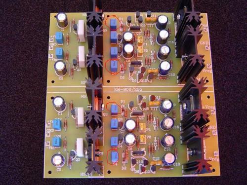

It's definitely something I'd try for high voltage, such as used in tube circuits 100V and up. I used to have a cascode of two NPNs, but your solution would work better I think. For less than 50V I'd stay still with the board as is, because of the flexibility it offers to go from 3V all the way up to possibly 60V, or even higher, if the right Q1 is chosen.

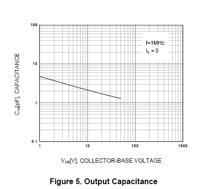

My considerations are if I can make it with very common, not super fast parts, that will not oscillate in practice with potent but slow PMOS that I like. It could go IRF9610, but the Ygfs is skinny. OTOH with IRFP9140 I am afraid it will be difficult for stability in practice.
That one? (BC550). 3pF at 4V (vgs). Same chart for BC546, with about 43V across in the error amp, goes under 1.5pF. Hmm maybe I have a tiny phase margin opening break in practice.

Remains to be breadboarded. Now I got my R-Core 21+21 to wire in series. From the charts above it also shows that when using higher Vce buffer transistor in your reg for higher B+ circuits like my phono, it actually gets even faster, Cob drops. So I could test yours on the phono too. Swell.

merlin, how much improvement have you found from using teflon PCB material? I would expect damping to be far superior and of course the better dielectric constant. but I do wonder about blackgates, I do like the nonpolar and FK series, but i'm not sure they are better than Nichicon KZ or sanyo OSCON from my experience. I still have some FK left to try in these regs, but i'm not sure I will bother buying more with the price they are now, i'm not sure they are even better, let alone THAT much better.
i'm interested in using teflon for my dac, possibly with silver immersion for ultra wank factor 😀 I like silver in digital circuits alot. it will be quite a bit extra and it would be great if you could give me your impressions vs high quality non-PTFE PCBs. perhaps PM would be better, rather than taking this thread off course.
so how close are we to this order ikoflexer? I might grab a few with bundled parts if you end up doing that, but not all as I want to try out a few combinations of parts. I may also up my order to 11 and bring the price down, who knows when these will be available again and a friend here has expressed some interest in a coupe pre-built ones I will make him.
