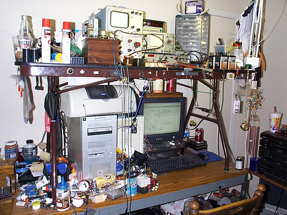

Ooh, that's interesting! A scope with the 10uV/div? Which one is that? BTW, the 465B is nice.
The best my scope can do is 100uV/cm. I've also built a low noise amp for regulator testing, with 20db, 40db, and 60db gain. But yeah, low noise measurements aren't trivial, especially one has to be careful about grounding.
Tek 561B, from the late 60's I believe. It uses plugins, so I've got the 3B4 timebase and 3A9 diff amp. It's not the cream of the crop but I must say I like the style it brings to a bench. Everything nowadays has corners sharp enough to cut off a wandering finger...
Internal noise at 10uV covers approximately 1.2 div at that point, so I can't say it's much better than 100uV per div. An interesting thought is to replace the old components with newer, quieter, faster types. Of course, that is to be done with some caution... A curve tracer would be helpful to find exactly the right types, and most of the datasheets are not to be found (not to mention Tek commissioned many semiconductors which bear special undecipherable Tek numbers). Another semi issue is drift. It's not that bad but it can be bothering. Here are some pictures I took about a week ago when I finished repairing my Tek, pardon the mess.
Needless to say, I'm proud of my Teks.

That's nice. I like those with modules. Mine's a really old one, a Tek 502a, tubes 😀 but can't complain about the 100uV/cm, differential input, and dual beam. I don't even dare think of starting to replace anything. As long as it works I won't touch it 🙂
Oh, and your mess looks very familiar
