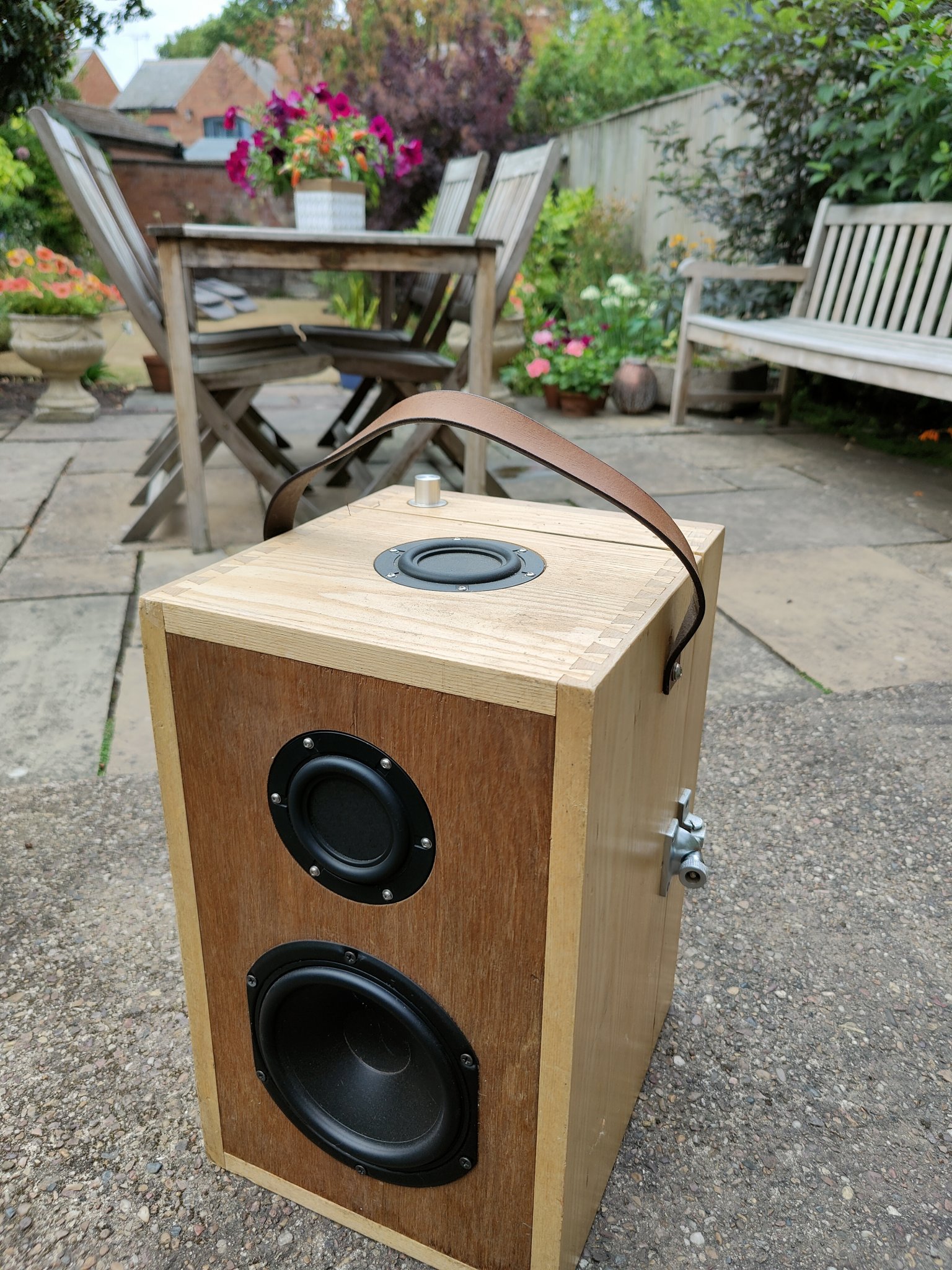

Veey cool Chris. This is my garden boom box. 2 X Tectonics BMR. In stereo but off axis relative to each other to attempt to help dispersion. Single 6.5" vifa sds 165 , ported. Powered by a 12v SLA. Tpa3116 3 channel with an 'active filter '. Cheap and cheerful but suits us for garden listening to decent levels.
Always amazes me how good it sounds outside when no reflections .

BMRs look cool! How do you find the dispersion with 1x up-firing and 1x forward? I could probably replicate that with the tweeters. The woodworking looks excellent, too. Was that CNC'd?

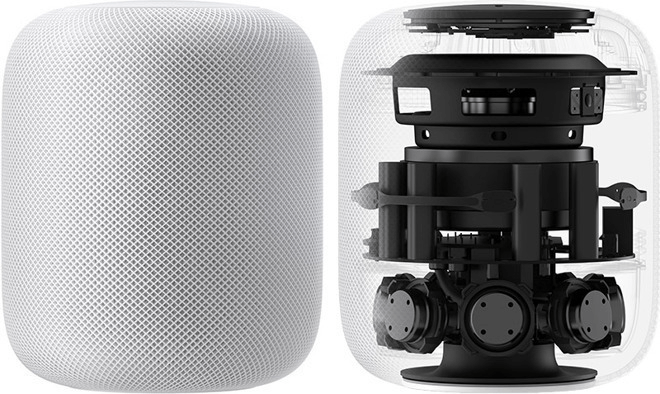

could 3D print some kind of omidirectional horn for a compresion driver + midranges as apple homepod? (would solve the multiple source issues).
Thanks Chris. I can't take any credit for the box construction. I think it was a wine gift box set or something. I did recess the BMRs with my router.
The dispersion is good. I know not ideal with L and R, I probably should mix the stereo and send mono to both but it's fine for garden use. If it's facing you can can pretty much walk around it 180° and the sound changes very little . Vertical and horizontal Polars must look pretty good.
It doesn't go too loud before I assume the 6.5 reaches its limit but plenty enough to annoy neighbours! And like your cool project Eric the LF is good at low level. It just uses a '2.1' Chinese amp.
