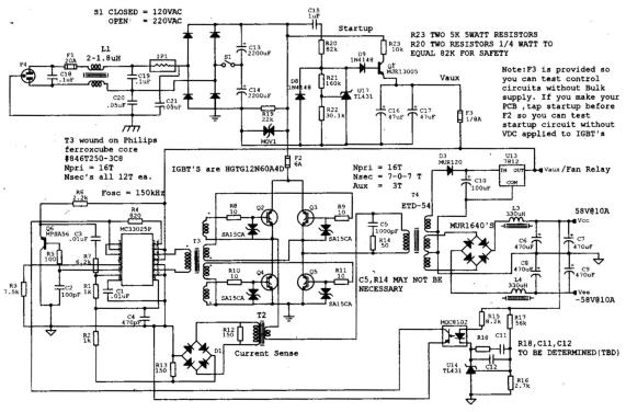

by the way, there is no information about line filter. what is desired value of inductance? and i dont understand which component symbol "275" connected after line filter. [btw it is called common mode noise filter, isnt it?]
inductionMotor said:by the way, there is no information about line filter. what is desired value of inductance? and i dont understand which component symbol "275" connected after line filter. [btw it is called common mode noise filter, isnt it?]

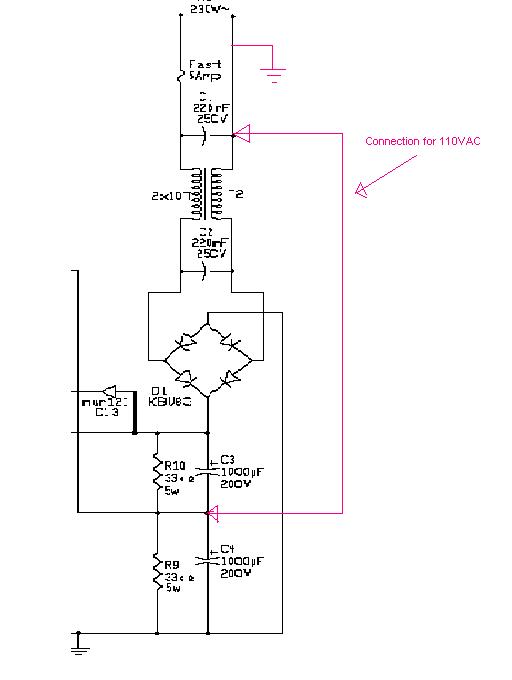

you can connect in 110 volt, but you must use simple transformer 110 volt to 12 volt instead of 220 to 12 volt and you must do main transformer 15 turns for primer and 2x5 turns for secondary is it ok?
Adnancoskun,
Thank you for answer, but you not understudy my question, I want feed the circuit in SMPS circuit in 110V and not in 220V, OK ?
Can you help me ?

ý understod you want feed this circuit by 110 Volt, is not it?
ok
1- did you see? 0-15 volt 8 watt transformer? it is 220 to 15 volt , it must be 110 volt to 15 volt transformer
2- did you see ETD 59 SIEMENS primer 25 turns 1.34 mm, seconder is 2x9 turns 1,68mm ------it must be 13 turns for primer and 2x5 turns for secondary
ok
while looking at half.pdf, you might want to upgrade your
4700uf caps to 100V to avoid fireworks 🙂
Valenca :
I think you must have misunderstood the message.
The mains input remains IDENTICAL . No skipping over as your diagram indicates.
You "missed" the fact that there is a small "transformer" to power the two IC's from the mains . THAT transformer must now be rated 110 volts primary /15 volts secondary . It is powered from the mains.
Also the HF power transformer windings are different.
Those are the only changes I think.
Hope I got this right .

About the S1 switch....
That is how computer "silver box" power supplies perform the 115/230 volt changeover.
If you plan on using a single voltage, just delete it. and put a jumper wire instead.
zerohead_ak47 said:updated schema

What calculation did you use to find the number of primary turns ? The one I'm using link returns only 10.5 turns. (f=50k,Ae 3.68, B=2Kg, Vin = 155)
edit : I already found the answer, it's pushpull so the Uin should be doubled.
Thanks - CC
