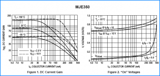

1. Discussing this resistor: R1 = 2k2 and the optimal value of it.
I suggest and guess a rather low resistor value, maybe even like ~100 Ohm
which means 'only 6-7 mA' passing in Q3 MJE350 driver,
at the moment Q1 runs empty = no current into Q2 base.
Setting R1 to 2200 Ohm, will give a lowest current in Q3 of ~0.3mA (300uA)
which in my opinion is not good ( getting into non-linear Turn-On rgion of transistor ).
2. Try with a corresponding Resistor in upper output transistor.
From Q2 Base to Emitter. Emitter is at Output.
We can call this resistor R10 and having same value as R1
3. Values to try for R1 and R10.
About: Q3, MJE350
..... is one TO126 transistor.
With cooling it can take a couple of watts. (Max rated 20Watt)
Safe opearating area (datasheet) of MJE350,
shows max 500mA at 20-30 Volt.
Temperature increase of cooled MJE350 is 6.25 C / watt.
At a room temperature of 30 C, we could allow say operation temp of 75 C.
75-30 = 45 C increase of temperature.
For using a 'safe value' of 15.0 C / Watt in a well cooled MJE350
we get:
3.0 Watt will give, 3x15 = 45 temp increase.
Roomtemp(30C) + 45 = Working temp = 75 C
This would not be too much! The ABSOLUTE max MJE350, TO126, can take is 150 C degreees.
MJE350 average working voltage is 20 Volt ( 50% of 40 Volt )
3.0Watt / 20 Volt =
Max 150mA Current at idle = Average.
Conclusion:
From a Temperature point of view an idle of 150 mA would be possible
But our datasheet ( OnSemi ) tells us
that MJE350 works linear only upto max 100mA, at temp like 50-80 C
See attached Figure of DC Current gain of MJE350.
Say Q1, lower 2N3055 runs at idle 1500 mA.
Say DC gain, HFE, is like ~50.
So Q1 needs maybe 1500/50= 30 mA into base, at average.
If we set Current in MJE350 to 70mA at idle, I think this will be a good value.
MJE350 will be working approximative:
70 +/-30 mA = between 40-100 mA
Even if this calculation uses DC Gain, the AC figures will be somewhat like this.
Maybe 70mA +/- 50 mA ( work within level 40-120mA at MAXIMAL OUTPUT POWER).
Now we normally DO NOT work amplifier at MAX
when we use it = Listen to music!!!
To set the working current of Q3 MJE350.
Target value: 70mA in Q3 at idle. (no music)
Q1 B-E Voltage: ~0.800 Volt
Q1 Base current: ~30mA
R1 current: ~40mA ( 0.040A )
Sum: 70 mA
R1 = 0.800/0.040= 20 Ohm
We make R1 = R10 = 22 Ohm
Each resistor connected between Q1 and Q2 (3N3055), Base - Emitter.
It is well worth test, with these values!
Lets see what this will result in.
If my Theoretical Calculations will match reality.
Thanks!
Regards
lineup

Thanks Lineup your extra resistor helps with the problem as it will maintain the same difference between the ac currents no matter the required bias current for the outputs. The amount of imbalance changed with current through the driver regardless of the value of R1 ,example... 20mA through driver, R1 =1k, 100mA AC from Q1- 150mA AC from Q2...... 30mA through driver, R1=1k, 100mA AC from Q1- 170mA from Q2, with everything else being the same.
I think that the biggest problem is in the voltage gain stage. I didn't really notice it until I begin designing for a 20watt moster on a 54v rail. Non-symetrical slewing. So now since the output transistor only produce about 2/3's of the swing for each cycle, the transistor amplifying the slew limited half will naturally have less rms ac current. This is also why the imbalance changes for a given signal level.
In order to cure most of the problem, add Lineup's resistor from Q1 base to emitter the same value as R1, 1k is fine.
Next we make the amplifier much less efficient than it already is. We need to change R3 to lowest value that we can within the power limits of Q4.
