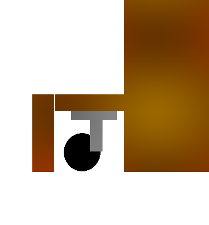

I think coupling cabinets with the floor is a myth anyway, conseder the weight of the cabinet compared to the mms of the driver.
Whatever the theory - Isolating it from the floor would make more sense. Use a few layers of carpet or some squash balls in divots in the bottom of the cabinet.
Or here's an idea for concealing the castors on the sides, could be dressed up a bit to resemble the steps in the horn mouth.
I'd use 8 smaller castors per cabinet to keep the feet narrow, it'd look tacked on if the feet are too big.
