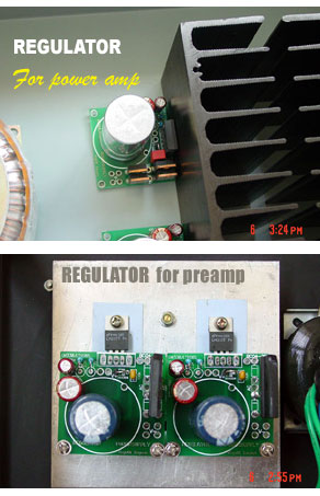

the regulator board purpose for general use.it can be used in all standard LM3875/3886 IGC or NIGC designs.Even a solid state power amp,such as JLH.

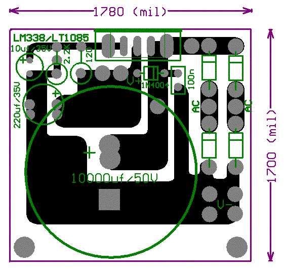

for somebody asks for print edition,
This project is a double layers design,I have set up via pad for tight the component legs.the track of circuit has only taken up bottom layer.If you want to do it yourself circuit board, here is the printable file.
digi01 said:high detail pdf file,feel free to use it.
enjoys
digi
digi,
Did you intend for the .pdf to be sized for actual size printing? If so you may have to recreate it.
It is very large if printed, filling the whole paper I think. Kind of neat to imagine components that big. 🙂
Hi Zang-
In post # 2 you have a picture of the regulator board "with" regulator installed.
What component is that?
I ordered the LM338 regs to build mine but I think they are to-220 package, and the one in your picture looks like TO-3P or TO-247.
If it is the 108x chips why is that one so much larger yet not handle as much current as the 338?
Which chip do you recommend for the highest steady current draw? No worries on heat, I will have plenty of heat sinking.
Sorry to ask such a simple question, but I just have a hard time believing that the little TO-220 chip handles more current than the bigger 108x chips.
PS- I have at least 5 prs of your regulator boards and I need to get them finished but want to drop in the best part...
