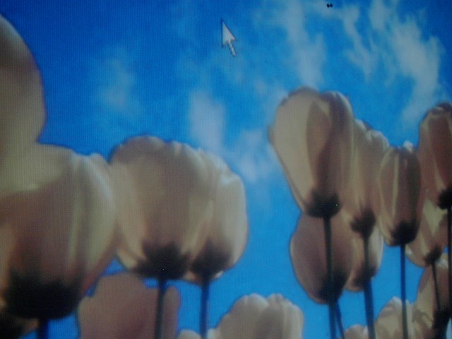

My Projector in a trunk

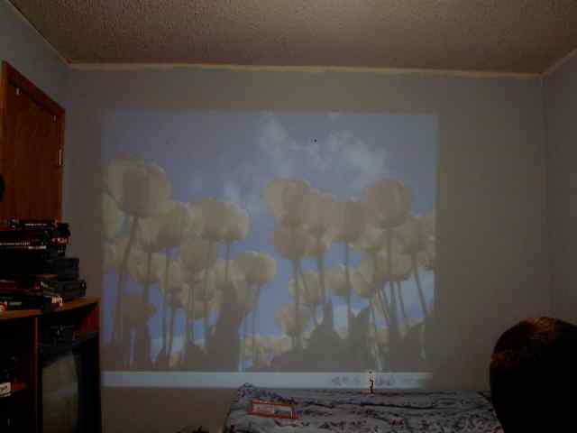

Here with the projector on and the lights on

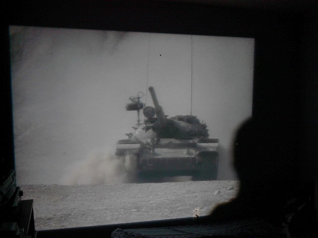

here is a tank from a movie, the screen was about
6 foot long in all the shots
There is still a lot of room for improvement - I is
bright enough - but what if it were brighter -
not more light, but use the light better - I may get
a condenser lens - Its way more than bright enough
as it is tho

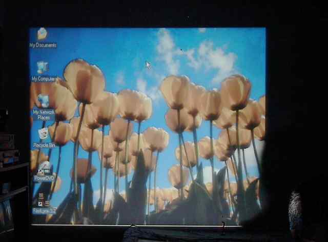

I thought there would be a bit of dark around the edge -
but there was not and my home made focus worked great
Thanks DIY Projector Company for the idea for the focus

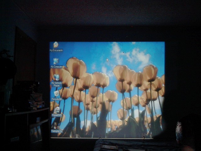

I had it on for 5 hours and it did not even get warm
to the touch on the outside of the box
I think it took about 30+ or so hours to get this far
I would recommend that some one build from better
plans than mine - But using the trunk is a good Idea,
I was never able to make a box out of wood, I
would always mess it up and it be lop sided.
Using a pre made box cuts the work in half
Thanks every one for the ideas - It works great

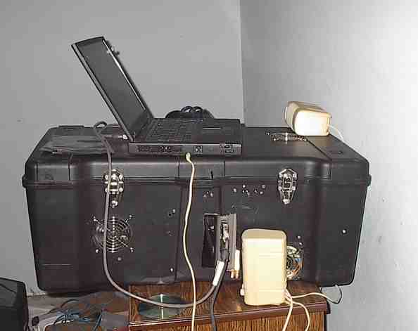

Here is the last pic of the trunk - before I messed it up
- I am going with MkIII plans - and am going to get the kit
- I have a friend that runs a computer shop - I am going to
let him have the box and OHP when I am done and keep
my light
He wants to make one and I am going to help him - when and if
we get it done, I will share pics of it - I think using a metal
frame mounted in the box is the way to go
