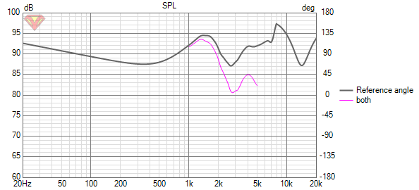

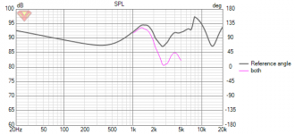

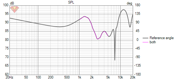

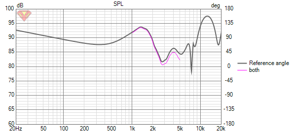

I'm now successfully doing dual channel measurements with REW. For years I have struggled doing measurements to determine relative drivers offsets. With this setup I finally got it done. Attached are screenshots my successful modeling with VituixCad simulation to determine the offset between a mid woofer and tweeter. I was shocked how well it worked. Pink is the measurement of both drivers on a flat baffle black is model of both drivers. 0 mm, 16mm and 18mm just to show the two graphs converging.
