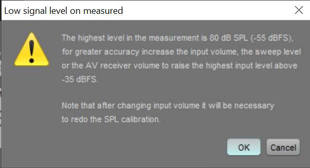

Let us know if that works for you. I have found that the mic and preamp just don't have enough gain, so the input has to be cranked up pretty high. I understand the desire for a calibrated setting, the lack of a detent makes repeatable gain difficult. Just be careful at max gain, I've found it very noisy. Maybe with the 20dB pad it won't be, but be careful. It's like you get to ~95% volume and all is good, then noise goes way up if twisted beyond that.
Happy Measurements!
Hi again Lament,
Pano is right, unless there is a reason you need accurate SPL calibration, it's "who cares" if absolute SPL readings are off a bit.
For me, i use REW primarily for measuring distortion, and at very high SPL outdoors. So the minimum gain setting on the UMC works for me.
Like i said earlier, probably not the best advice for the regular REW user..... At the time the thread was more about solving input overload.
As far as a soundcard with recallable preamps in software, i do not have a known good recommendation. I'd probably look to Motu or similar, and try to find the lowest cost unit that has software control. I use either a X-32 mixer for multiple mics, or a babyface pro for a single.
