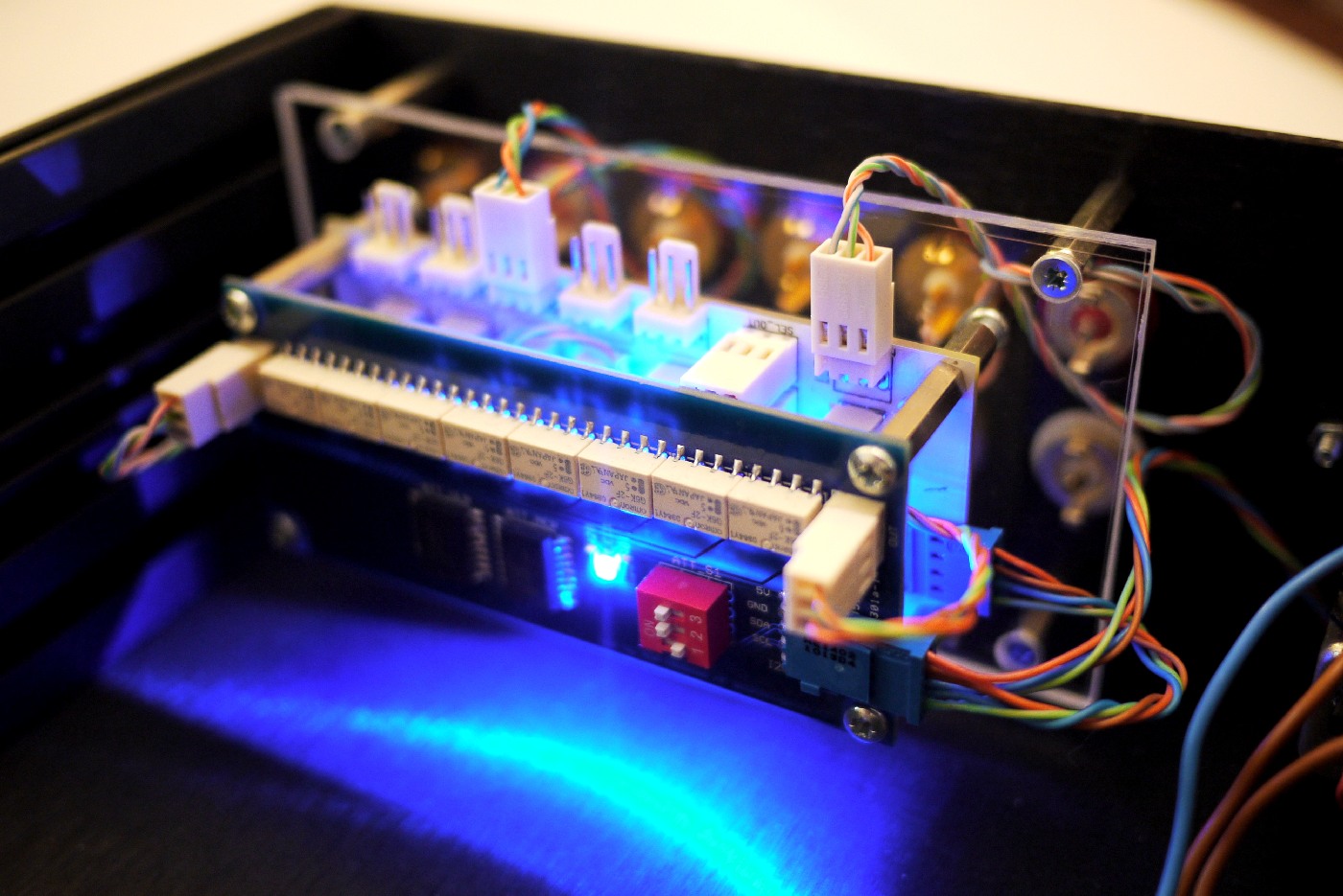

I notice your relays have no protection diodes, Are these needed? also On your schematic you have 5v connected to to of the ic2 pins through resistors , what are these for and what value should they be.
I didn't bother with them and it seems work fine.
Those resistors are the I2C pull up resistors. Mine are 4.7K but they can be any value from around 1k to 47k. Google it, plenty of articles.

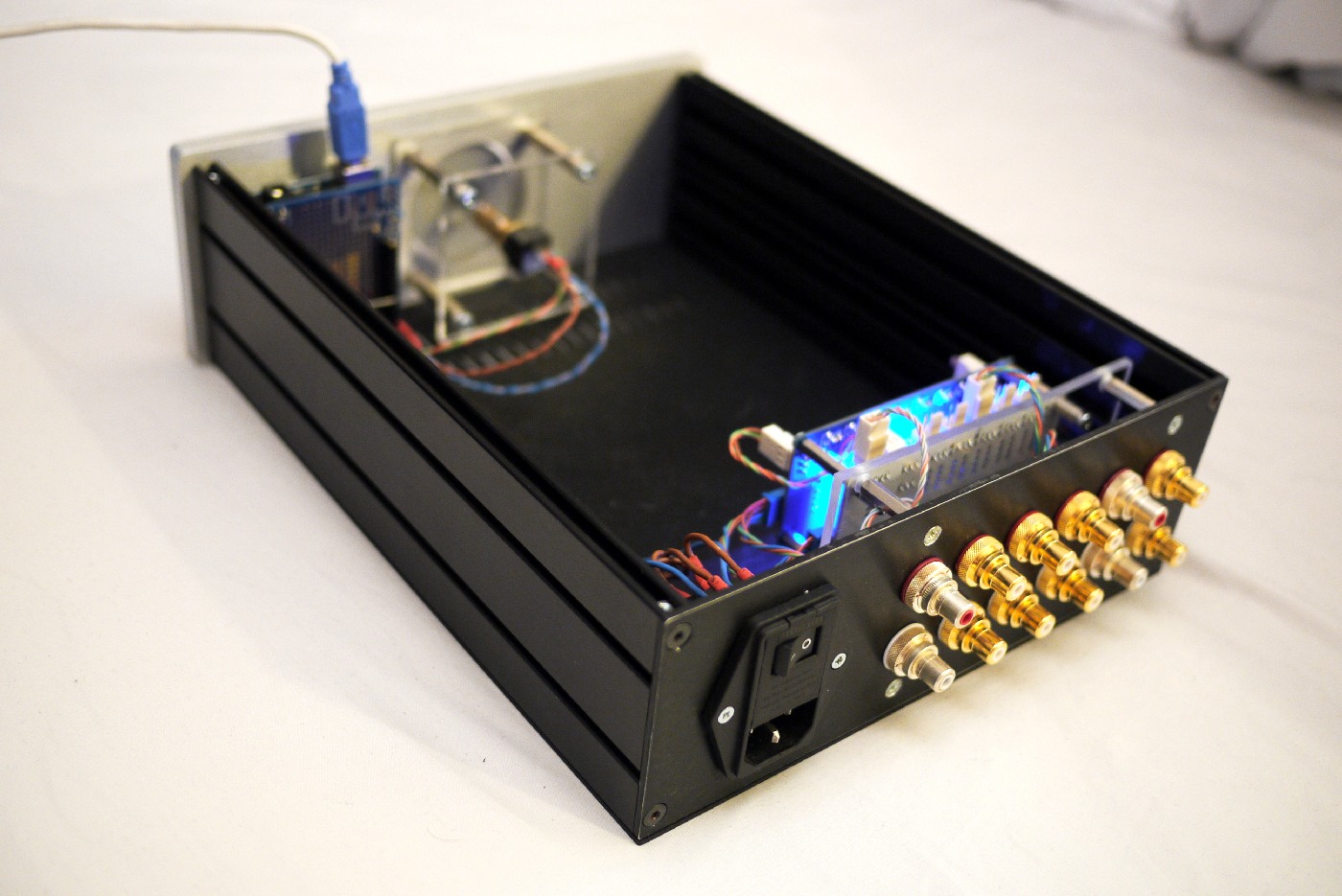

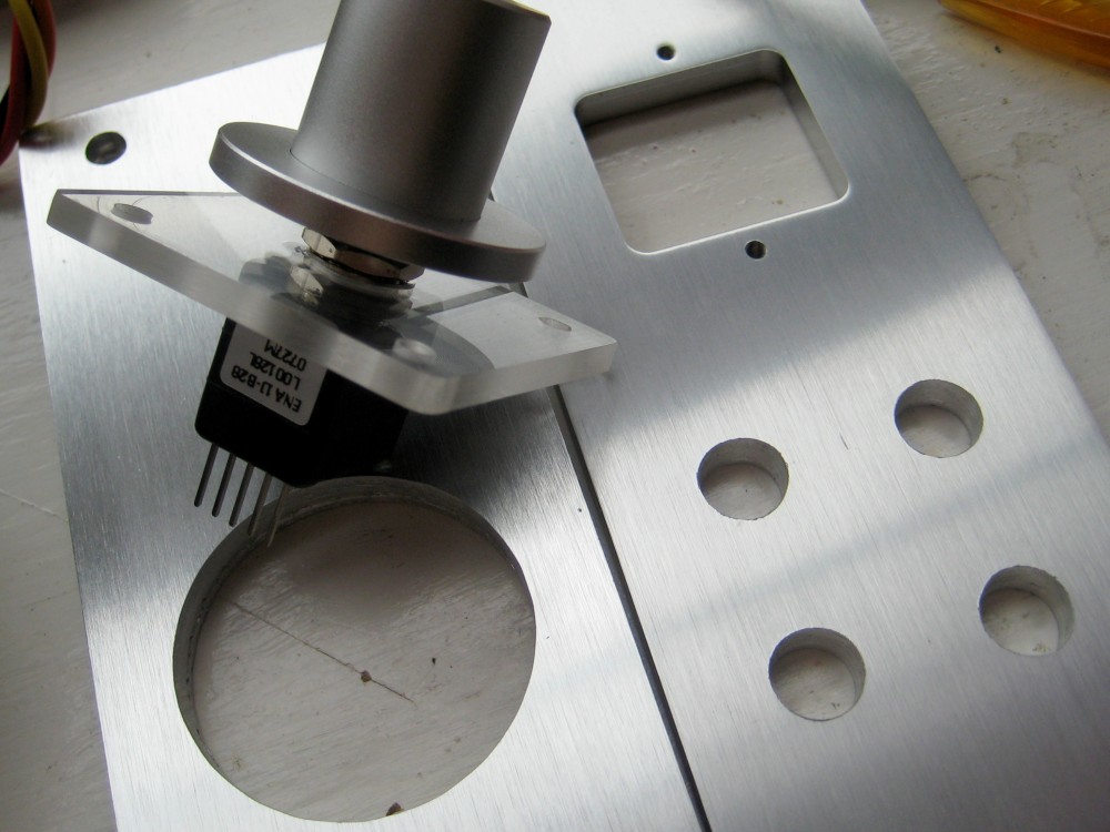

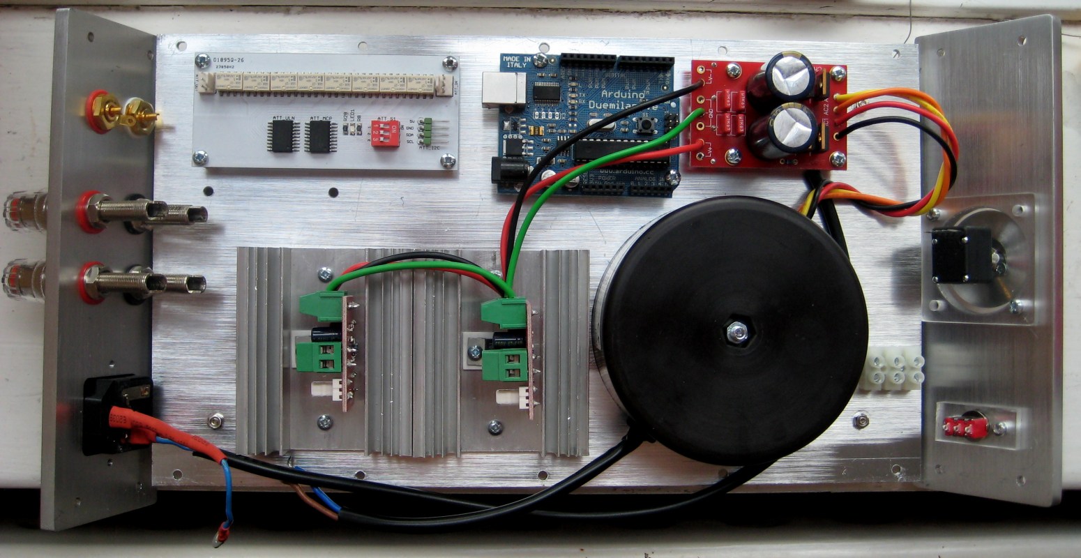

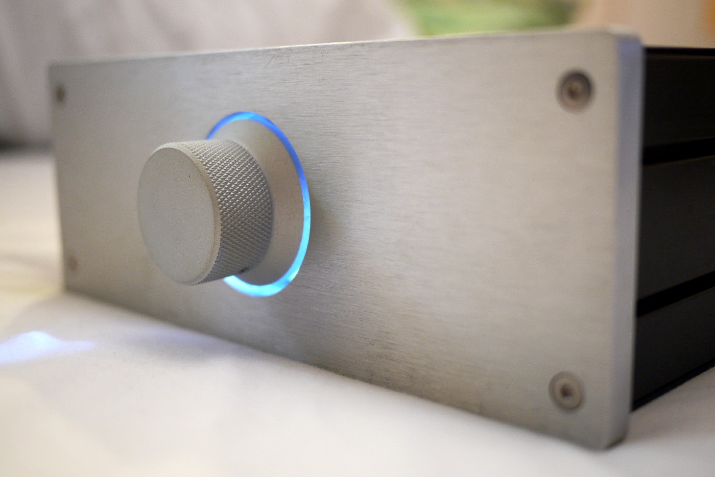

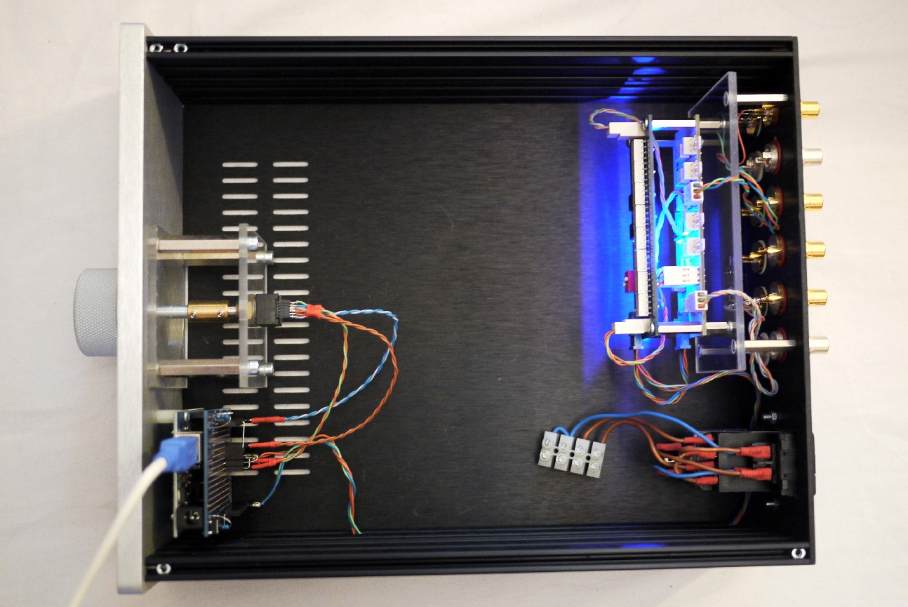

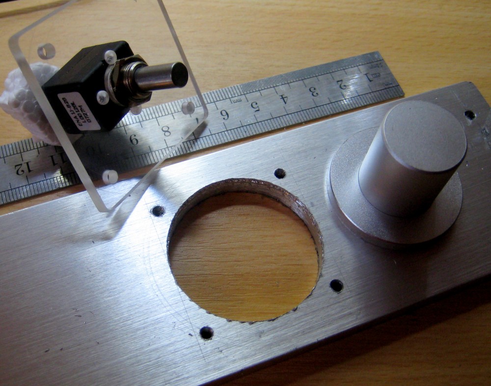

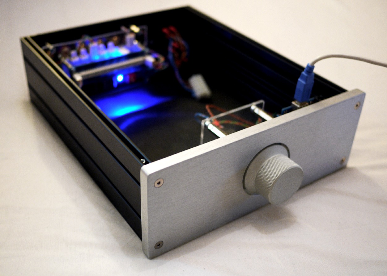

Here is my new case. I've opted for a completely passive input selector and attenuator for now. Both controlled by the arduino. Pics don't show the PSU but its just a small toroid and 5V regulator 🙂

Beautiful!
But how do you know what setting you are at, in terms of both input and volume level? You would probably need a lcd display for that.
Also, a bit off topic: What camera are using? 🙂 I ask because the noise shape reminds me a lot of the SIGMA slr, and no other digital camera that I know of can render this film look.
Great work, Max!
I like the plexy and arduino mounting ideas!

Thanks!
Well I did a lot of thinking about this and basically I think standard LCDs look tacky and cheap. I wanted something minimal that looks nice. I also figured that I don't really need to know what input I have selected if I can easily cycle through them in a loop until I hear what I want.
What I have done is set up a BlinkM that changes colour with the volume level. This is behind the volume knob, inside the case. It is an I2C controlled RGB LED. So it goes from Blue>White>Red as the volume gets higher. It's a really nice effect and I think works well. The encoder is also a push button momentary switch that changes the input.
