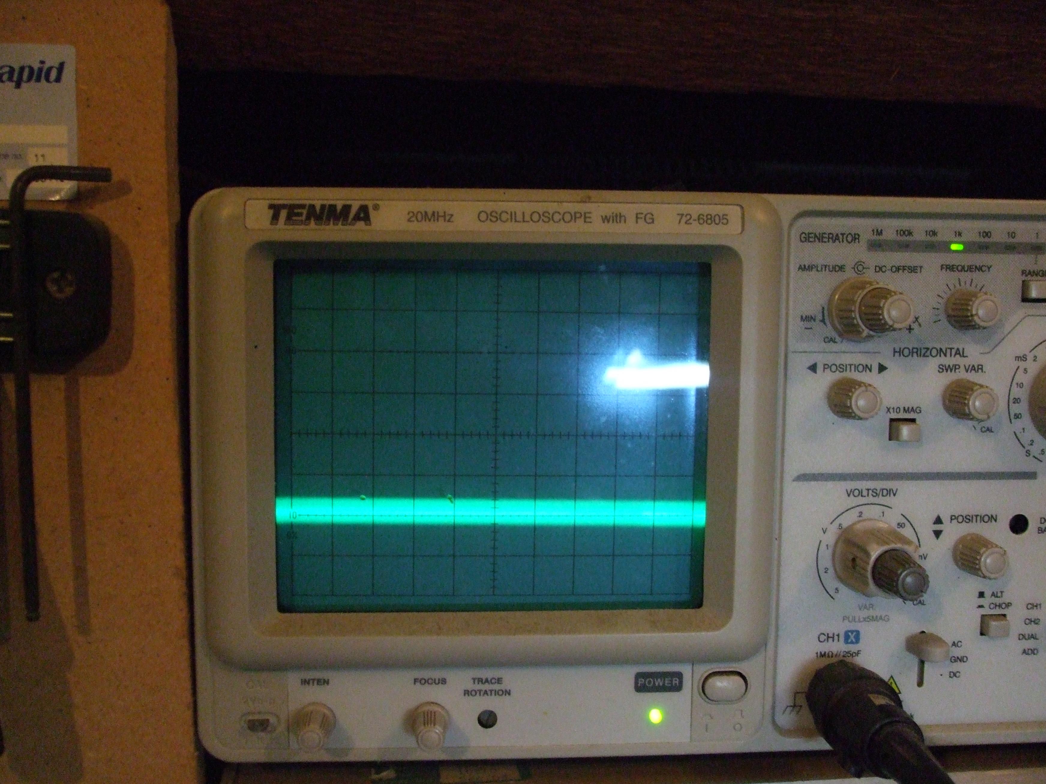

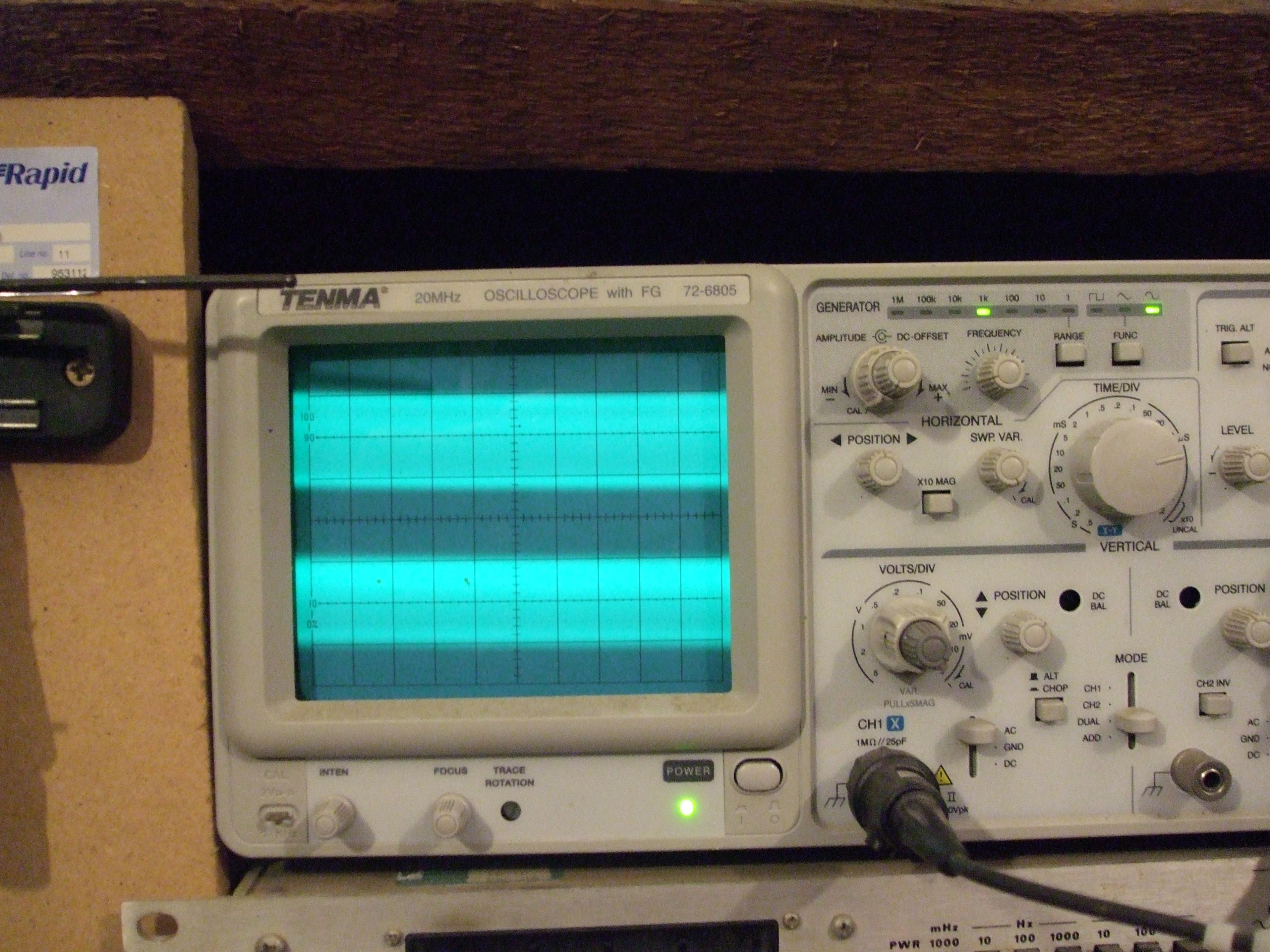

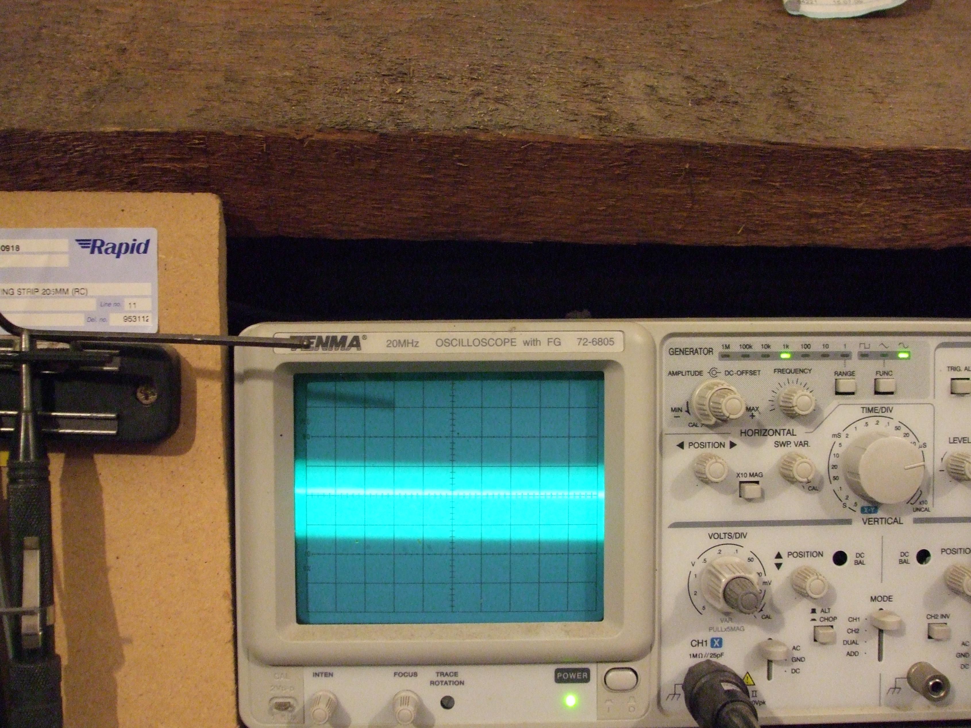

Sandro thanks for the cross test on scoping the rails. I get the same weird hash on RIGOL DSO and CRT Hameg too. Maybe bit less in amplitude but still too much. But it does not jump in the signal FFT as high hiss. Maybe EMI on the ground plane or something, don't know. Its not a special bug with the Toshiba semis I used in the PSU at least since it cross checks with your build too.
There must be something noisy in the Vref (LEDS) or its the error amp's CCS (J310). The LEDS have some 100uF cap and there is an RC filter though. Weird. Others must scope the rails to see too.
Compare with the 3rd picture
Toshibas make big difference.
Not tried the capacitors changes
Maybe Frans could help?
I'm trying (Salas and I have exchanged a lot of mails today). But it is not definitely clear what the problem is. For sure you need to use fast (D44/D45H11 of faster) power transistors, when using slower transistors the PSU must be compensated and performance is (slightly) compromised. Current knowledge shows that the (small amount of) noise not enters the RIAA and thus, the PSU is as clean as needed (and cleaner than most 🙂).
My own examinations of today show me that the J310 may be marginal and later I will publish some data on this, and guidance on how to improve the situation. It is, at this moment, not clear if the measured noise is caused by using the J310 🙂 but for sure there are better fitting, for the application, FET’s available.
P.s. That will be posted in the Paradise Builders forum.
