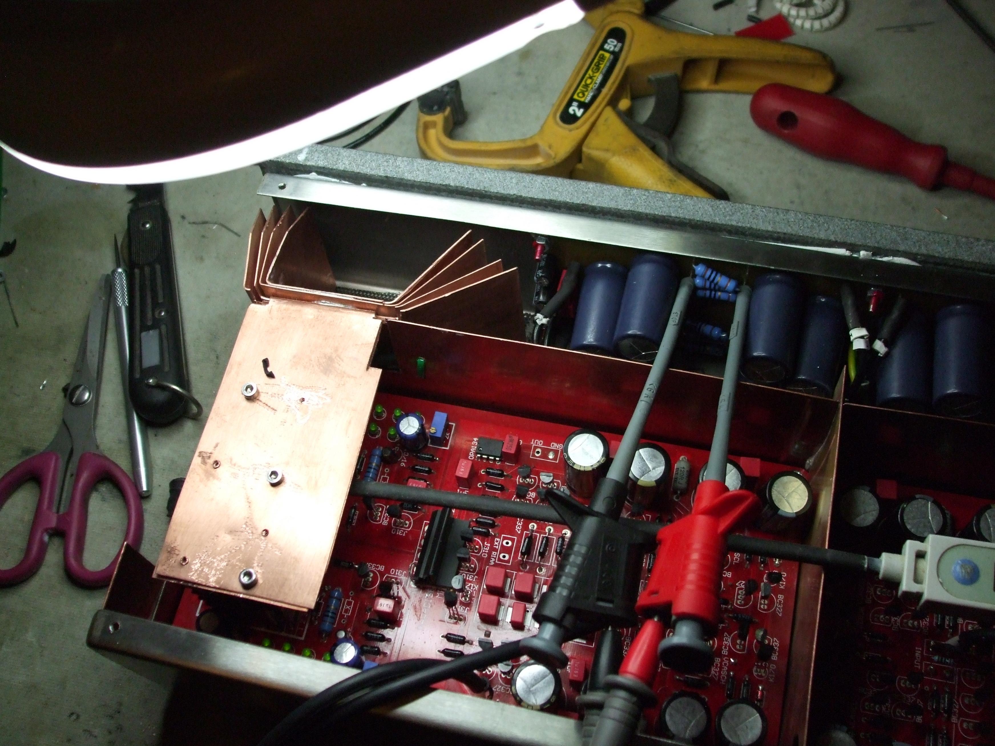

Right with cooper sink extension
Left no sink extension
Overview off set up
With my set up (Selectronic Trafos nominal 24 V in reality those have same random V out (about 29 V AC under Paradise load))

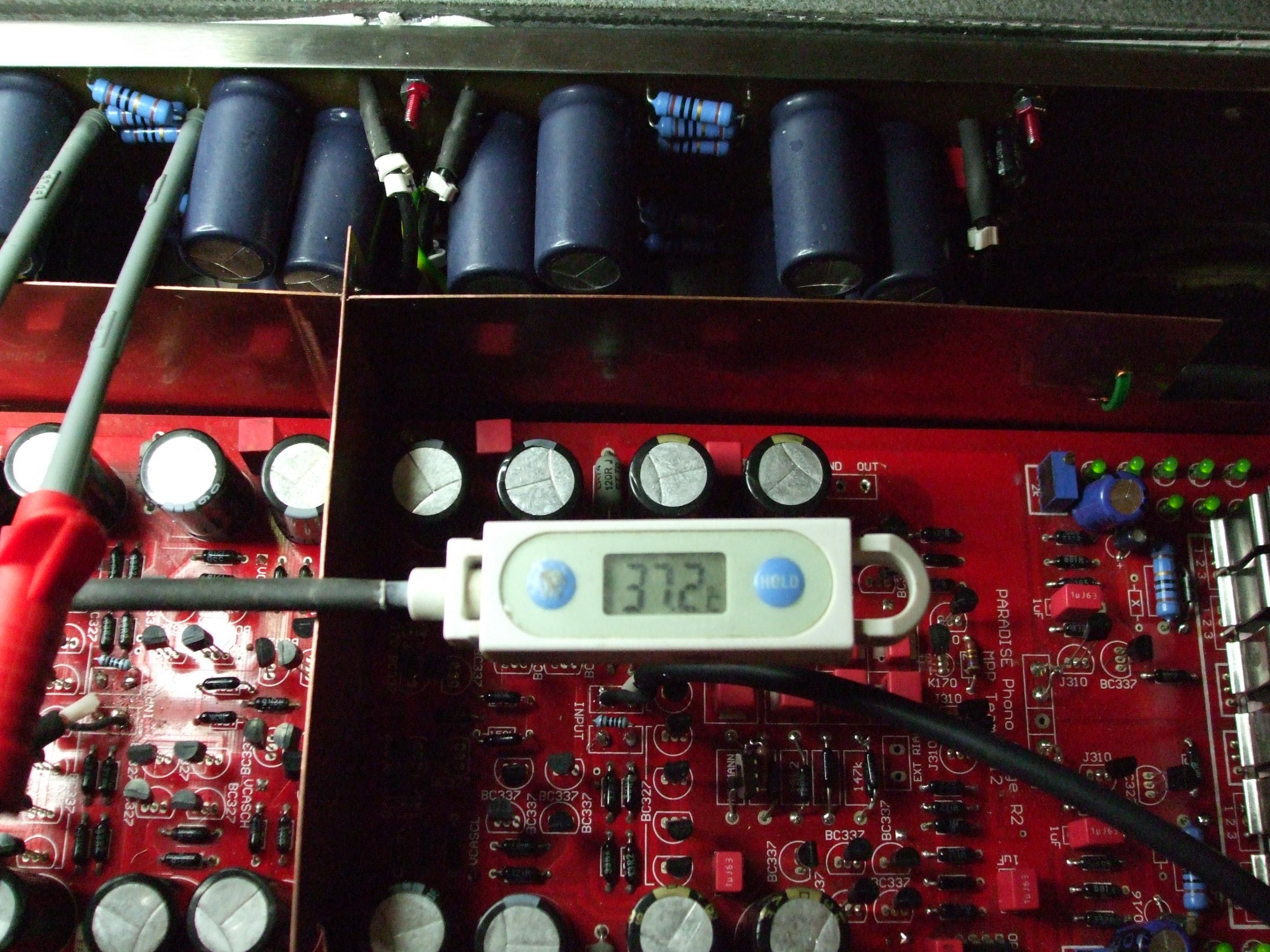

34 V to the boards causes the sink to go up to 50.1 C
Using the cooper Extension helps and the temperature is down to a 37.1 C
This is whiteout lid in pretty cold loft.
Paradise for Dummies (like me) Notes😉
1) If you can do not feed the boards with 34 V
2) If traffos are to hi further CRC stages help and supply is cleaner I got CRC cable CRC (on board supply is quite good so proper trafos and no to many CRC work fine )
3) Take your time setting up the clean supply voltage (+ - 18 V) as when sink warms up it does drift a bit
Overview off set up

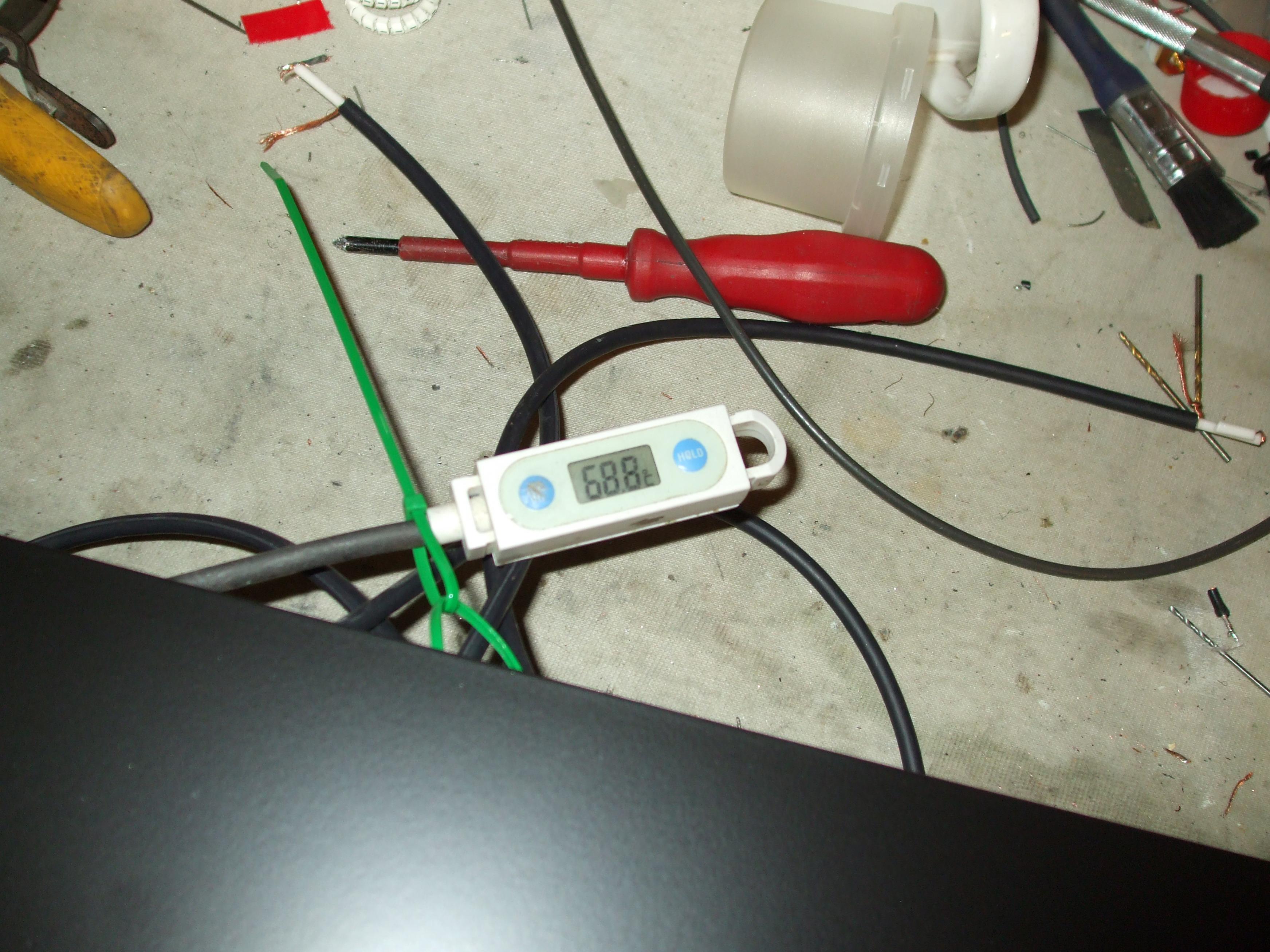

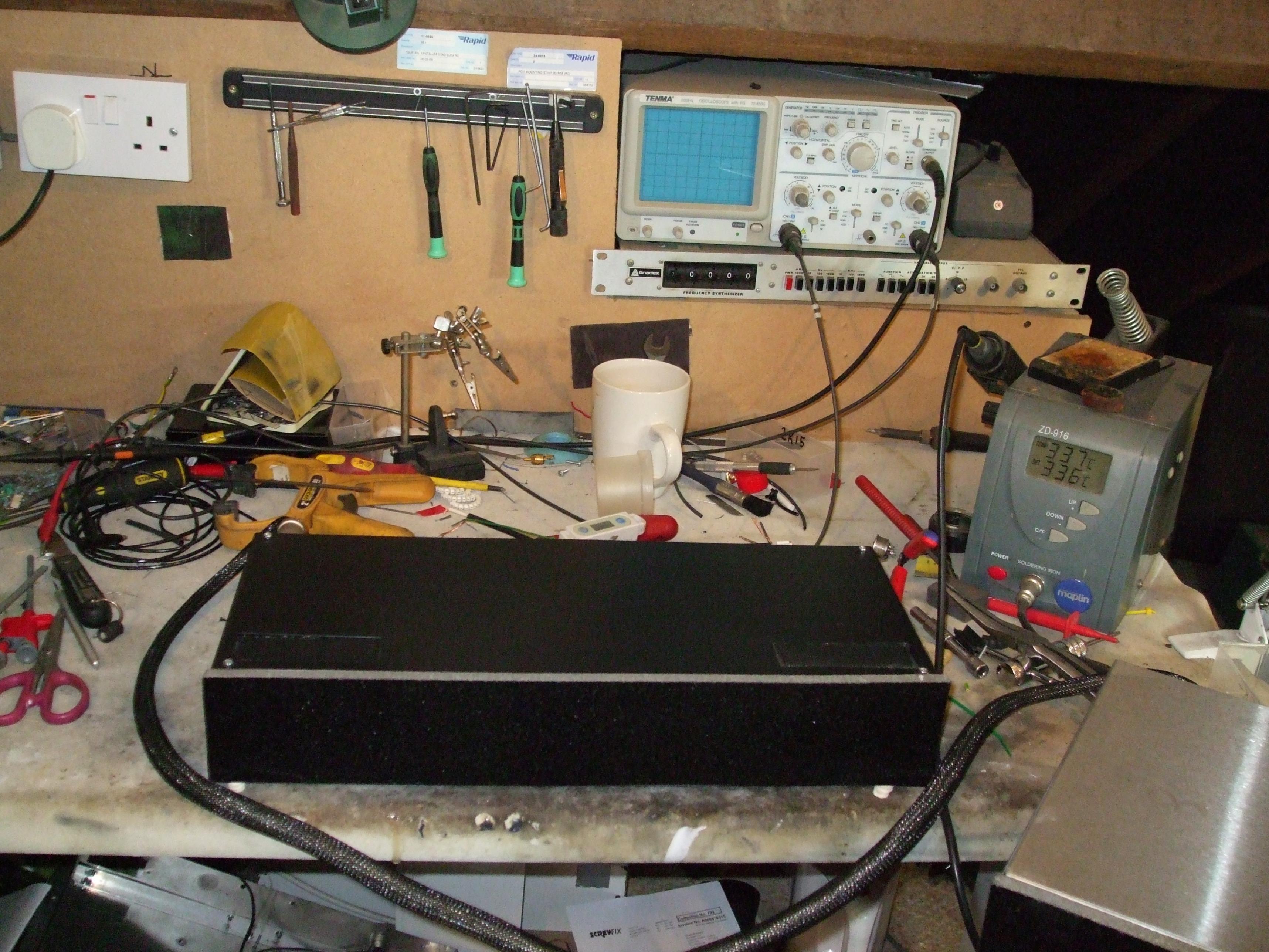

Lid on, sink temperature with no extentions.
1) Heath inside case make components age faster and causes voltagge drifts
2) MC RIAA stages need good screaning
3) Holes in case compromise screaning and air currents cause voltagge drift
(just blow on input transistors to find out)
I am going to take a few turns of the transformers so to drop the voltagge
it is easy enough to do with race cores.
PS UK mains is 240 V AC nominal so if not in the UK you may be ok 🙄

Yes it is other sink is at 48 C with extra fins
So, no much fuss needed to get existing one working, I am going to drop a couple of Volts from the Trafos and it will be OK
Phono section is going to be inside a box inside a box, so isolated from heat off the power suply

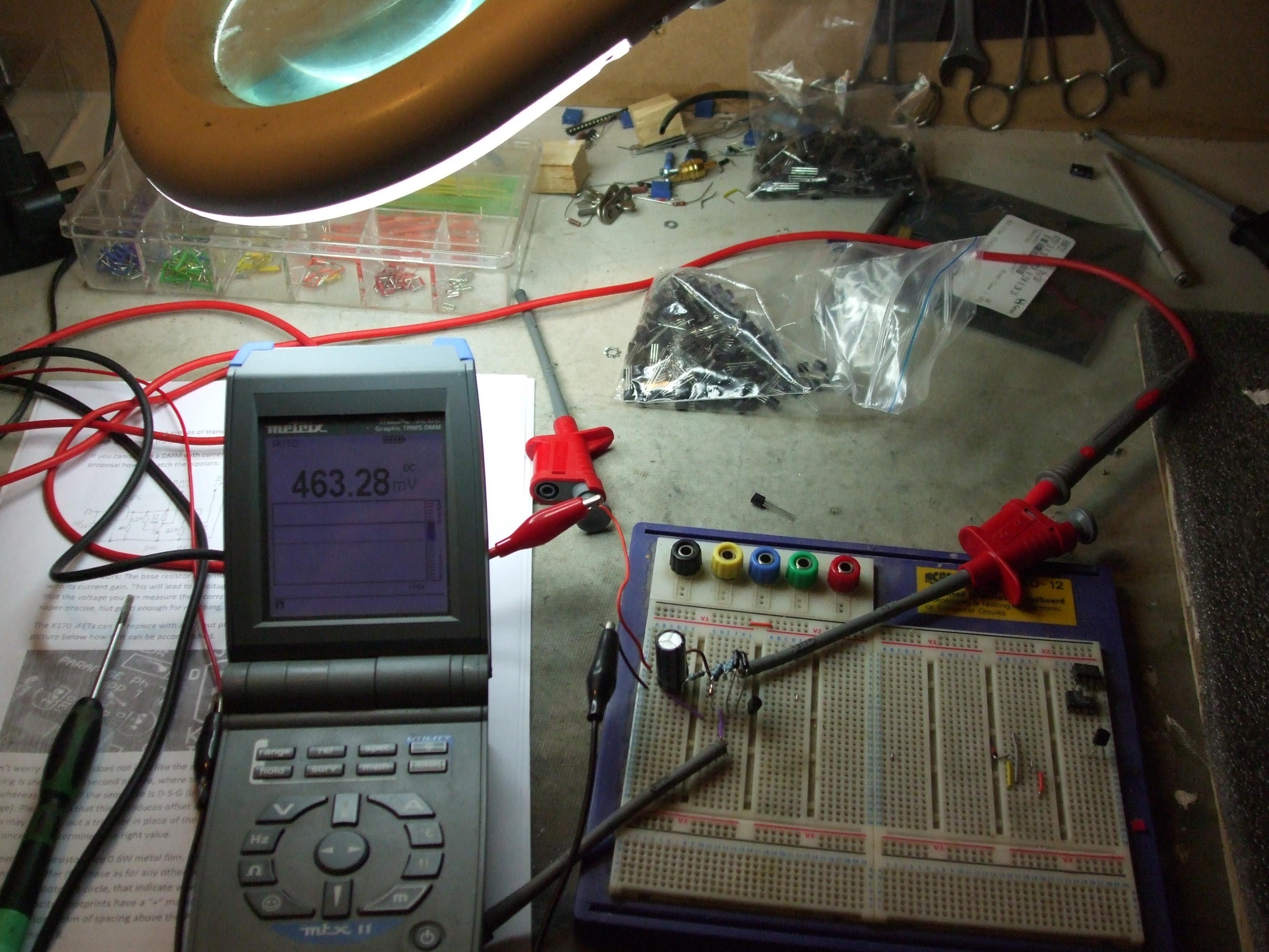

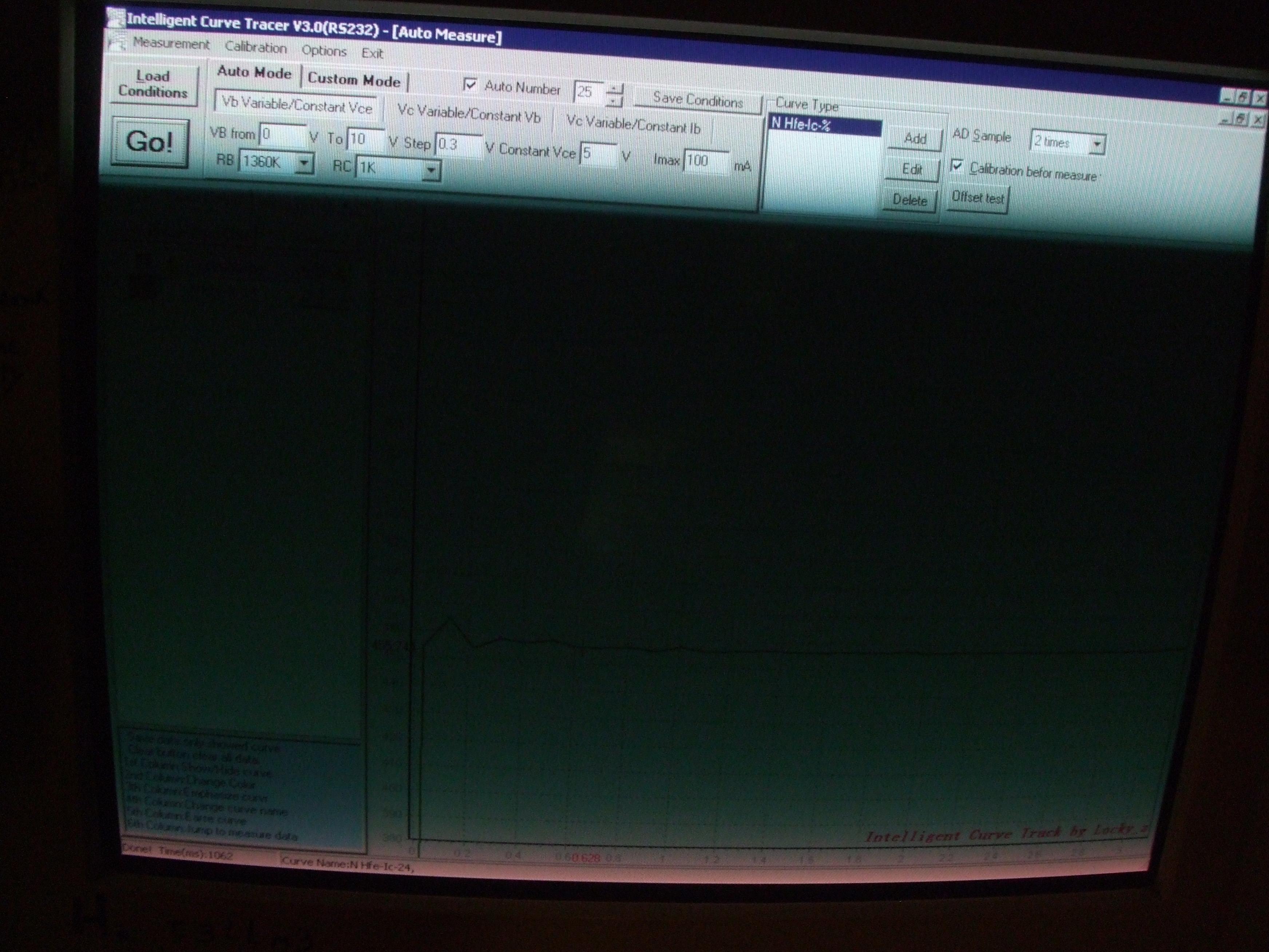

Any way I got my R3 boards so I realy have to start on it.

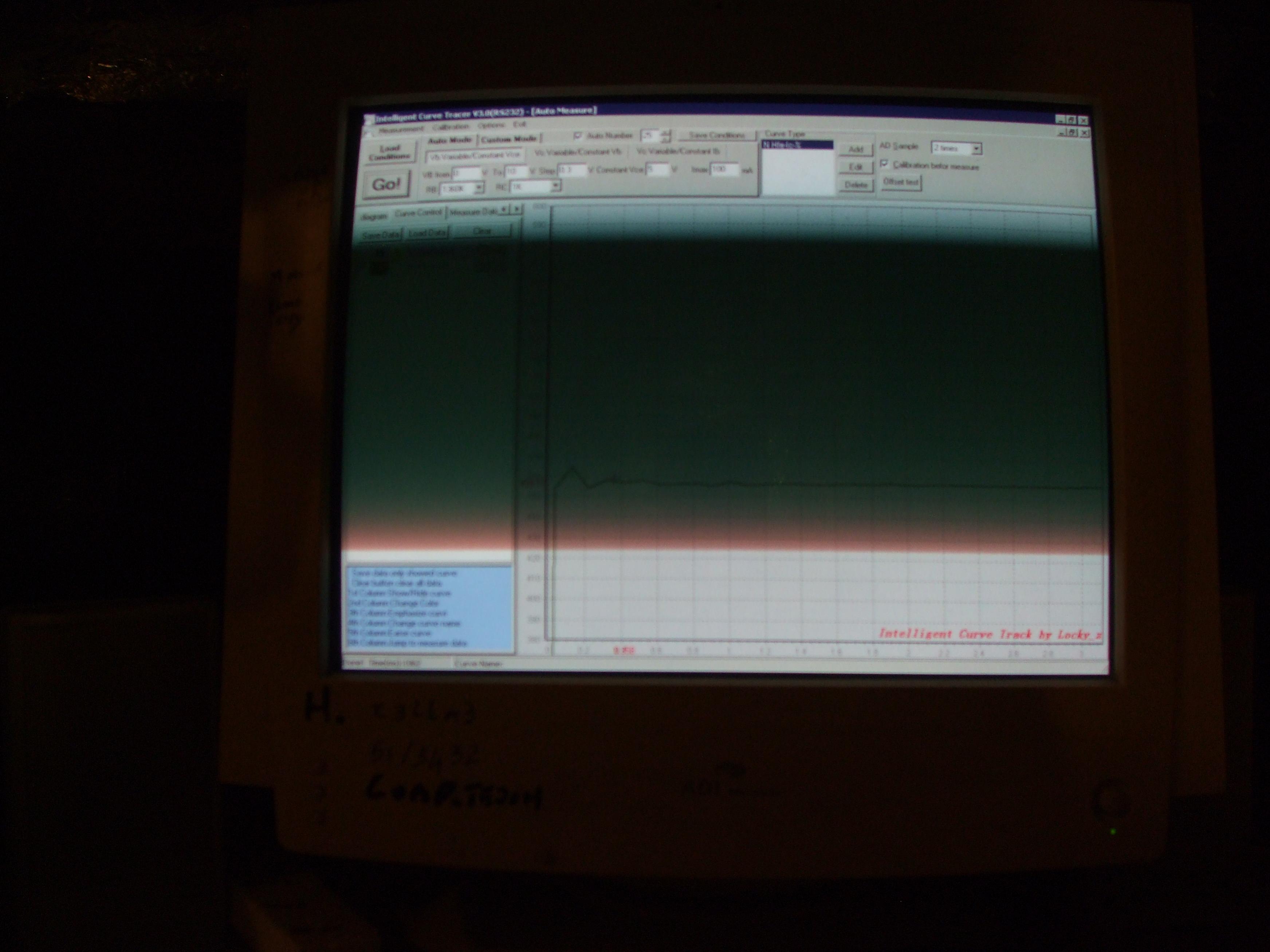

First thing I am going to do is sort out the Transistors
I tried the Atlas a curve tracer and the litle test circuit as on the guide.
So far a small batch of NPN
any way
Atlas sems to be on the low side
Curve tracer is ok on NPN (did have problems with PNP) mesure 455 (sorry for picture quality
Litle circuit mesure 463
So score is :
I like litle circuit a loooooooot
no much difference from curve tracer and extra super duper precision is not needed as if 2 transistors mesure the same they be the same, altrought with small error due to resistors tollerance.
Only snag they need same tyme to setle but for one that is only going to build paradise to listen to his record collection the litle circuit is prety good

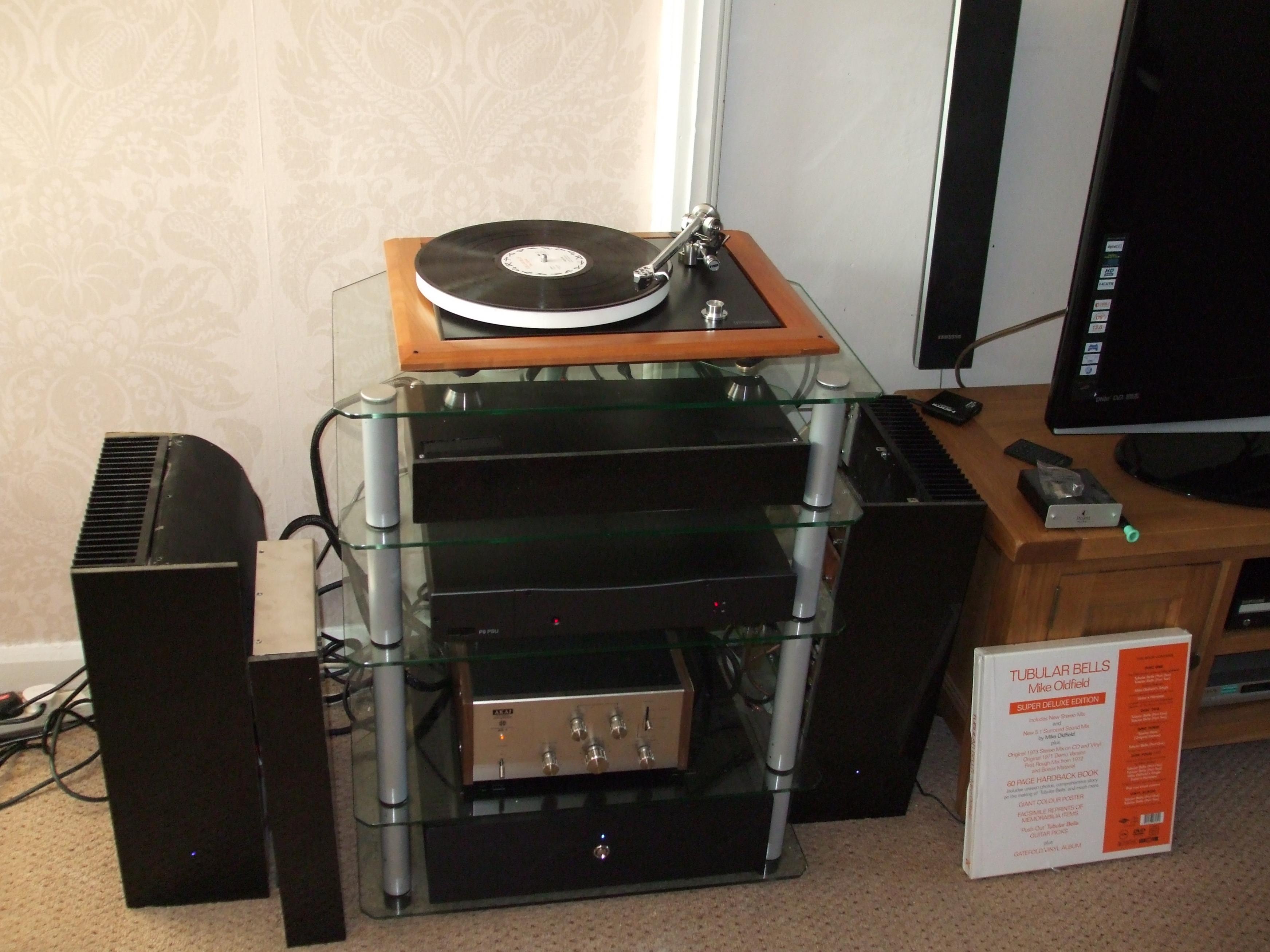

Borowed TT
She is out babysitting so suprise ready for later.
Do not worry in case of major hearth quakes or sonic boom.
Difference is amazing compared to my old TT and Paradise is well wort it
I am still listening to very hot R2 it has been on since early this morning and no smoke so far.
I am open for sugestions on new TT up to £2 k
any beter than Rega P9?
