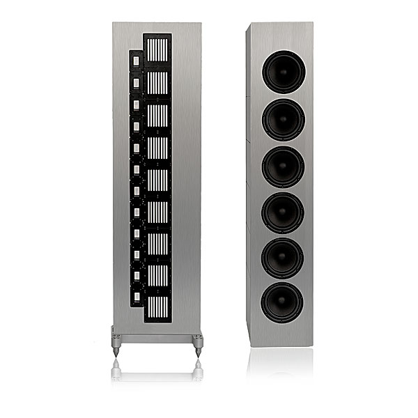

If i could get as much as almost double the length i would be happy...but probably i will end up with an exposed area of 10-10.5 cm X 18-19 cm.
Mated with a custom tweeter with the same exposed length...side by side...perfect array...something like the photo...

I'm really interested in this. Subscribed. Like the design goal.. 200-4k.
Low impedance amplification is no problem I think so this I believe should not be hindering. 4 ohm resistive no problem - even 3 is ok.
Open also backwards (bipol).
