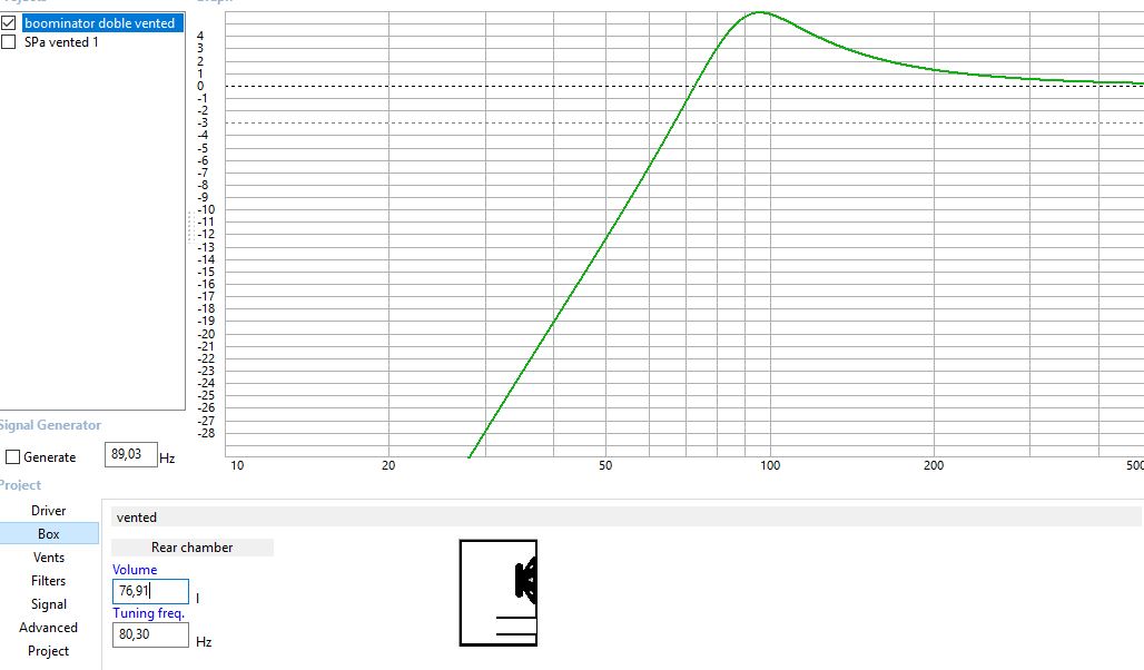

I will build a Boominator but i want to do it mono with two drivers P-Audio HP-10W and only one tweeter (need help) everuthing connected to a 80W amp and 24V 10Ah battery.
Can you please help me with the tweeter and the crossover.
This will be in a vented box.

Use the Eminence APT-80 tweeter, put a 6uF capacitor on the tweeter and a 0.18mH inductor on the woofers (which you wire in parallel). That's 1st order at 3.5KHz, this is perfectly adequate for a battery powered amp, and is going to sound excellent, but keep in mind if you ever going to use a bigger mains powered amp you and turn it up, you will blow the tweeter.
You can not design a x-over without first measuring the finished cabinet, as response and radiaton depend on it. If you ignore this, the result will, at best, be a combination that does not burn the tweeter. An electrical x-over has nothing to do with an acoustical one.

Thank you for your help. I´ll use a DSP miniDSP 2x4 Kit Digital Signal Processor Assembled Board , Im studying electronics but the world of sound is so big for me so i need a little help with the design, my idea is to make a loud speaker with good bass for techno music. Sorry for my bad english.
keep in mind that you need two amps and probably a minimum of 200mA, which will be 3 times more than using just one amp, the minidsp will draw at least 75mA, in real world listening this will essentially half your battery time.

Sorry, but 3 woofers do not work with 2-way, the idea was a W-T-W in horizontal order.
The third woofer will give cruel comb filter effect`s.
Also these woofers have Fs of 80 Hz, so no bass if you use moderate sized volume. 3x100 liter might be to big?
I think I can use three wofers because im going to use 4 litlle amps and a DSP to get the biggest SPL possible, one mono amp for each driver.
And I know that they have Fs of 80Hz but in the first post of the Boominator Saturnus said "Trying to go belong 100 Hz in free-field is nonsense if you keep the other design parameters in mind. It's better to have a good middle bass performance to compensate for the lack of real sub-bass."
Hi, my approach is always good sound quality first. SPL comes by it self, if you use the right drivers. The small horn is a compromise, just as the speakers are. So you have to use quite good woofer to have them perform at a very high frequency.
If you use a DSP, you can have very steep low and high cuts. Which makes it possible to max out the horn performance wise. If you want to use 3 woofer, you have to go 3-way. One woofer serves as a mid speaker too, while the others will just give lower bass.
If all 3 woofer perform in the same frequency range, some frequency will cancel out, giving strange results you can NOT correct with equalizing.
