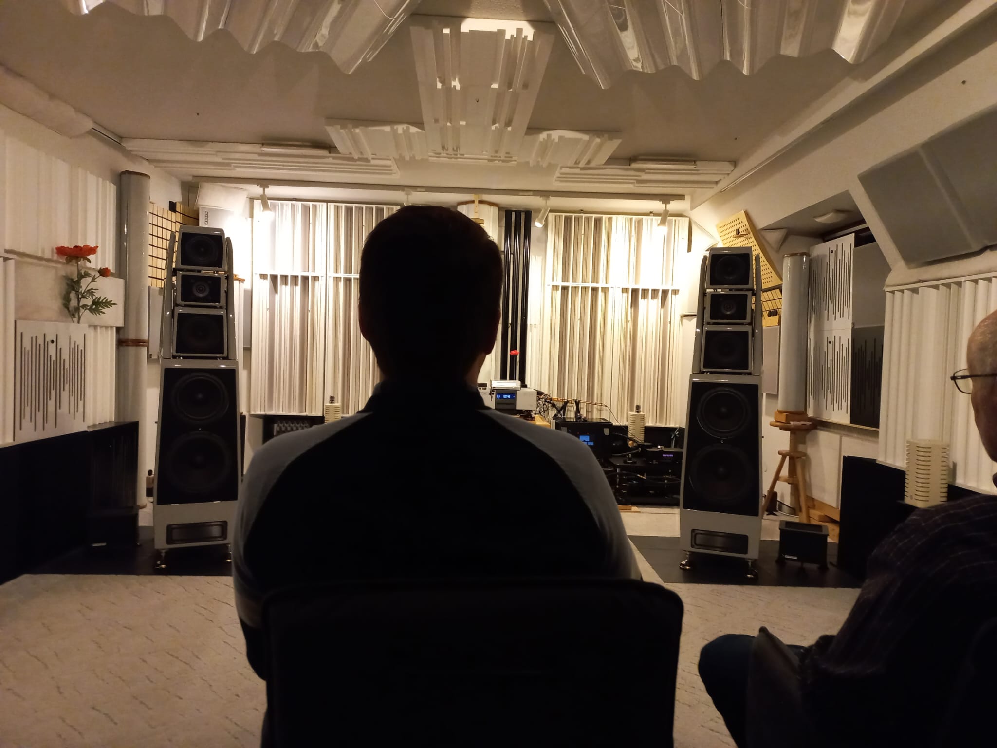

Here in the picture it's me, listening to an extremely expensive equipment of one of my friends (Spectral, Wilson Audio, MIT cables, etc...)
Great clarity end everything, but after listening to open baffle or Magnepans (as did another friend who took the picture behind me) everything in a box sounds like - a box.

Yes, what you’ve got even with low-freq. extension being limited is better than most show exhibits IMO (regardless of cost).
I haven’t heard a good closed/vented box system that was overall better than a good open-baffle 70-300Hz. I will say though that the older large Kharma’s from almost a decade ago that used larger Eton woofers sounded really good harmonically with decent clarity in the same freq. range, different but close to being as good as open baffle from more than 2 demos I’ve heard (it was bass-reflex).
