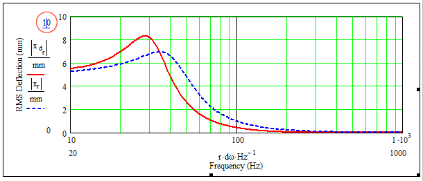

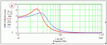

Rudolf,
Got it ! Thanks !
When I talked of 7 mm (in absolute terms) cone movement in post #327 I applied the rule of thumb multiplication with SQR(2) to get a reasonable measure including most all of natural spread. I would think this is a reasonable way of dealing with measures like this.
