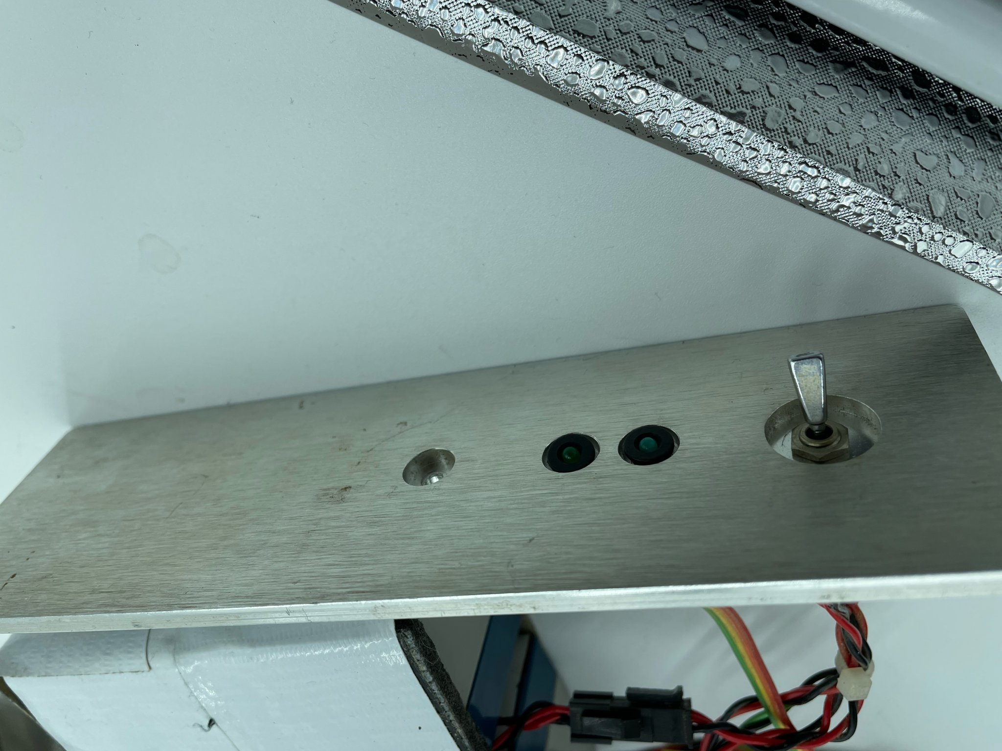

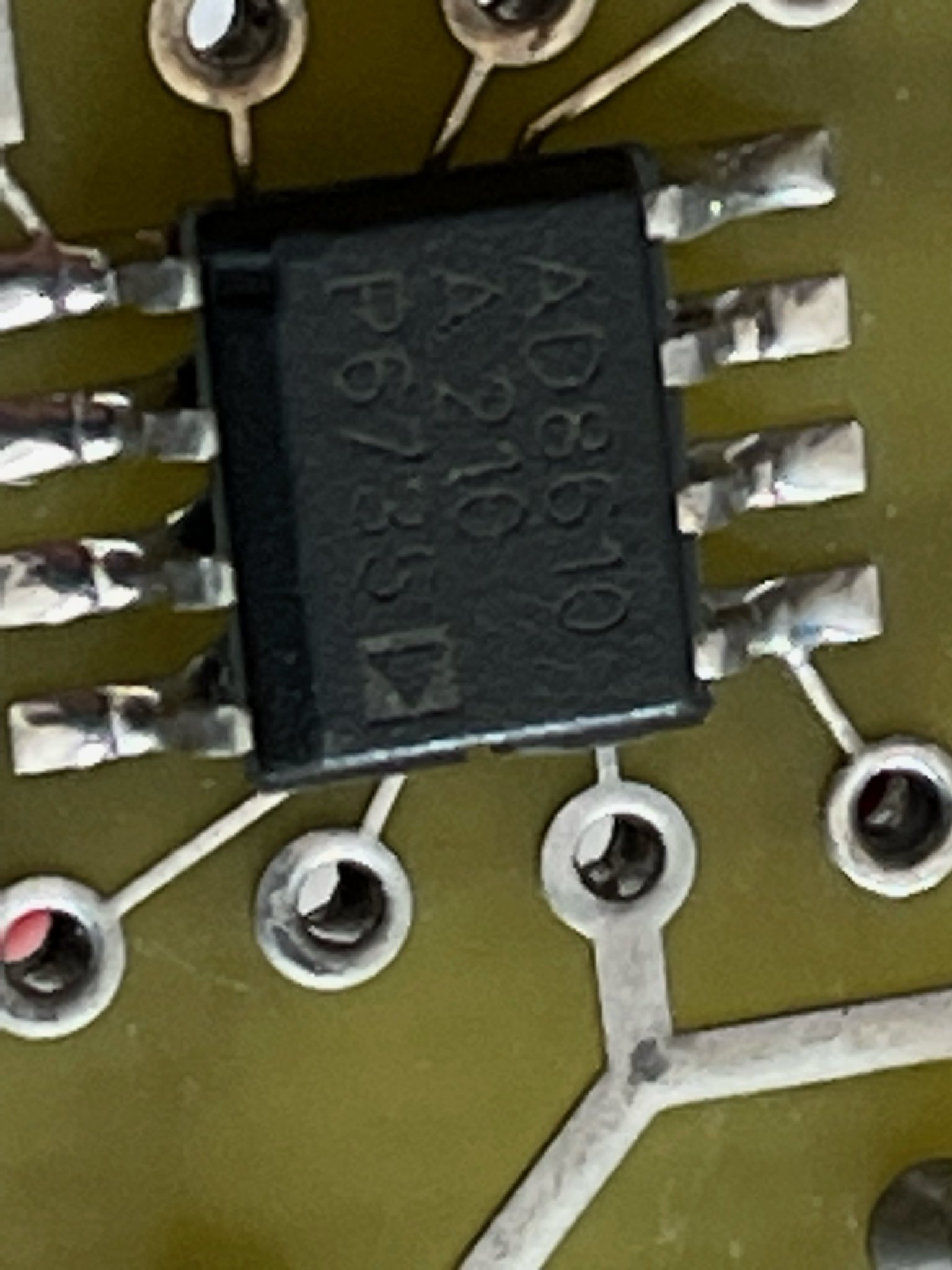

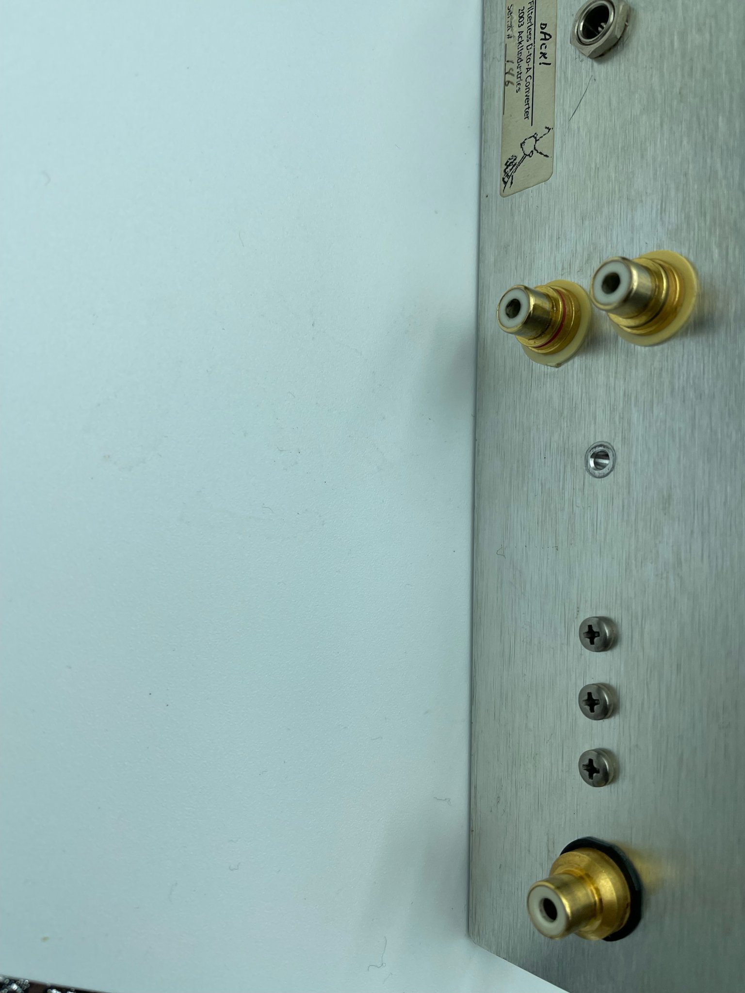

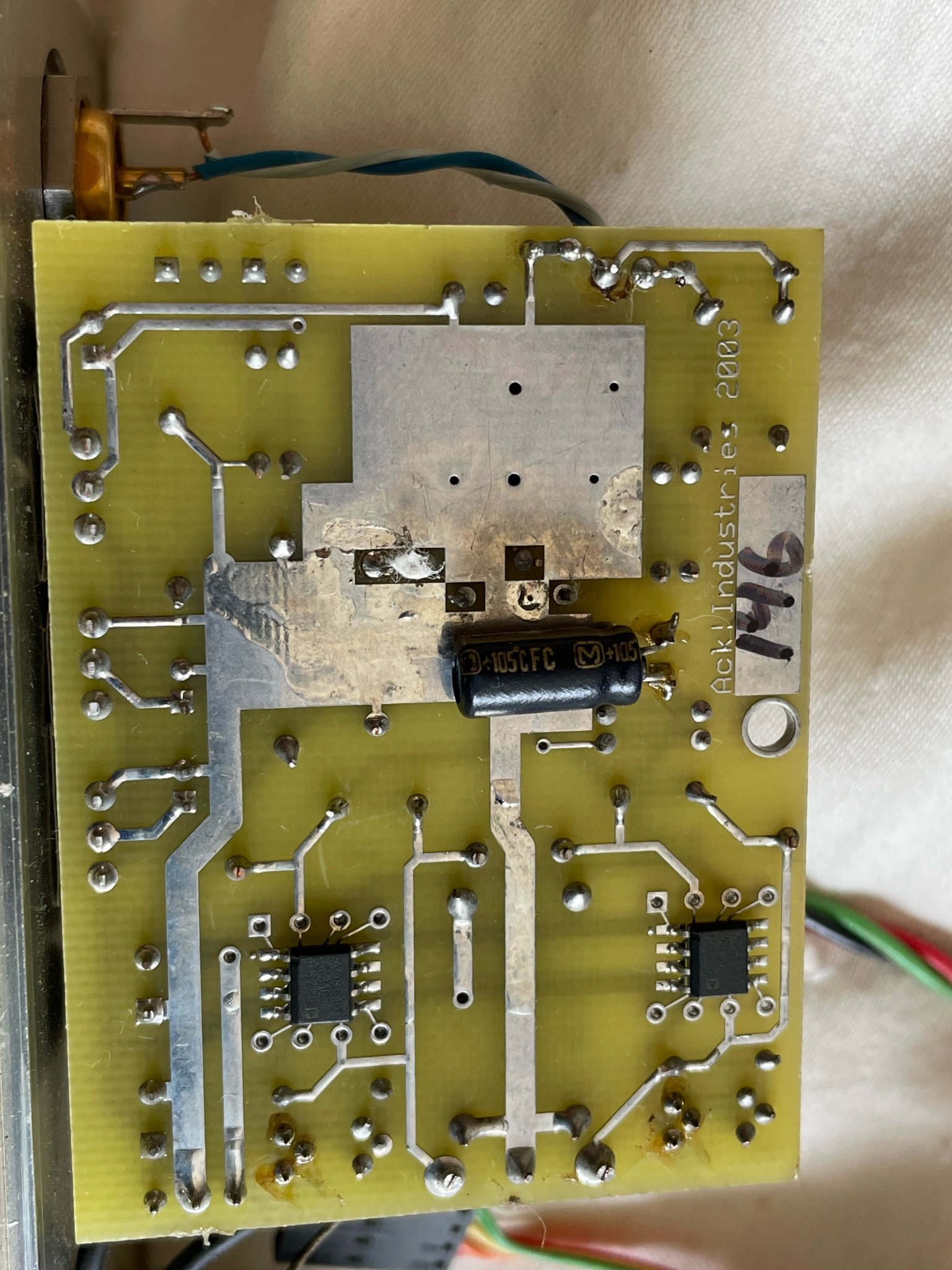

My old ack dack ,stopped locking to the coax source
I have had this since 2003 and have replaced batteries 3 times,I love this dac as it is easy to carry and test various systems,it also is very good on early edgy CDs
Where do I start to fix it, I do get some thumps when I switch it on and off
It's a kusunoki circuit,so maybe someone can fix it
Here are some pics,I can take some better ones in the morning with a camera ,
Hopefully they are ok
Thanks markw4

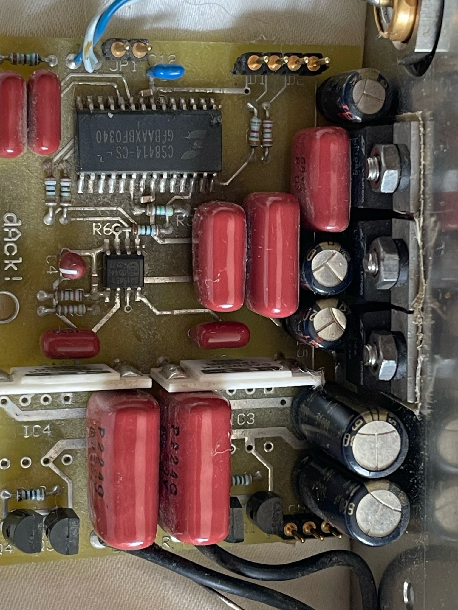

Looks like its probably a 2-layer board. If so, that tends to simplify things. Do you have any test equipment, say, a DVM and or an oscilloscope? If the latter, what is the bandwidth rating?
Also, before you take better pics, its okay to clean off dust and dirt off the chips, if necessary with a small amount isopropyl or denatured alcohol. Possibly may need to wipe with a cotton swab or something to make part numbers legible. If alcohol is used, air dry is maybe best if it doesn't take too long. A low temp, low speed hair dryer might be used to help if evaporation is too slow. Best to avoid high velocity air if possible, since it can cause static electricity.

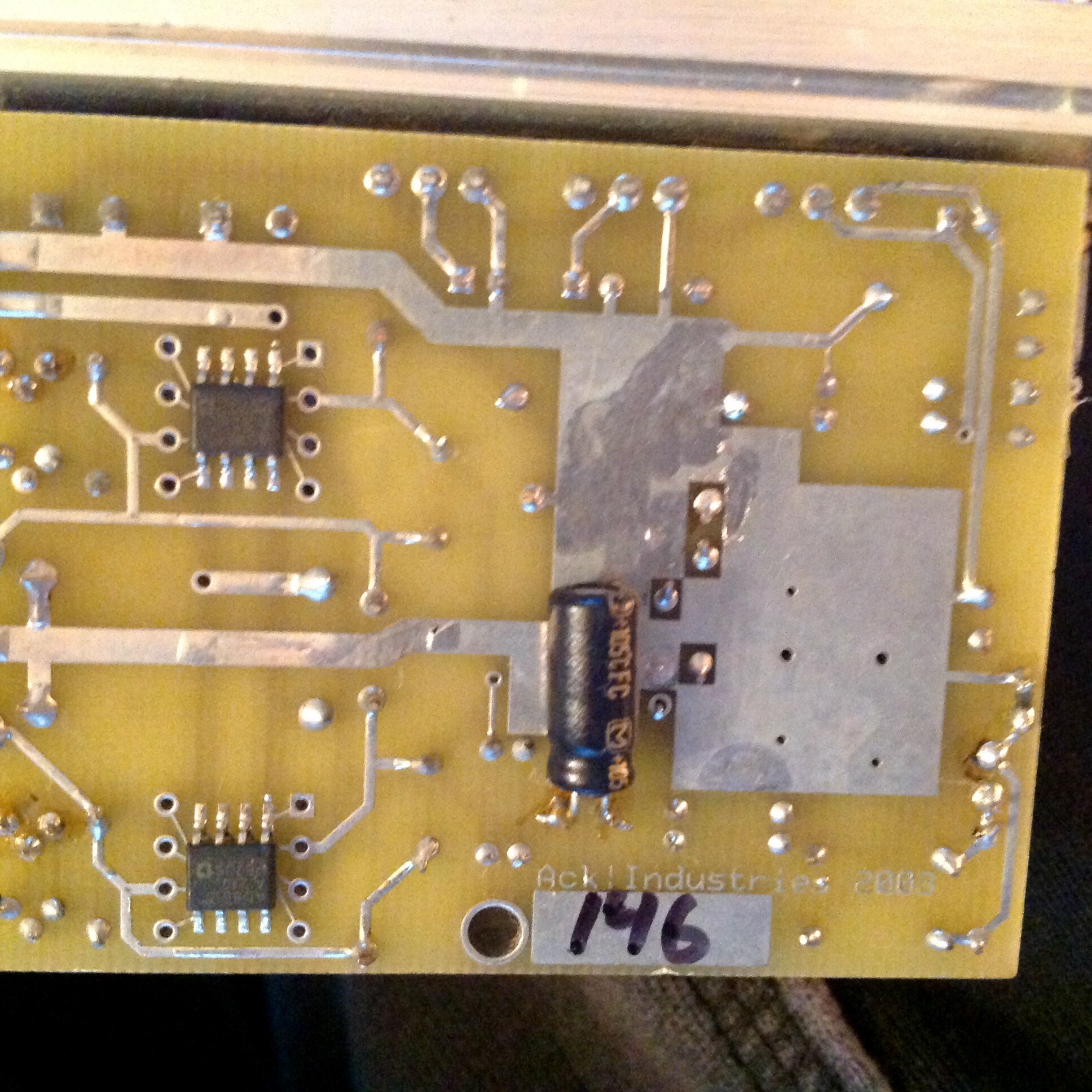

Hi I have a dvm,have a friend with a oscilloscope but no idea of the rating

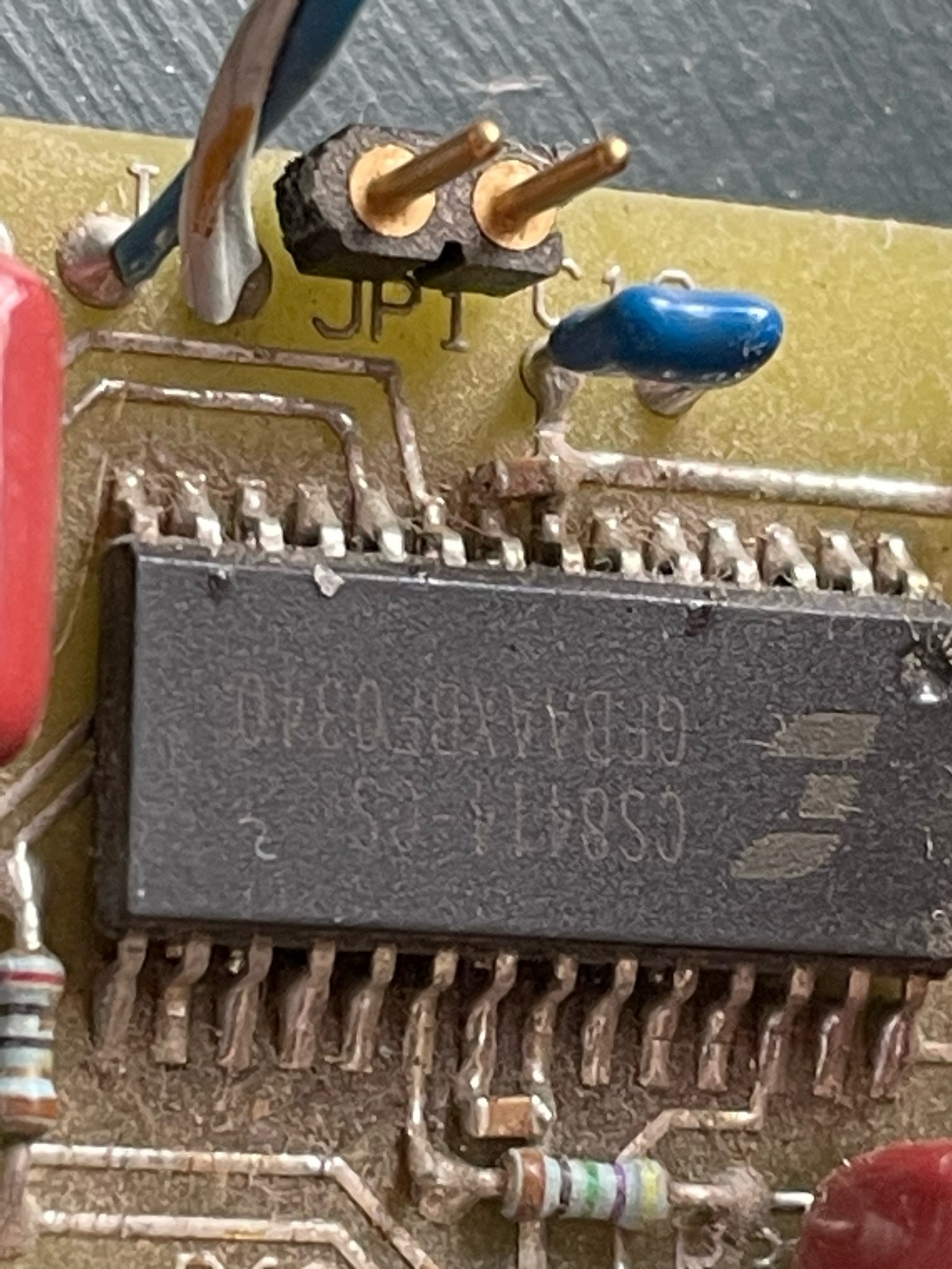

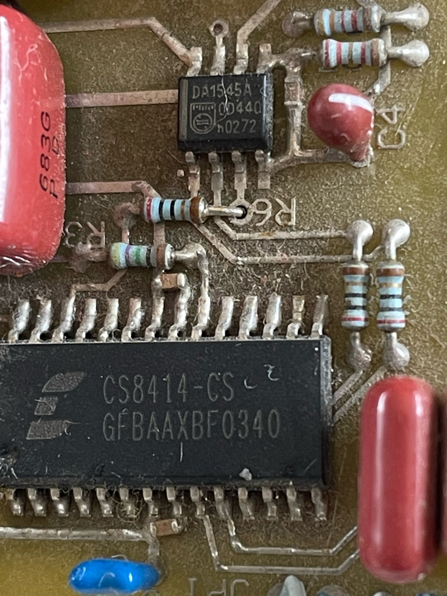

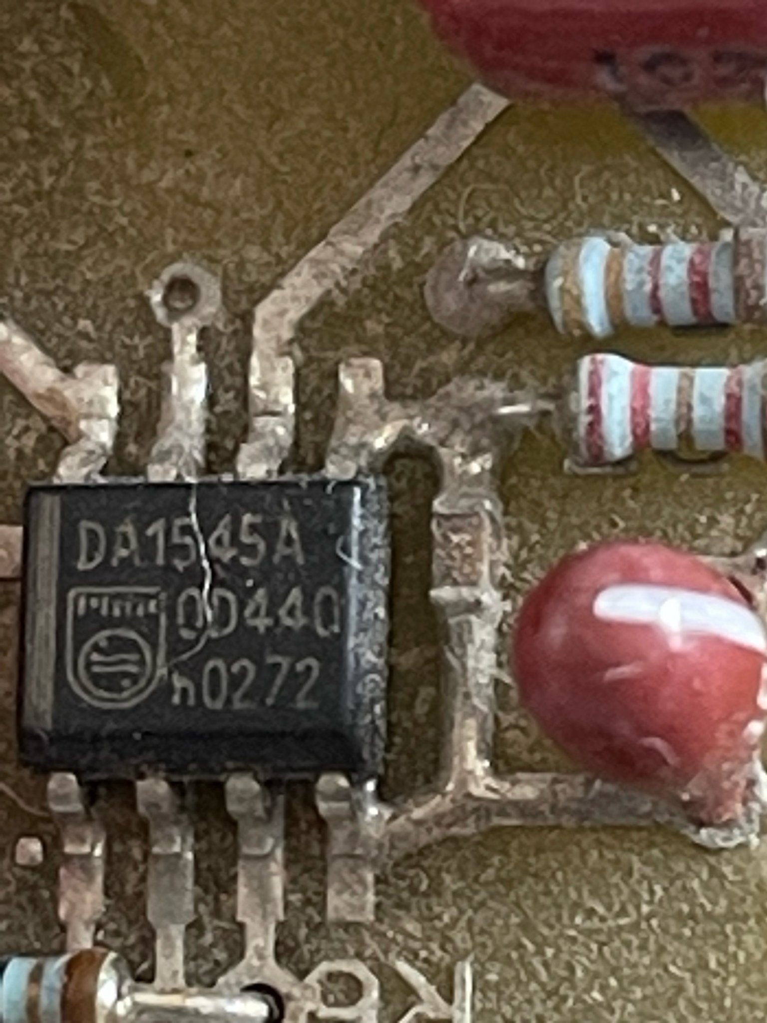

After cleaning with some denatured alcohol it's more clear now

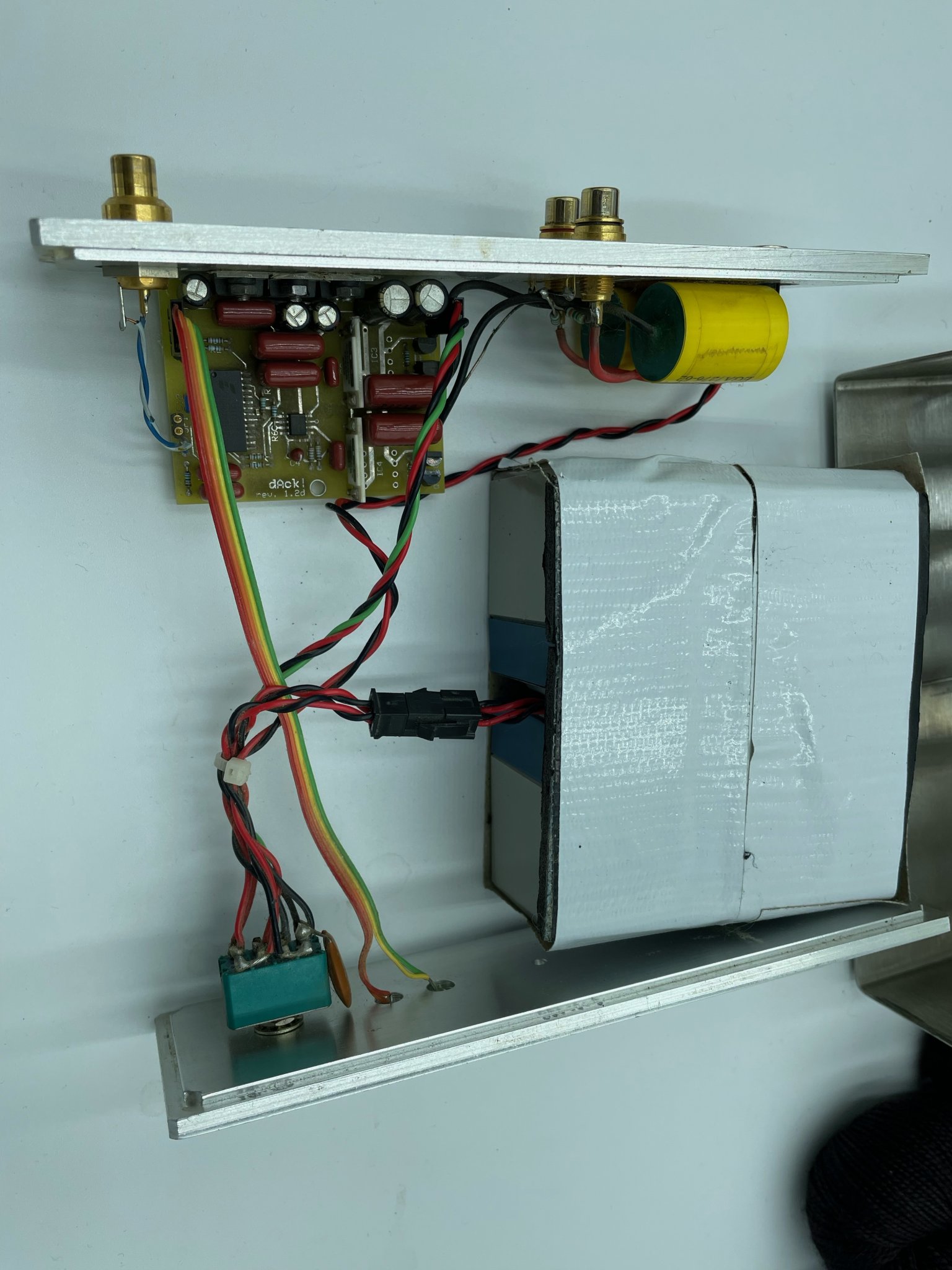

Is there a pic of he whole inside at once so we can get a idea of where all the close-ups are located relative to each other?

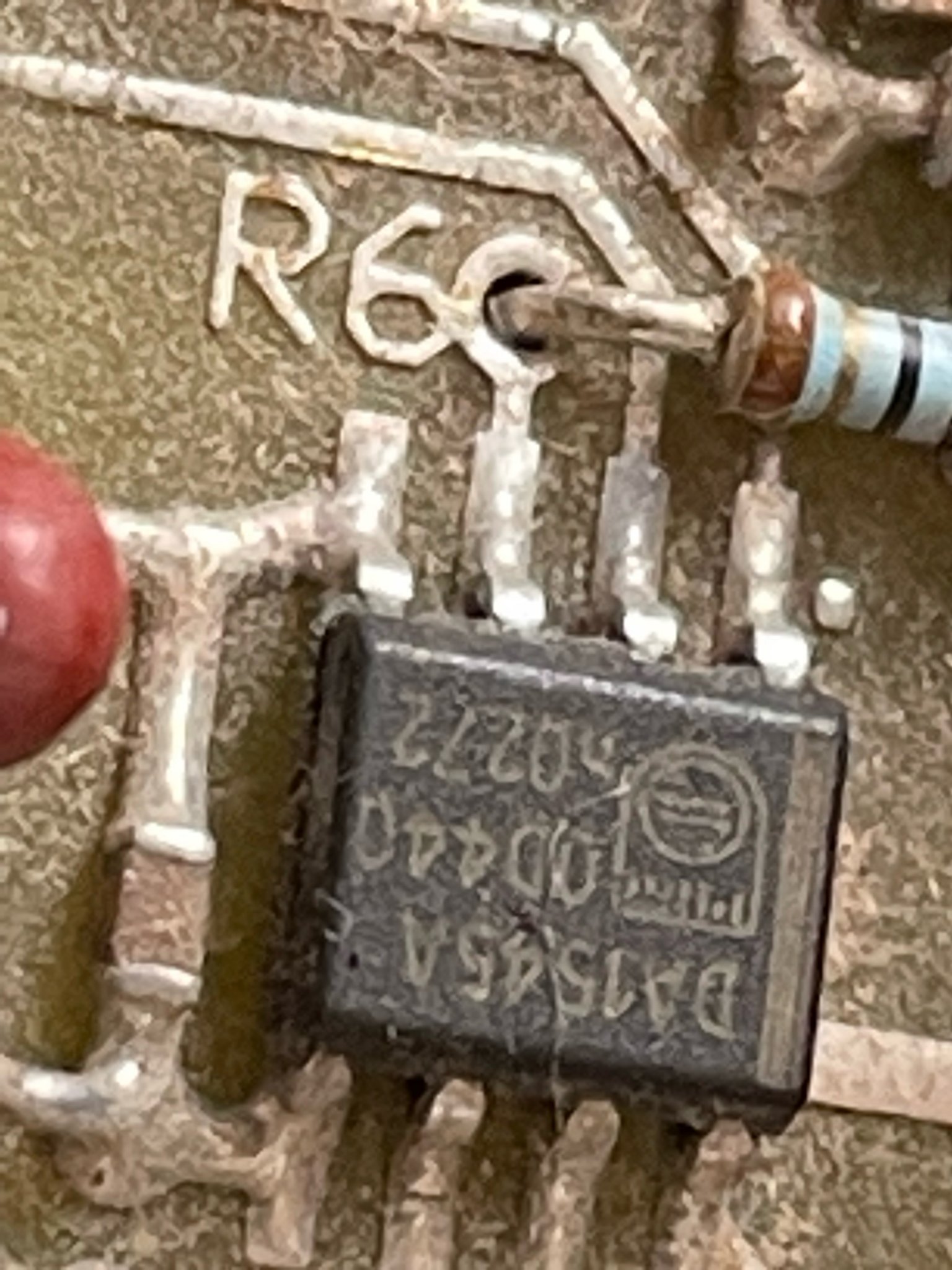

Kinda looks like the resistor R6 might not be soldered very well?
Probably a good idea to visually inspect all components, traces, solder joints, etc., for any signs of cracking or corrosion.
If visual inspection passes, then one of the other first things to do would be to check the power supply voltages. If you look up the data sheet for each chip based on the now legible part numbers, you can find out which pins are for power, signals, control, ground, etc. Might also make sense to check power with a scope too in case there is ripple or other problems that don't show up well on a DVM.
If we end up needing to do some signal tracing, how do you normally input digital data to this DAC? SPDIF, TOSLINK, USB, etc.?

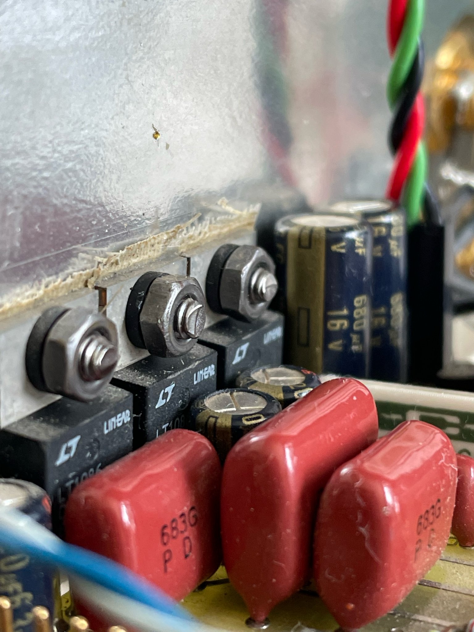

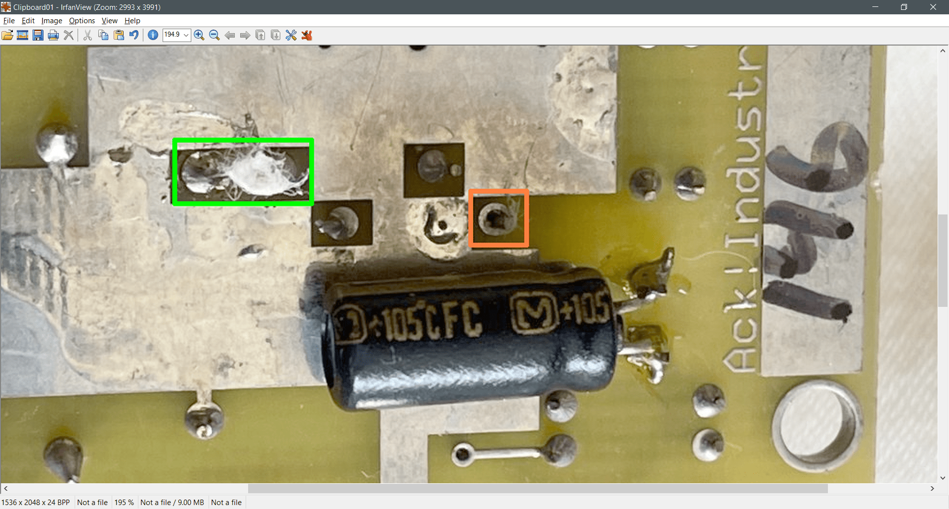

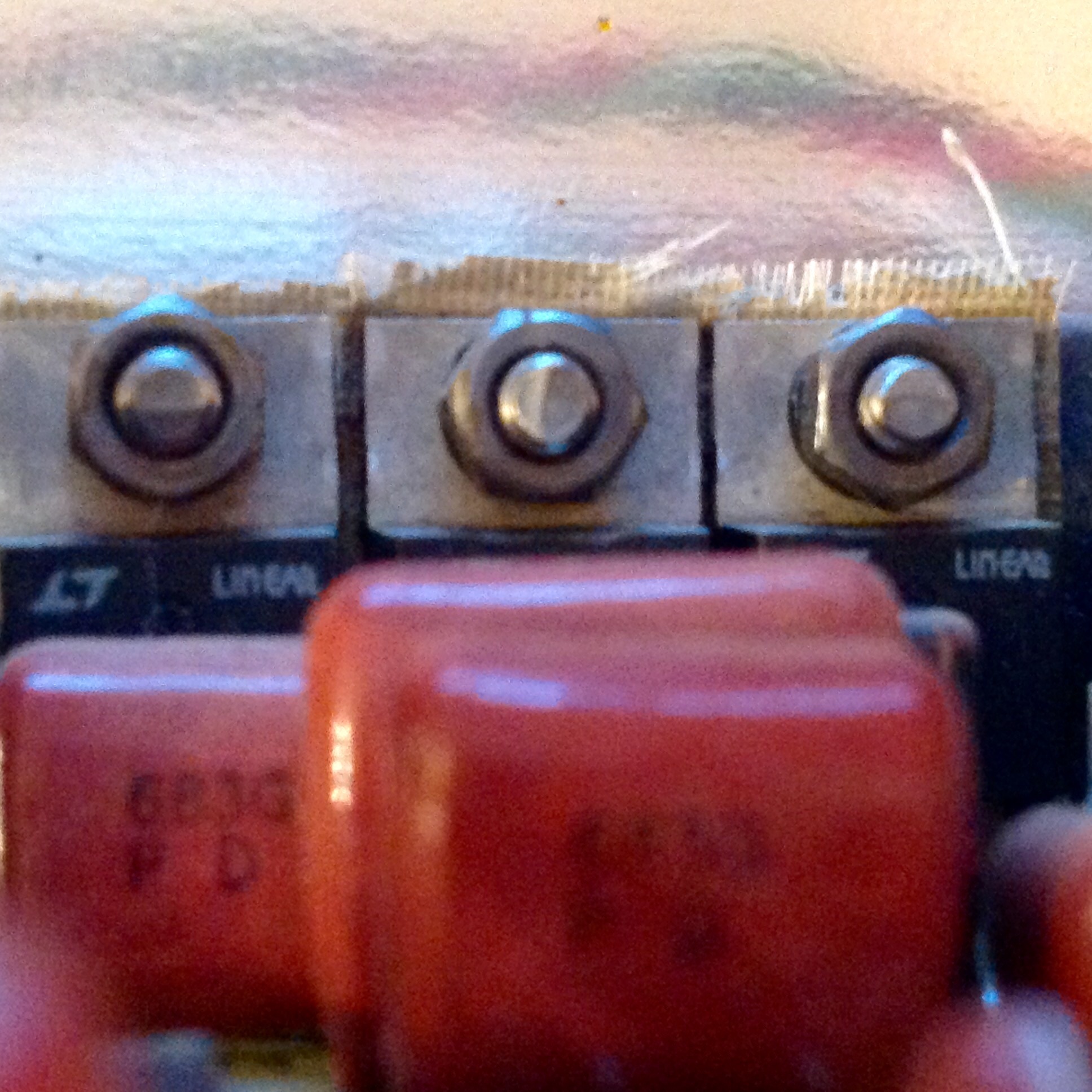

Some additional pictures

Good tips. Make sure to measure voltages first.

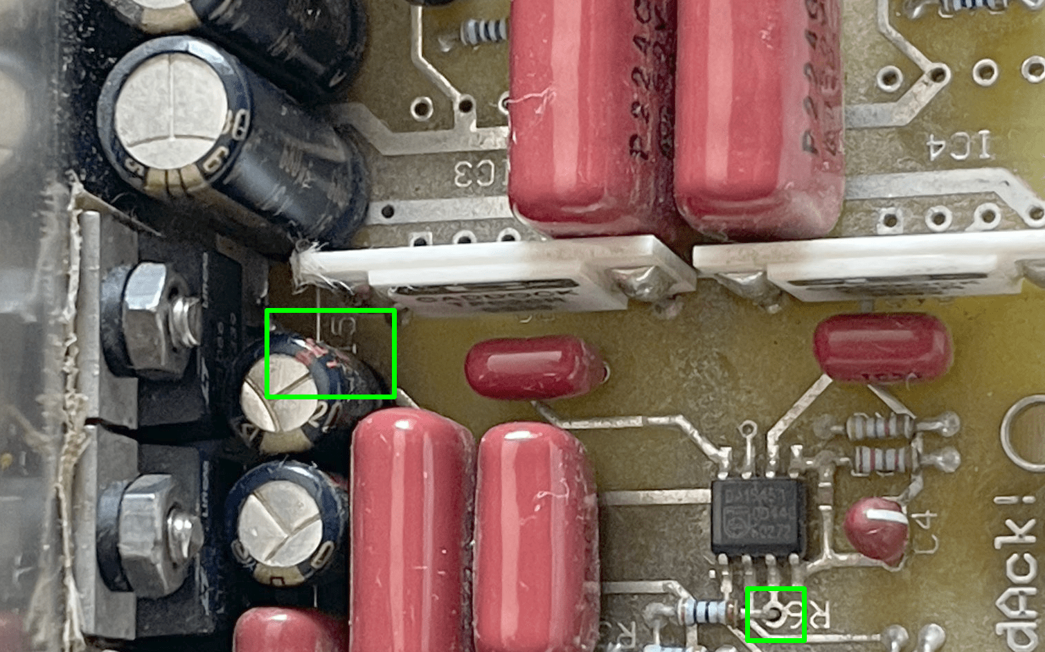

It would not surprise me if C4 would be kaputt. Drop type tantalums are famous for spectacular failures. Also the receiver CS8414 might have taken some ESD and possibly decided not to accept that. It happens.
There are some spots that look suspicious in the pics. For example the pin in the orange box below doesn't look soldered. The green box shows an area that is obscured by some cleaning material, so can't tell if what's underneath looks okay.
Next pic shows possible capacitor leakage and pin without visible solder:
Thanks jean paul had no idea that the tantalum is prone to failure,I will charge the battery overnight and start measuring,perhaps I am not getting full power from the battery pack,
Markw4 will solder those weak spots,although surprisingly it ran for almost 20 years with no issues
