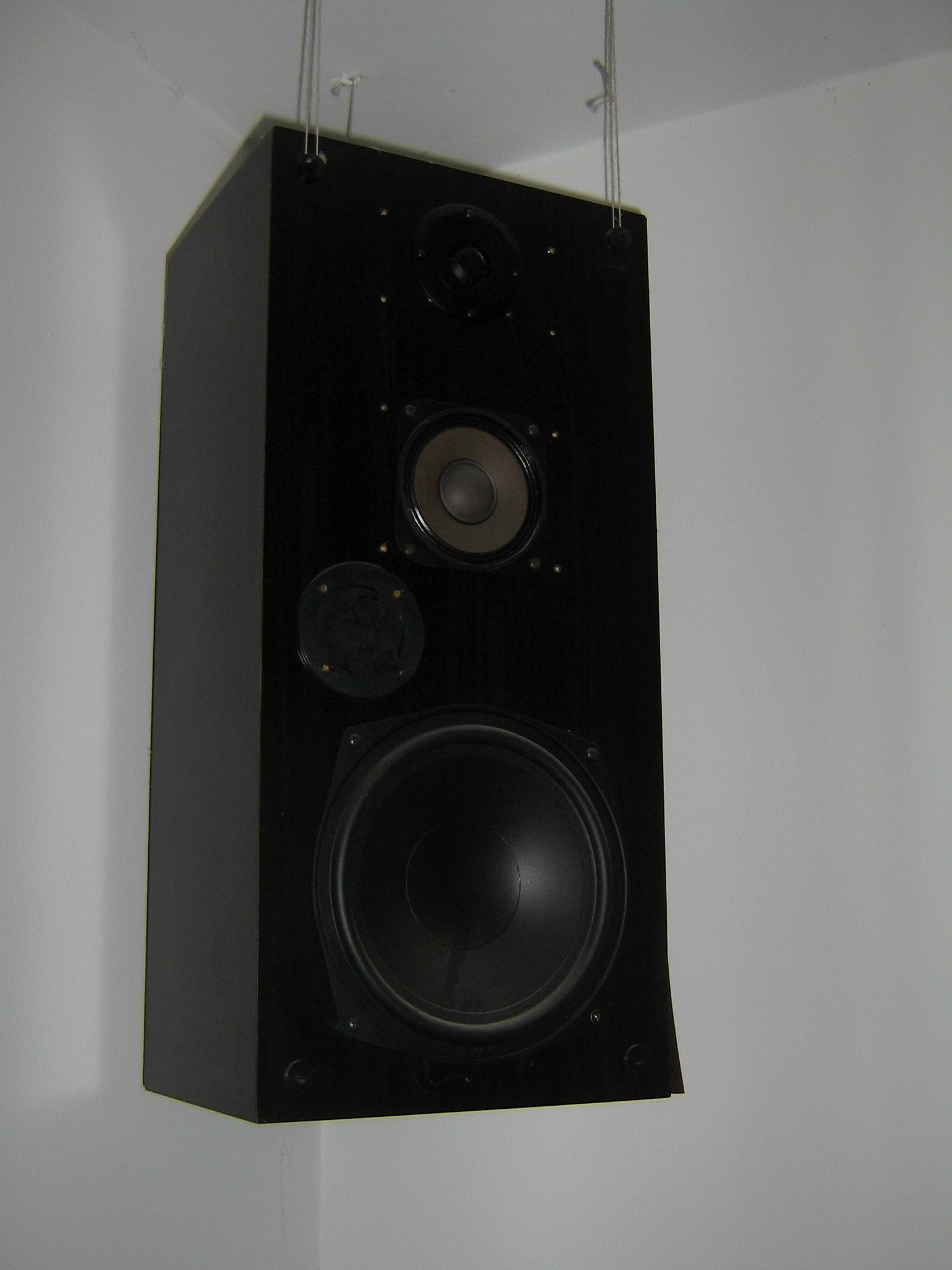

I would also note that based upon the provided picture our original poster has hung these speakers from the ceiling in a corner of a room. Could room nodes be having an effect here with our perceived "one note" bass response?

good idea wrankin. will do ASAP = after i buy new cables for that as the current one is in the wall. my father was obsessed with stereo so he did mount those speakers wide as possible.
me on the other hand listens also to mono so no problem when i put that box more near to the other.
will let you know after i buy new cable...
edit: i found one so i did put both speakers lower but on a cabinet. currently testing.

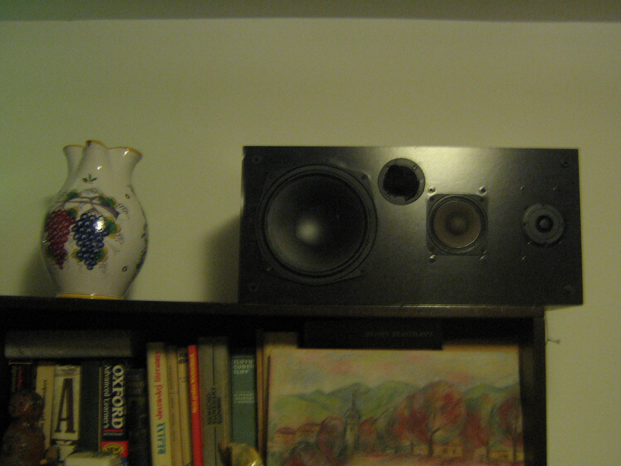

i did put that down now further from the ceiling but still on a cabinet (use that to enhance bass on ****** speakers).
tested now the sound with 2 tracks:
new + improved
traveling
1. it is better to have them further from ceiling
2. the bass is still more exact when i play it with the bass reflex holes closed. with open holes it plays loud but surpresess surrounding bass frequencies.
so probably i should work on sealing that cabins properly off.
new + improved
traveling
Or, rather than put a sock in it, you could convert the cabinet into a proper aperiodic enclosure:... so probably i should work on sealing that cabins properly off.

Having them hanging a few inches from the upper corner of a room isn't exactly a recipie for quality sound, and about the worst position it's possible to stuff a speaker into which isn't designed for 1/8 space loading.
coarse screenwire - yes i have some. do i fill only the tube or should also but the cloth inside the speaker?Or, rather than put a sock in it, you could convert the cabinet into a proper aperiodic enclosure:
Aperiodic Enclosures - Great Sound Stereo Speaker Manual
There's some surgery required!
Remove the tube. Enlarge the hole which is left to the correct area to suit the volume of the enclosure (10 square inches per cubic foot).
Staple the screenwire over the interior of the hole, compress a couple of layers of fibreglass into the hole, then cover it over at the front with more screenwire.
Read the link carefully for the full instructions.
As useful as this may be, I'd point out that aperiodic is not an intermediate measure between closed and vented.
Aperiodic is more akin to sealed than ported.
Anyhoo... If he don't like it he can seal up the hole! 😉

At any rate, trying Aperiodic is probably one of the easier solutions. And especially so, since very low manufacturing cost vented speakers commonly use somewhat underwhelming magnet strength on the drivers so the qts is often higher than recommended values for bass reflex or most easily simplified TL variants, it is a fire-sure recipe for boomy one-note bass. Aperiodic, sealed or dipole is better for such drivers.

Hi e3k, the speaker is not in optimal position and orientation so it will sound bass heavy if you listen seated. Proper speaker and listening position might be enough to make that bass reflex feature usefull. If thats the position you want to keep the speakers, I believe you are correct, too much bass and you should block the port. Your ears will tell if balance between highs and lows is too much off. Have fun! 🙂
