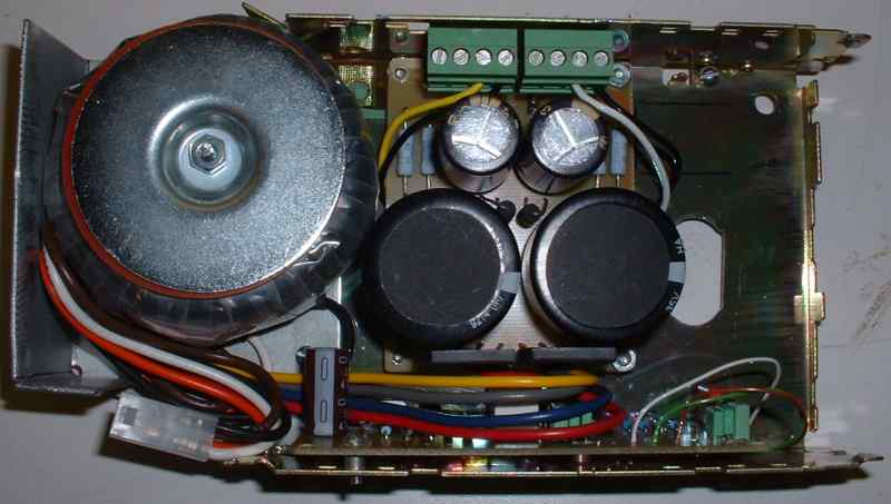

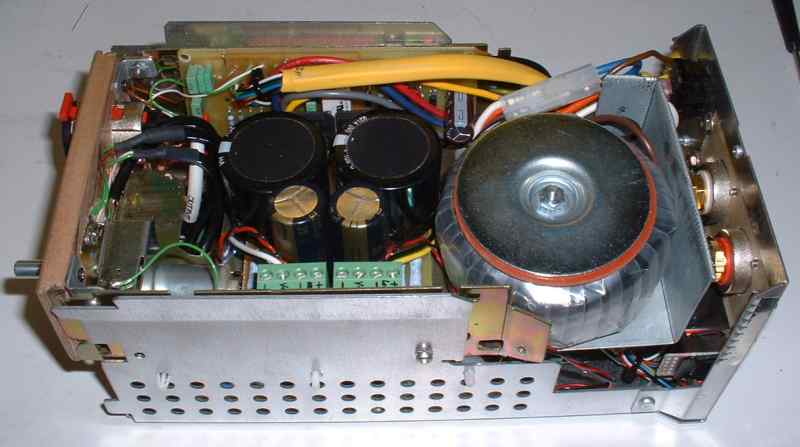

Hi All,
I've had a few emails, so I figure that I'd add a little more.
The attached pic shows how I laid out components and the boards within the Par-Metal chassis. I don't have any numbers on the heatsinks since I got them at a local surplus house (which has a lot more if you are in the Bay Area, CA at all), in untouched form. I measured the temps yesterday and they run at about 105 degrees F (heatsink temp, not junction or case temp) without the case lid on. This doesn't seem too excessive, so I presume they are adequately heatsinked. I am currently running the bias current at its max: about 255mA.

Very nice layout, Bryan🙂 The heatsinks looks like CPU heatsinks😉 Some Athlon or P4 sinks!
Steen😎
Steen😎
I'm not sure what they are, but I'm guessing they are not CPU heatsinks. My Athlon 64 sink is about 1/3 the weight, and I can't imagine P4s put out that much more heat. Anyway, they are beautiful. Not a scratch on them. And best of all, they fit (barely).

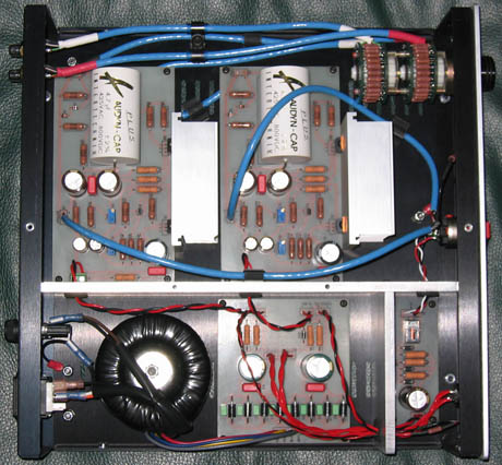

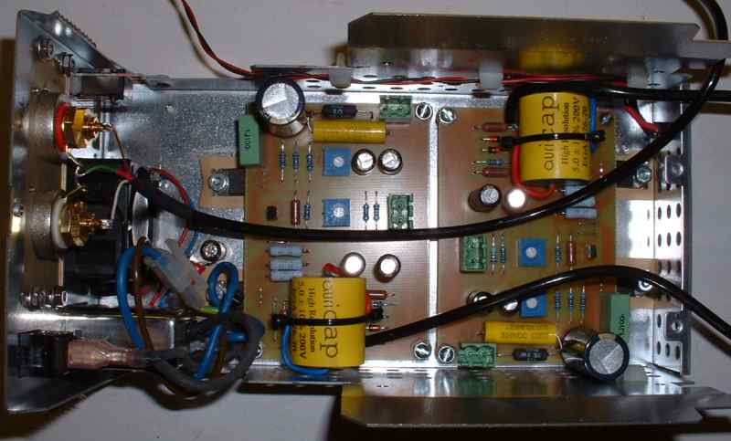

My amp is completed. As described before it is done with two main assemblies. The bottom section contains the case main frame, the two amp PCB's , the AC EMI filter and power switch + Blue led, the rear panel and the rear equalizer DIP SW.
Here an image of the bottom section.
On top of that is the power supply assembly. It contains the transformer, supply and equalizer PCB's. A steel plate insulate the transfo from the input RCA connectors. There is no induce 60Hz noise in the amp from the transfo. All audio signal cables are also shielded.
I mounted the amp pcb on the bottom because I wanted to mount the two power FET's on the case bottom plate for maximum heat transfer.
The wiring is done in such a way that I can rotate the top section and have access to the bottom map PCB and do testing and adjustements on them.
And finally a view of the rear panel with two nice Neutrik RCA Connectors abd the remote DIP SW of the sound equalizer easily accesible from the back.
The fan is still mounted on the case. I may use it because the amp is getting quite hot on the bottom. If I connect the fan, I`ll make sure it will run at minimum speed. I won't hear it with headphones anyway...

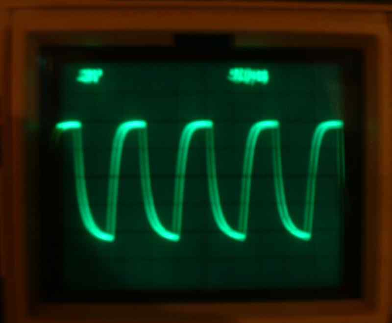

Here a bad image of a 10Khz square wave showing the typical ZEN response. Since the amp bandwidth is only 20Khz (-3dB), a lot of the 10Khz square waves harmonics are already attenuated and cause the waveform round corner. The sound is still very good indeed, so why bother with a square wave not perfect 😉

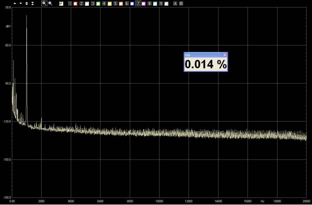

I finally manage to get a CLIO measuring system in my workshop. Using that I was able to do better measurements of my ZEN amp.
At normal listening level: Vout = 20mv at 1K in 33 ohms resistor
Harmonic (THD) and Intermodulation (IMD) distorsions are:

Hello Algar,
0.3% @ 20mVrms @ 1KHz is definitely too much, maybe your D.A. is a bit noisy or its noise floor is such that this limits the dynamic with such low levels.
At 50mVrms (the lowest level for my HP8903B to work as distortion analyzer) I read 0.05% THD+N, 400HP and 30KHz LP filters on.
With my Clio, when the 20mVrms output level is setted, the THD percentage is about 0.014%, but I can see the only 2nd harmonic over than 80dB below.
Anyway, the differences does not seem so dramatic to me.
Best regards

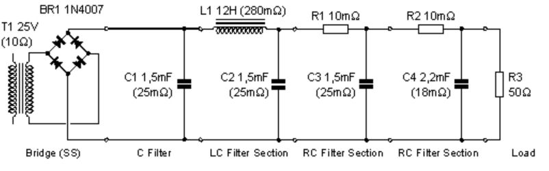

Power consumption
Hi Phoneamp experts,
I am now building up the powersupply for my Tortello / Digi headphone amp, and I would like to know your etimate as to how much watt the amp will consume when biasing on 200 mA.
I intend to built the following PSU: See attached picture.
The values for R1 an R2 depend of course on the load of the amp.
This setup would give a ripple of appr. 0,000025 Volt
Thanks for any info!
Lucas
